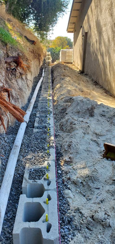

Wall is looking good! I used the exact same type of block for ~20' long retaining walls on the east and west sides of my earth-bermed house. Mine are holding strong after 5 years now. I didn't have to go quite as high as you, though.
My only real concern is that you decided to keep the faces flush/straight, instead of using the rear pin locations for some set-back on each course. Mostly an aesthetic consideration, sure, but staggering them back as you go up should increase strength, better resist toppling over, and at least hide the visual impact if it does start to push out a little bit over time.
These are valid points. Strength could have been improved by pulling the wall 3.5 feet forward and building up the backfill with grid and then further by offsetting the blocks.
Having said that the one big factor coming into play is the collection of huge ficus trees and their roots that are already retaining the hillside. That could also become a liability down the road if those roots overtake the wall.

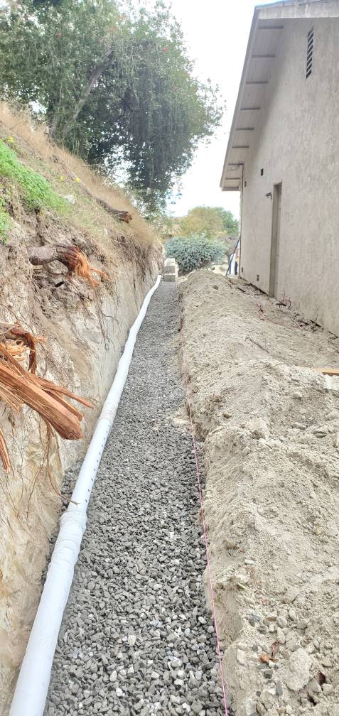

Nice looking project.
I am wondering how the top will be finished. Gravel on the inside of the wall all the way to the top and covered with fabric? Then topsoil over the surface of the fabric? Or something different?
I get a backache just looking at it. Keep it up.
Yes that's the plan. We're going five courses up so at the fifth we'll cover the gravel with barrier fabric and then 8 inches of dirt and an 8 inch cap on the wall.
