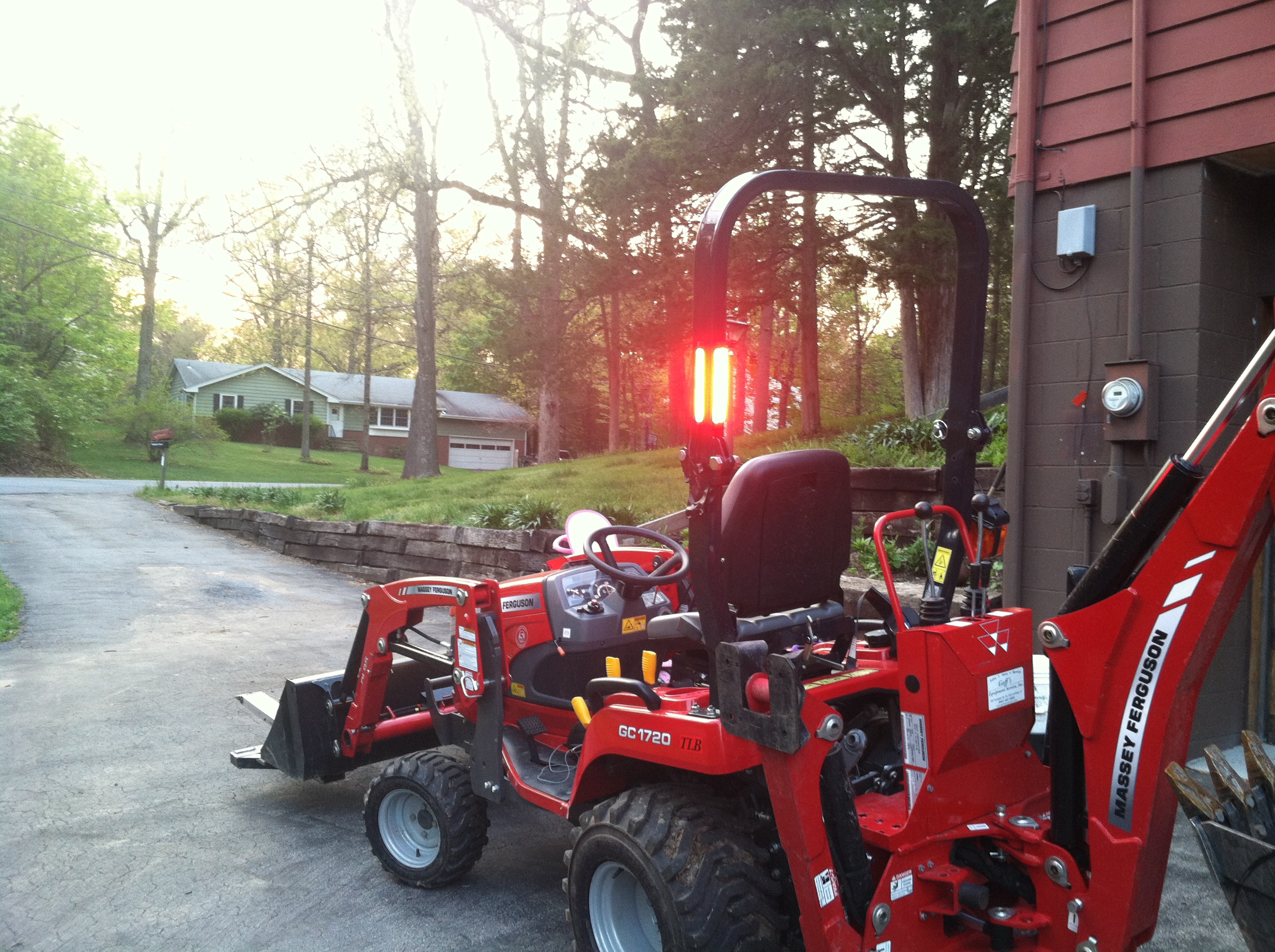

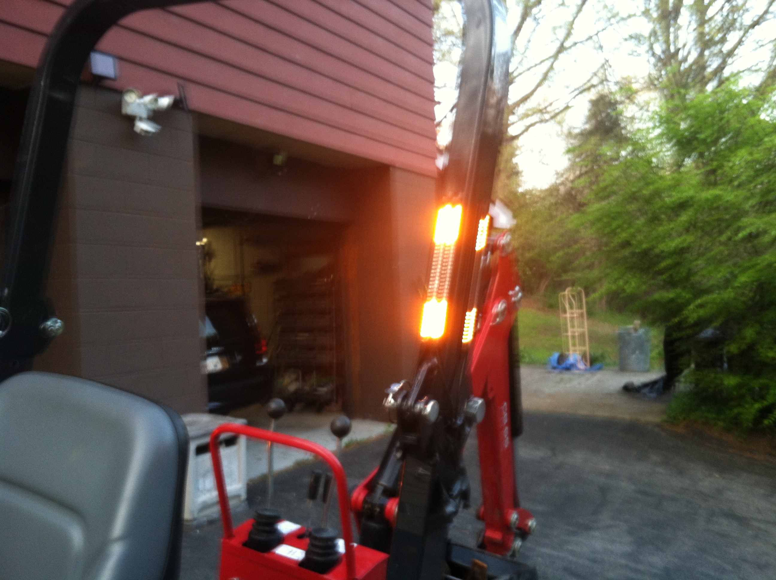

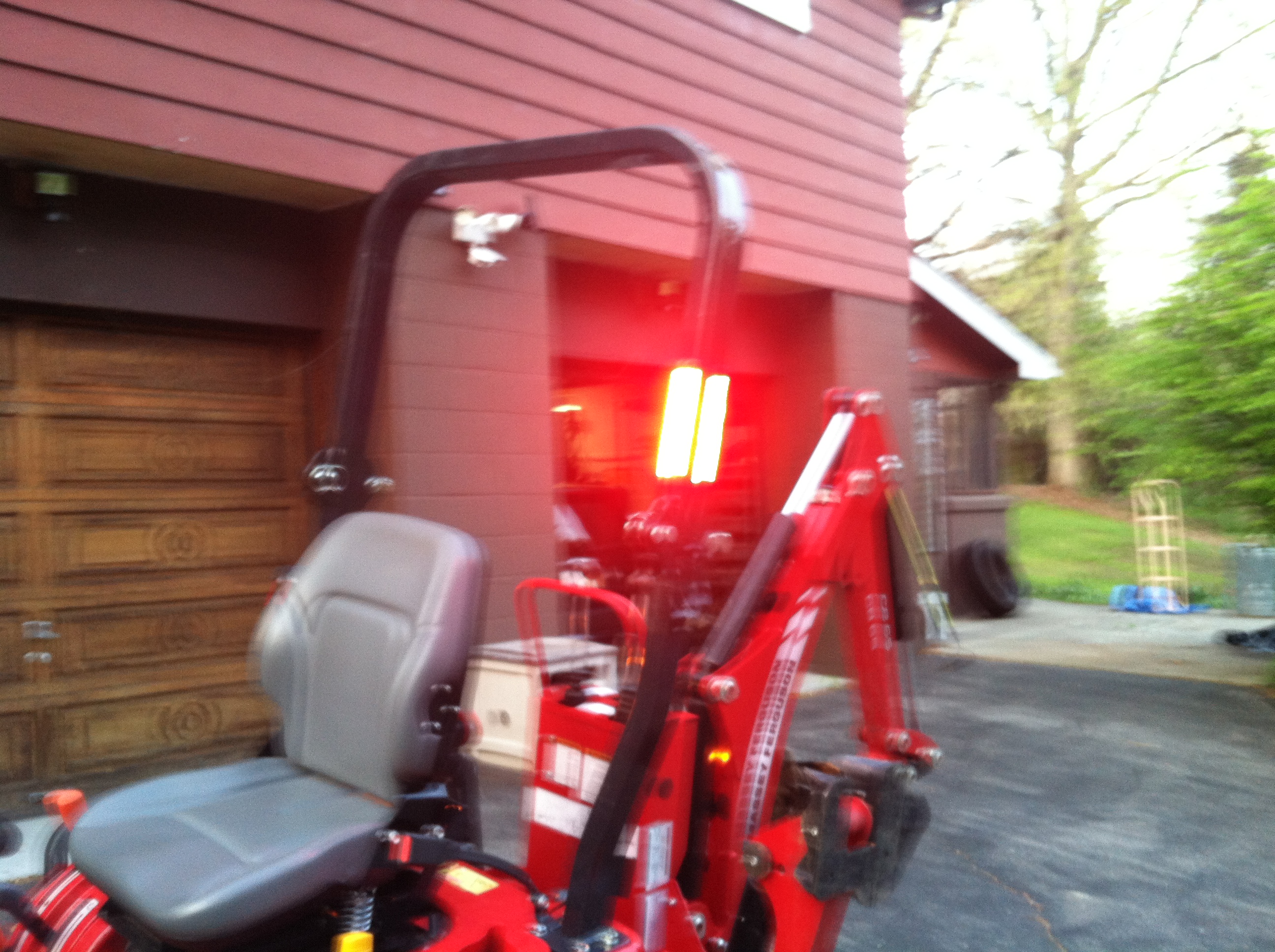

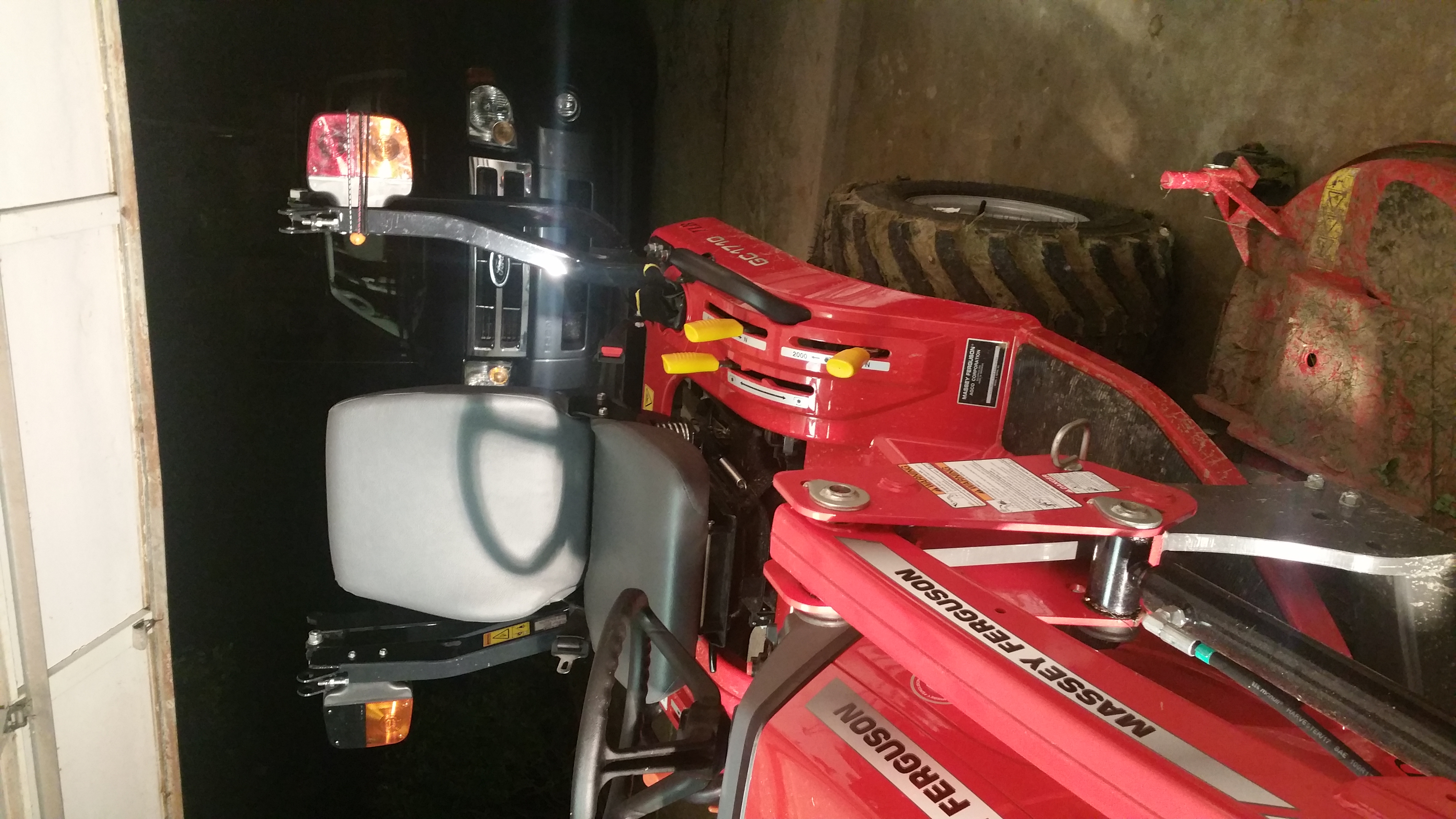

Sorry for the blurry pic. The cell camera didnt want to stay focused with the leds lights. Ill take soke better pictures when im all dome with both sides. Im happy with the brighness so i order the other side. All together i will spend 40 bucks. A total 10 leds strips. 5 per side, I put 2 in the back, 2 in the front and one on the side. Way better then stock!

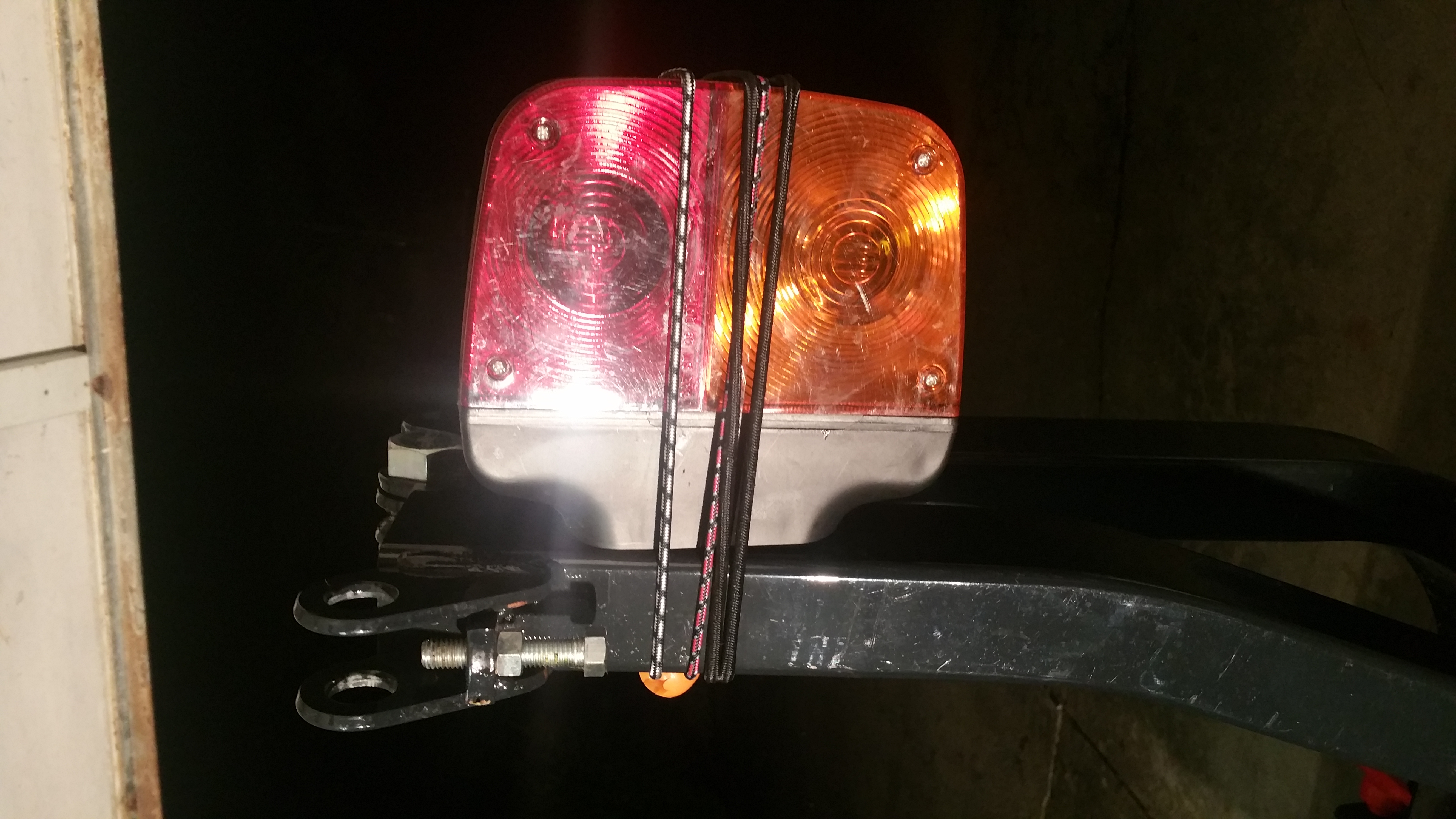

Here is on my first twenty hours on a gc 1710. Some minor brush broke it right off. Nothing a little glue won't fix but for now just have some bungy cords holding it on in case I run into some brush again. But I must say other than that love the tractor.

Looks great and nice and bright. May have to borrow that idea. Thanks.

Axle did you see the led lights i put on?

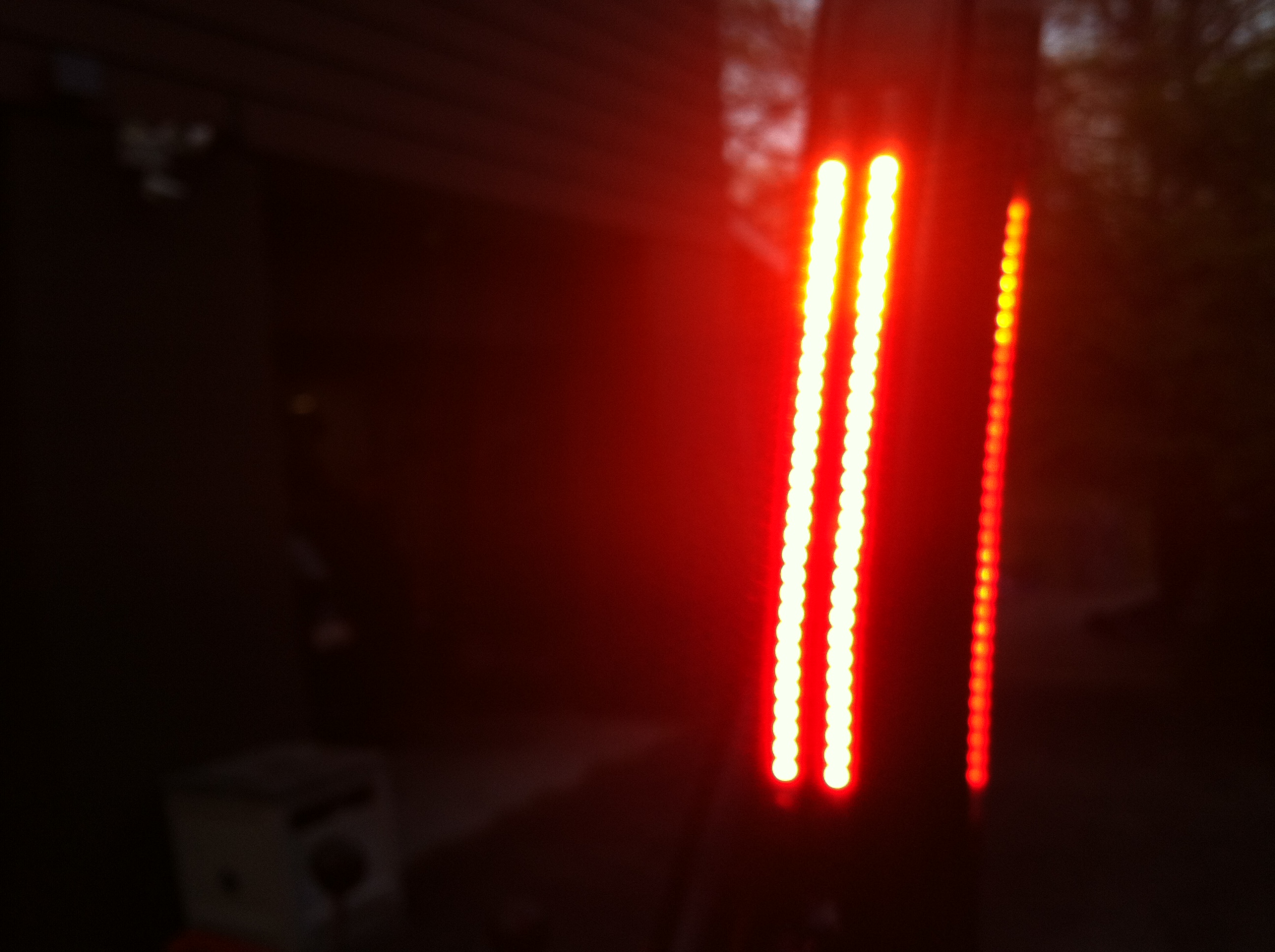

Picture pf just the led rear lights.

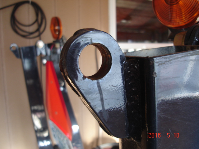

I have found no use for the two bolts on the front of the rops, anyone know what they do?
   / Replacing Gc1700 series rear lights #50
Do you mean the bolt that sits "upright" with a jam nut on it?
I believe that's used to fine-tune the position of the ROPS when it's in its raised position so the pins that lock everything together fit without fiddling around with them (while holding the ROPS up with one hand :eek:); i.e., so the holes line up. The end of the bolt bears on the "ring" piece (first pic) that goes in between the two stationary holes as the ROPS is raised into position.
I suppose it could also be used to apply tension to the ROPS after it's raised, to prevent rattling…?
