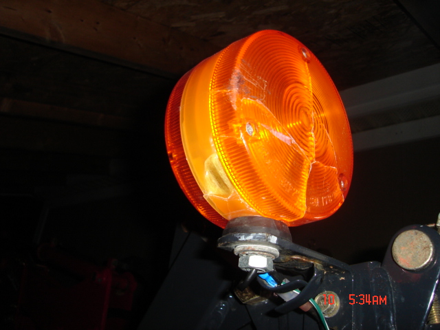

I too have "clipped" my lights on tree limbs. I agree that the placement is odd. Meaning out of normal view of the operator. I was able to use some super glue and repair my light assembly. I felt really stupid for hitting the light, but after see this post, I see I am not the only one.
   / Replacing Gc1700 series rear lights #28
LOL! There's more epoxy than original plastic in my assemblies and we've not even reached the 250 hour service mark. :D
Sent from my iPhone 2.0 using TractorByNet
   / Replacing Gc1700 series rear lights #29
Great minds think alike-- I must have super-glued (that stuff really works on those plastic lenses!) and epoxied housings 5 times on the originals, then once or twice on the Kubota replacements before I finally decided to spend the time to make the clamps so I could move them to the inside. Definitely one of my better decisions.
