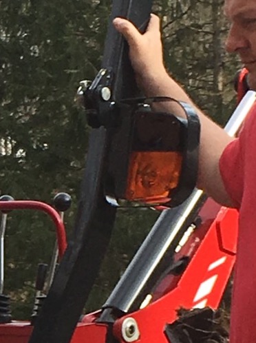

Well these lights love to keep getting snagged up on my trees around my property and id like to improve on this. Any aftermarket or has anyone else done anything creative? They are like big dumbo ears flapping in the wind.

I Was speaking about the actual turn signals and brake lights as they stick out wayntoo much when your in the bush. I was thinking of getting like a mini led bar to replace the standard ones.

Rookie mistakes pretty much. The armor is their but it sucks as it doesn not go cover up the lit from all directions and the inside plastic is junk and not very stong. When im backing up or moving forward ill get them hung up on branches left to right ir even small trees standing. I was hoping to get something that is flat and sticks right to the rops or protrudes only a lil bit. maybe even something magnetic so i can move it or if.need bee fall off if hit.

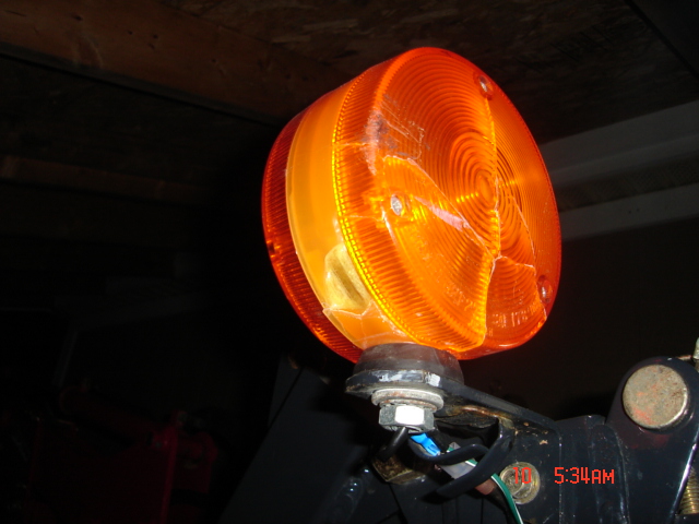

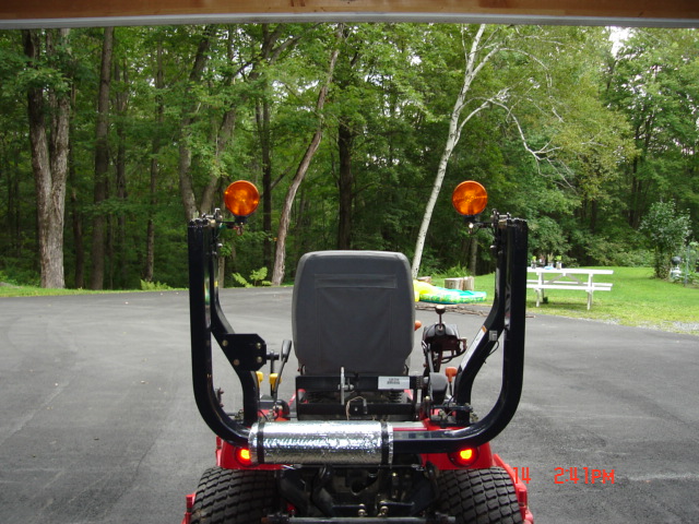

Lights area bit different on the newer ones, but I found that Kubota lights made for a much less expensive replacement for my OEM Massey ROPS lights.
I also had trouble nicking the darned things (and got tired of repairing/replacing them), so made some clamps to mount them on the inside of the ROPS. It doesn't hinder me when using backhoe, and I haven't had one issue with the lights ever since.:cool2:
I think a lot of the problem is that the lights are situated where you're NOT looking while using the tractor; that is, up and a bit behind the operator. Yes, maybe a "newbie" issue, but I bet I'd still be hitting them if I hadn't moved them!
Here's a bit of "after & before", also showing the Kubota light:

Irving,
Your "before " picture is a considerably different light than what is on the gc1700 series. It appears the gc2300 series tail lights were different.
/ Replacing Gc1700 series rear lights #20
I had no idea the TLB ROPS was so much wider than mine. Yours widens at your hinge but mine rises straight to the top.
