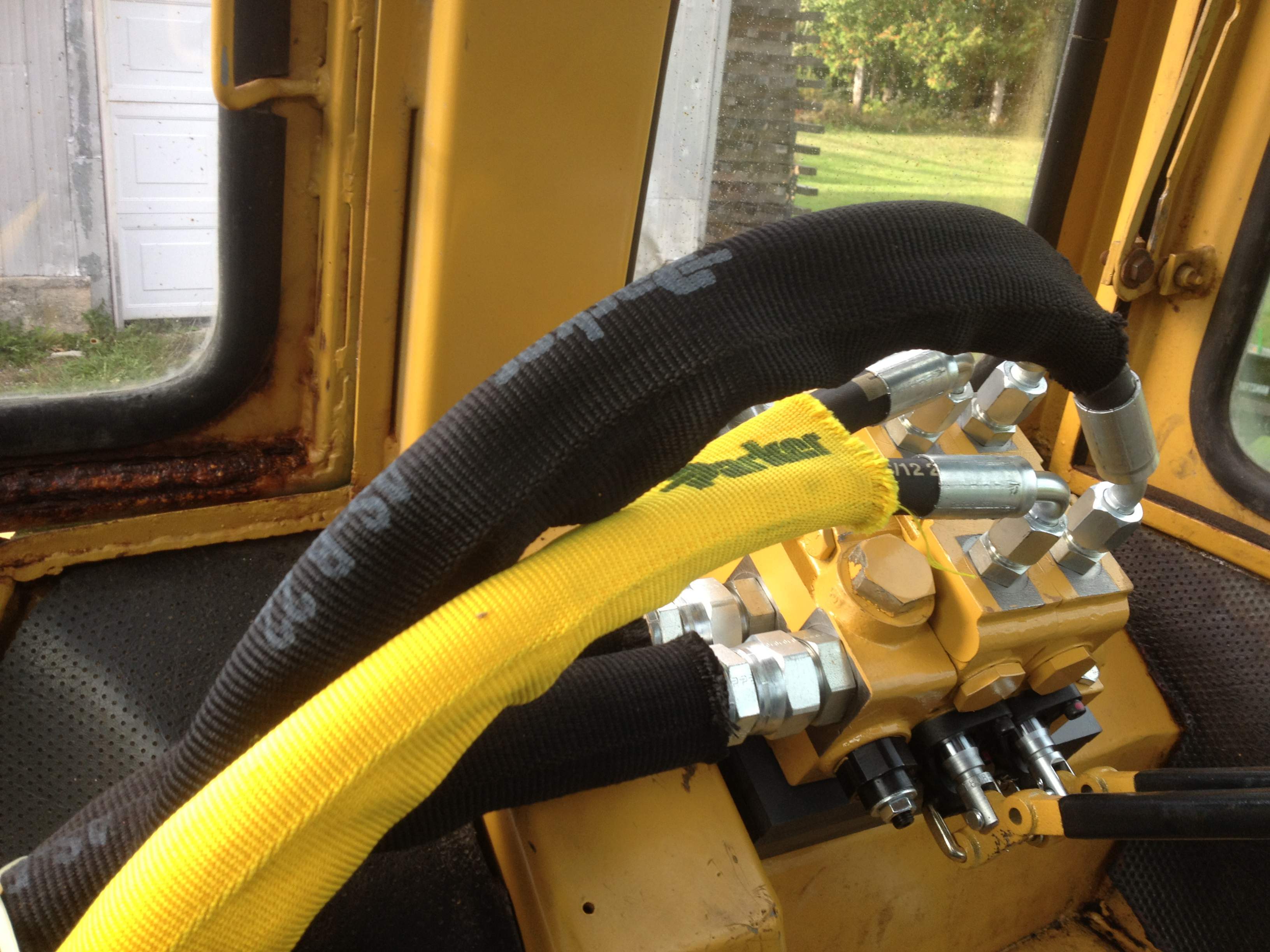

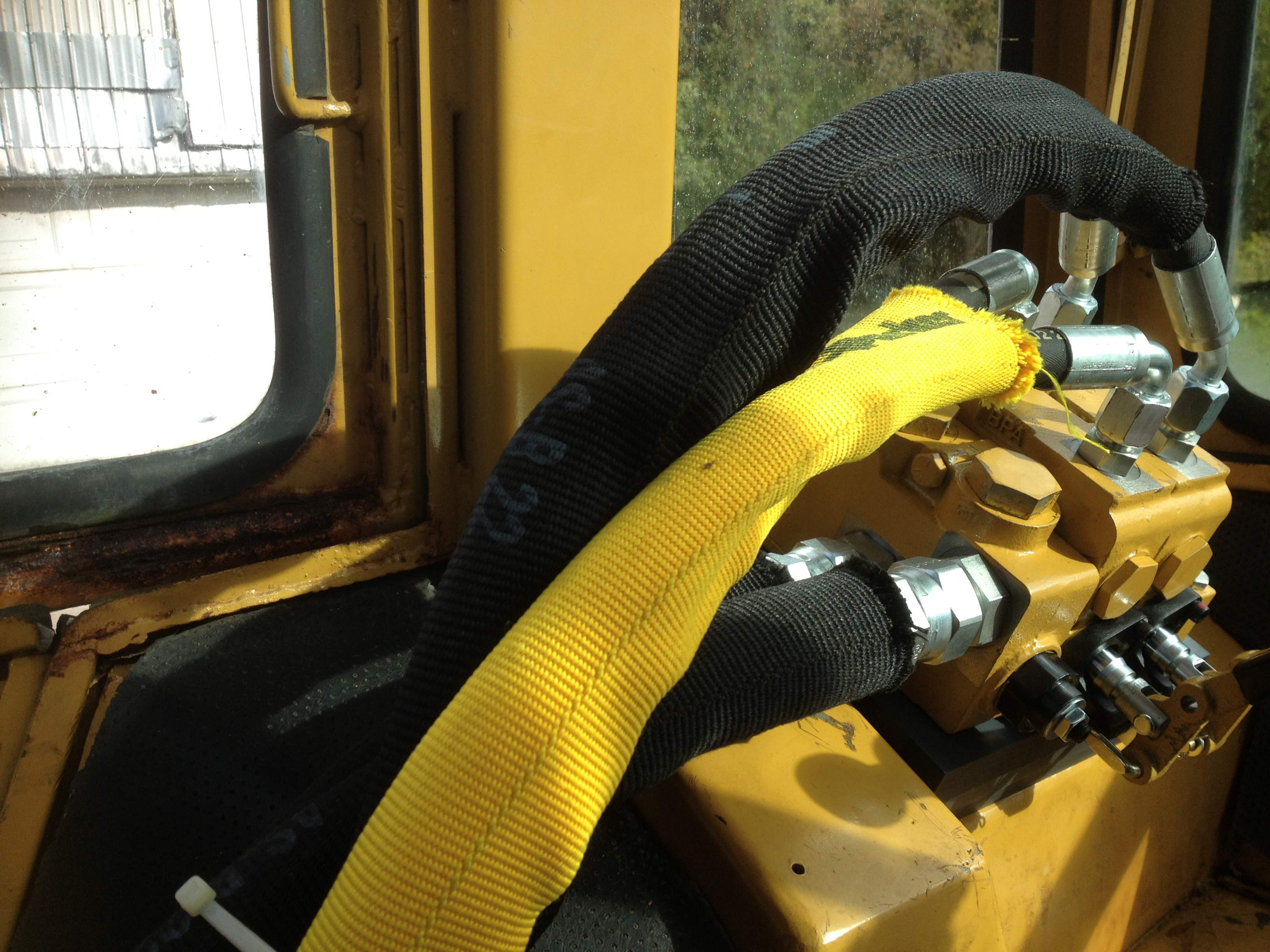

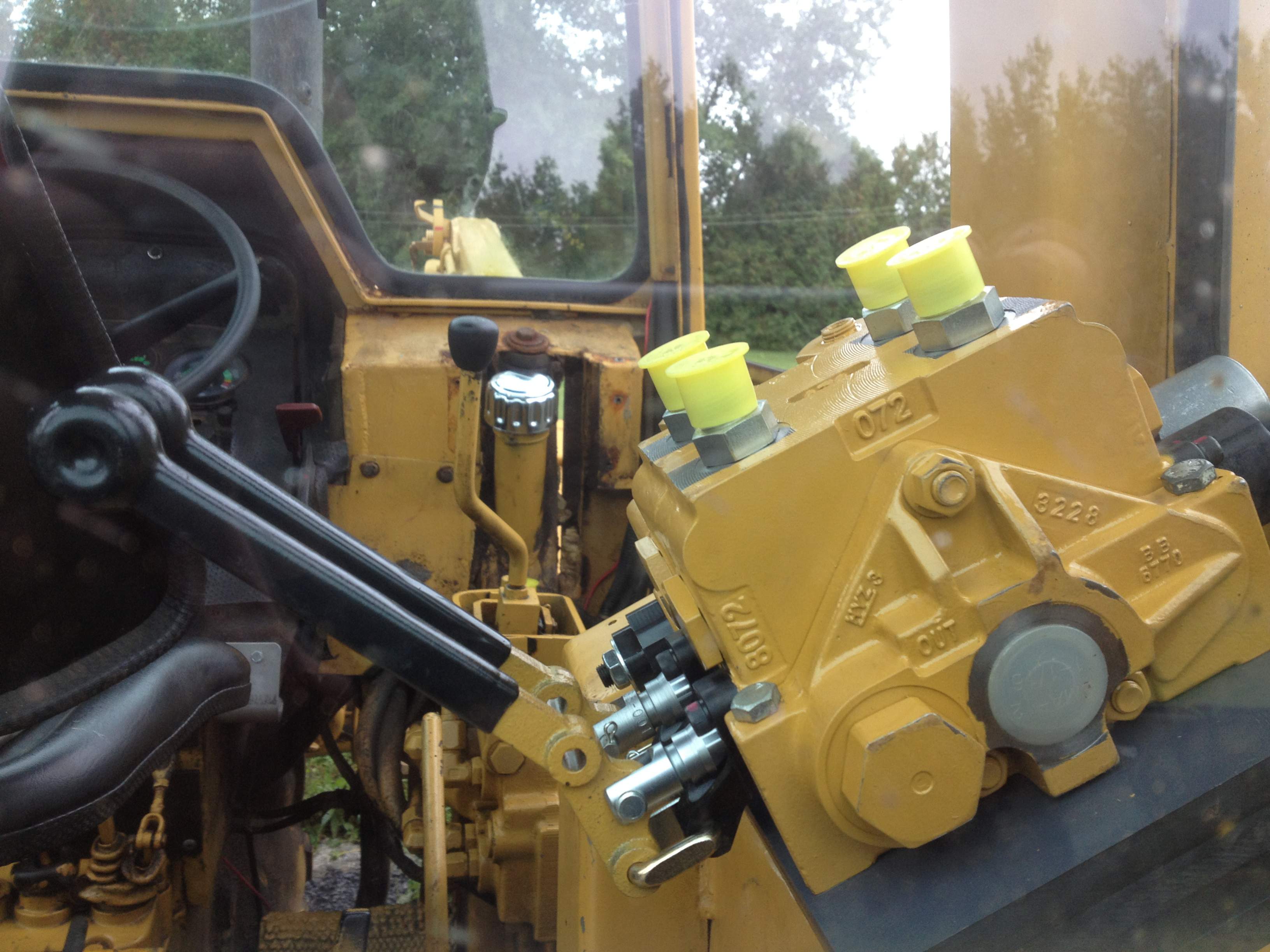

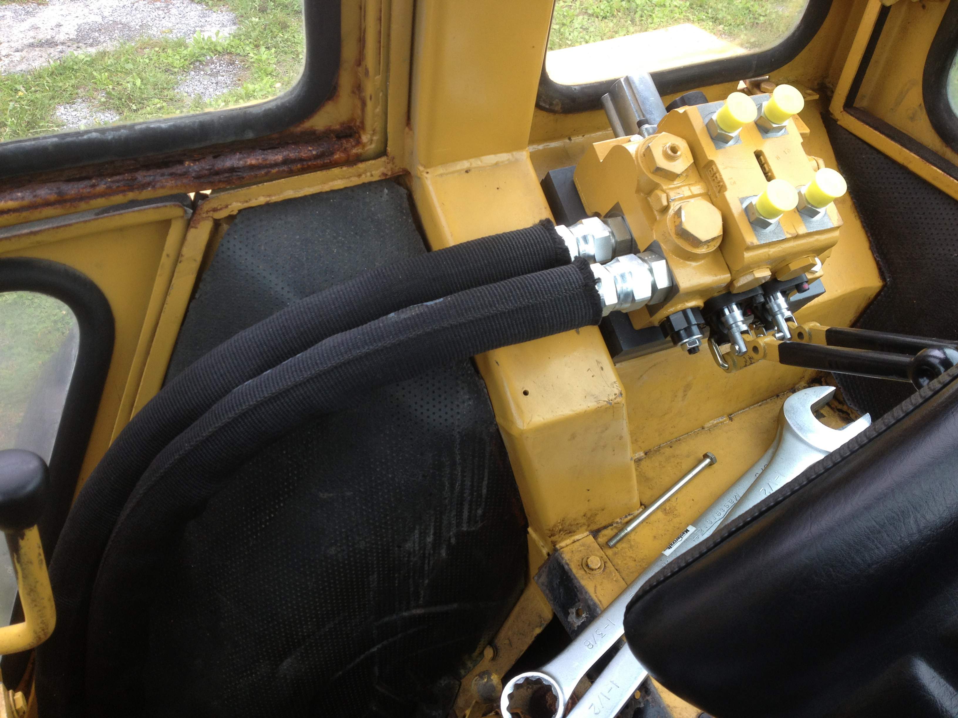

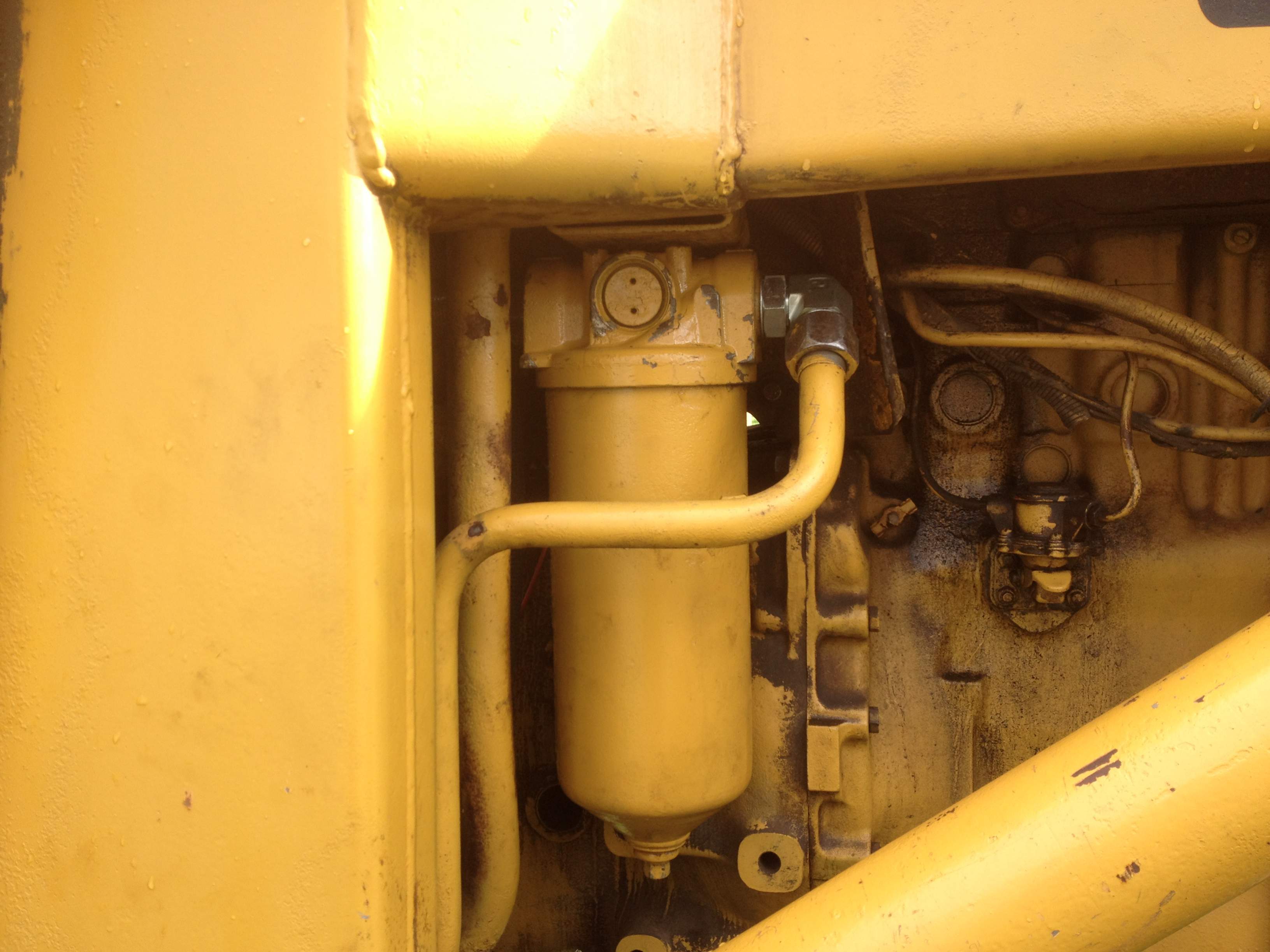

Ok, this weekend the major work began. Since all the hydraulic fluid was drained I started by changing the filter. 2013-09-22 15.12.57.jpg.
Finally I started the task of plumbing. 2013-09-22 11.08.24.jpg2013-09-22 17.29.34.jpg2013-09-23 09.09.18.jpg
The most difficult part so far, was routing the one inch hose.

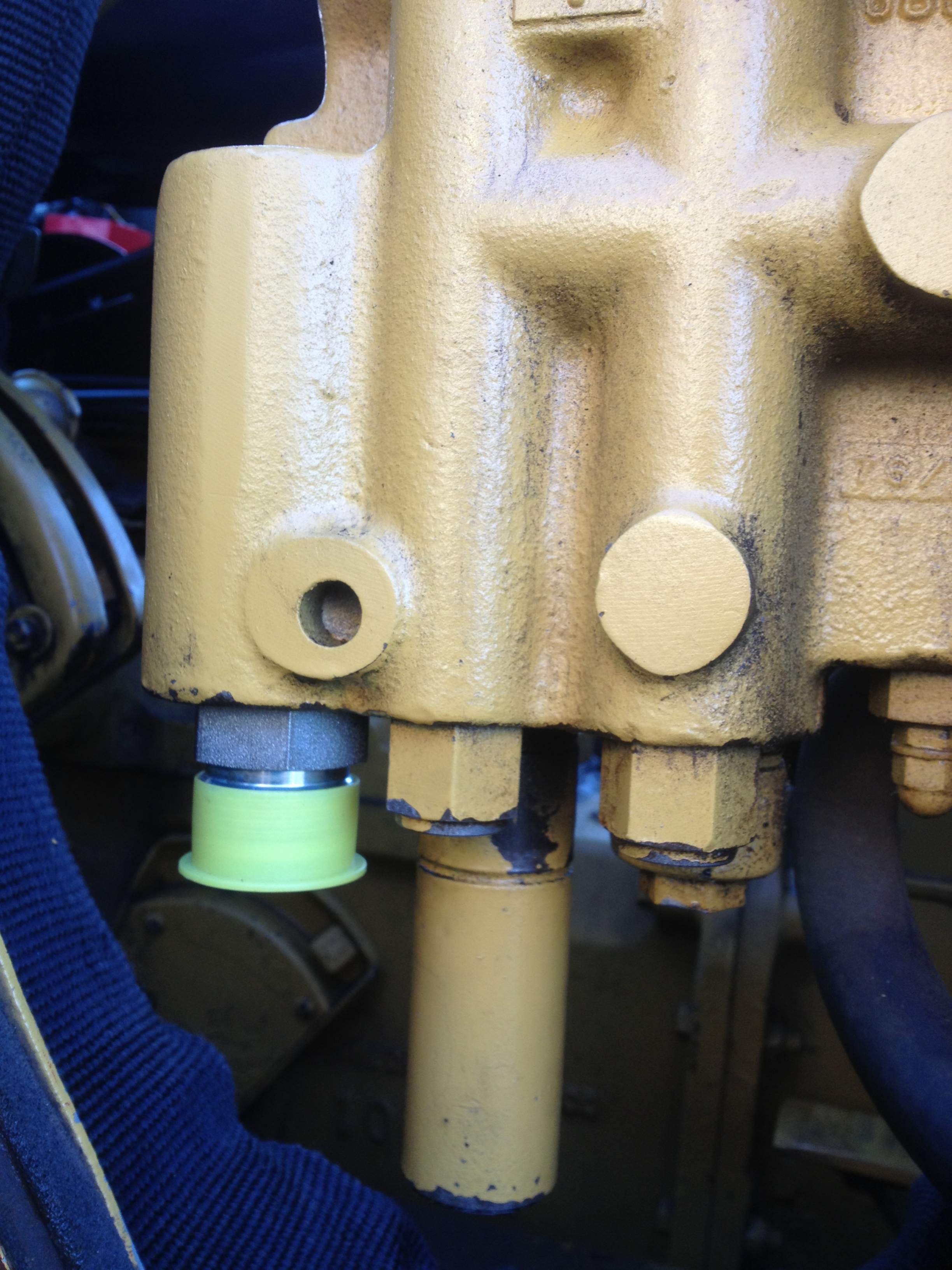

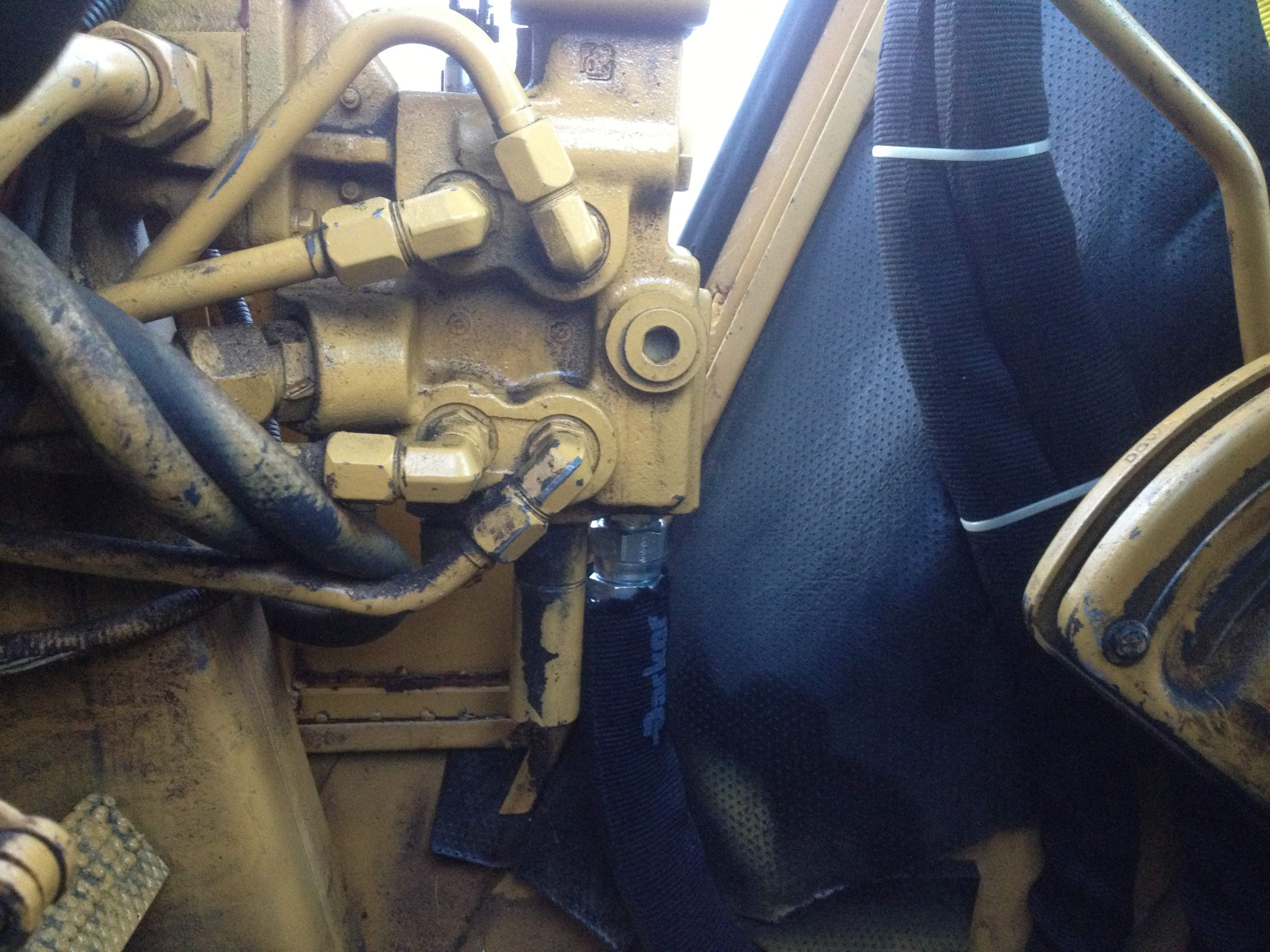

Not much got done last weekend. My JIC14 er, not really a JIC14, but a SAE14 ORB to JIC16 arrived. I just screwed it in and attached the hose.
Here is where the connector went on the loader valve. 2013-09-28 07.32.18.jpg
