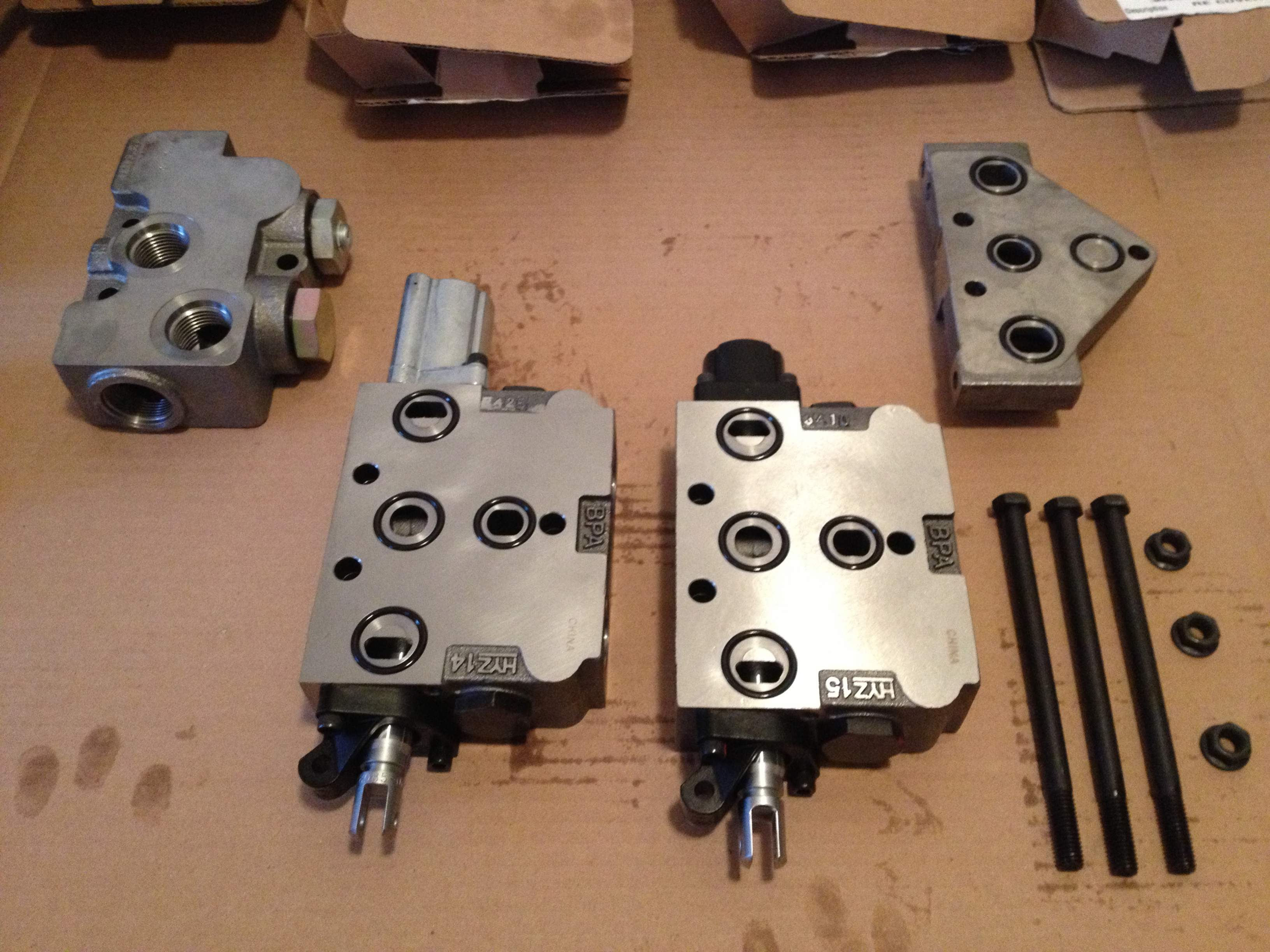

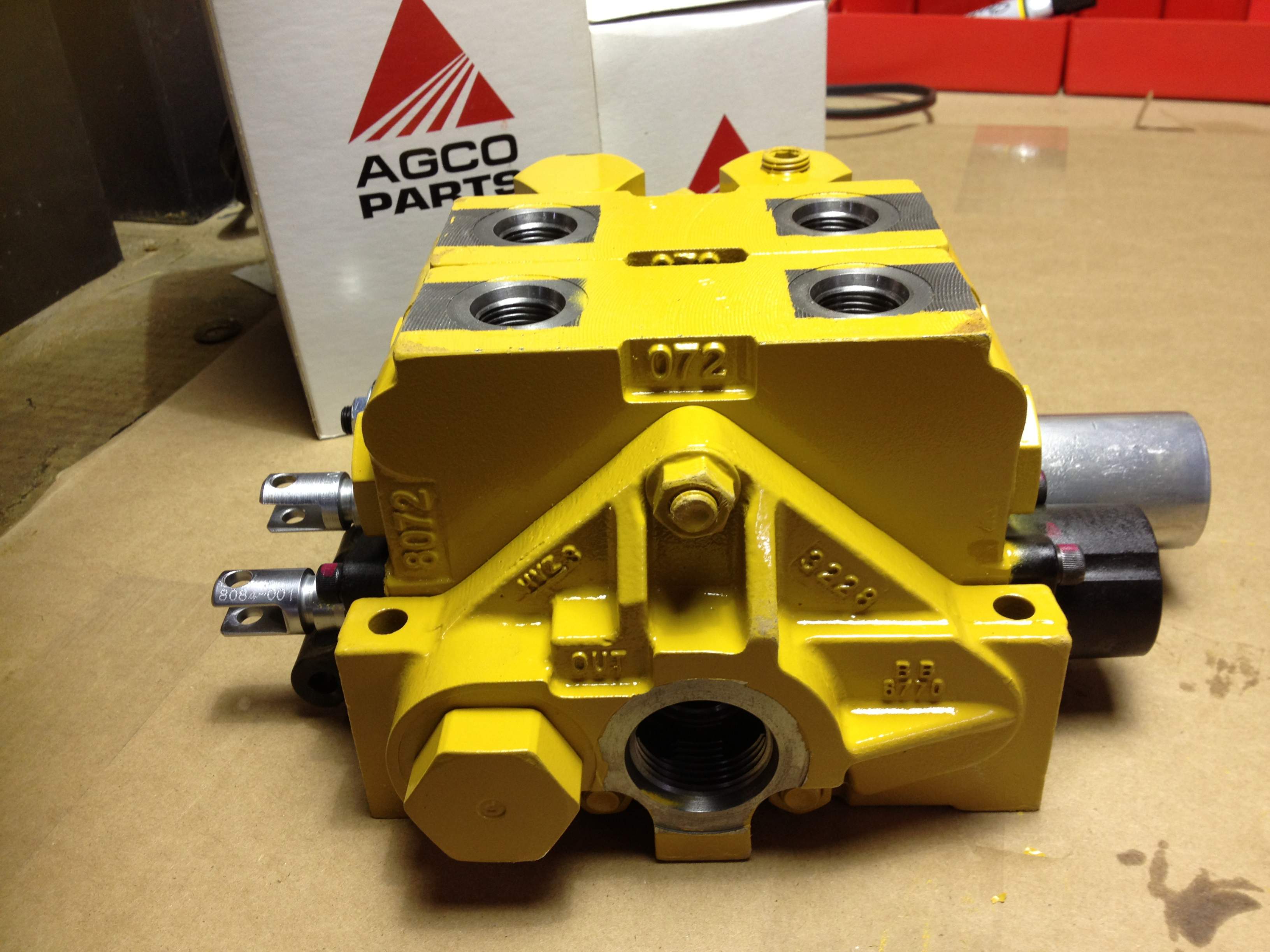

I picked up my parts, and got to work this weekend. Boxed.jpgPre assembly.jpg
Left Cover, Float section, 4-way 3-pos section, Right cover w/PB, Adjustable Relief, PB sleeve and Handles.
My budget allowed for only 2 work sections (for now).

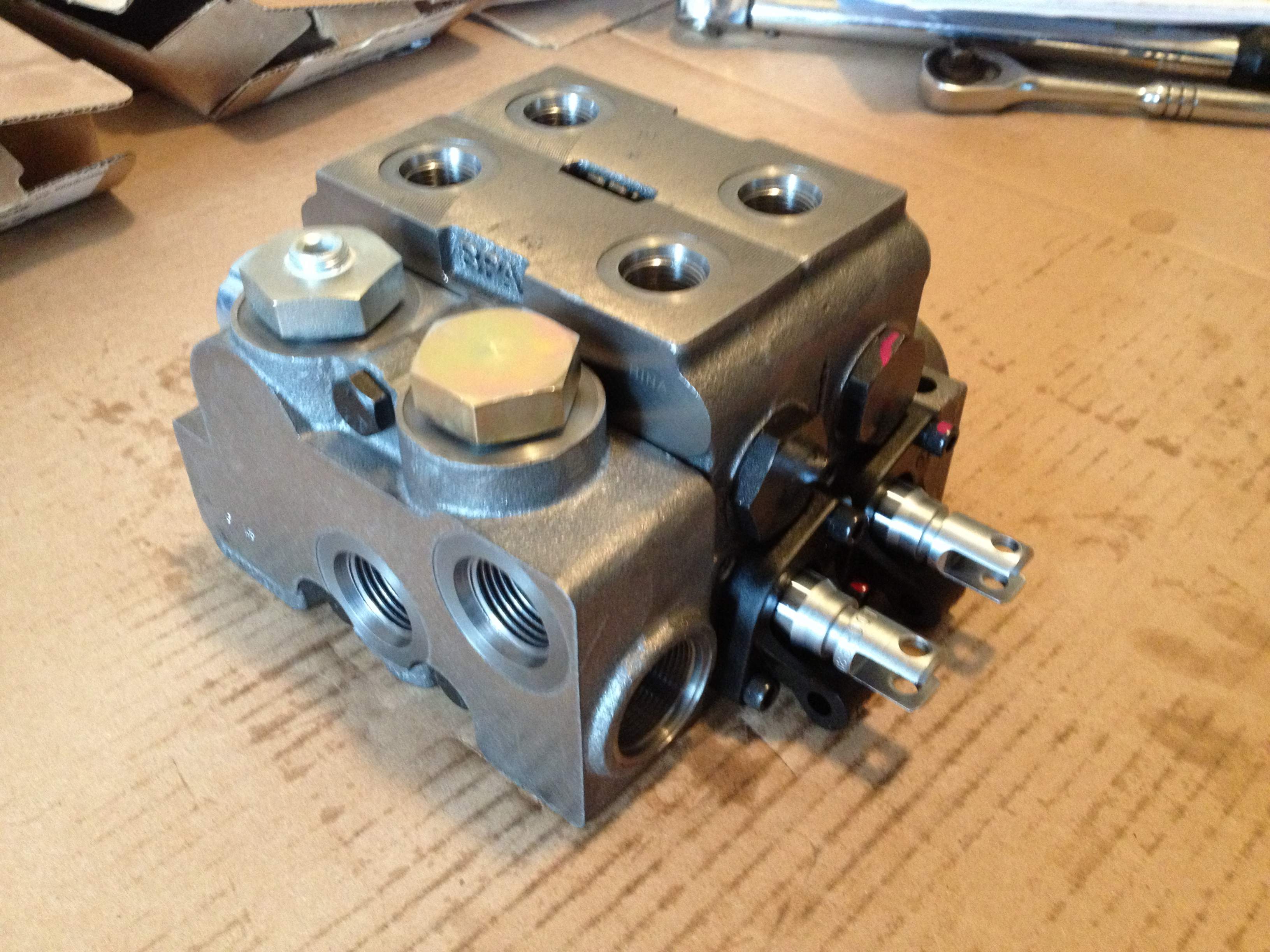

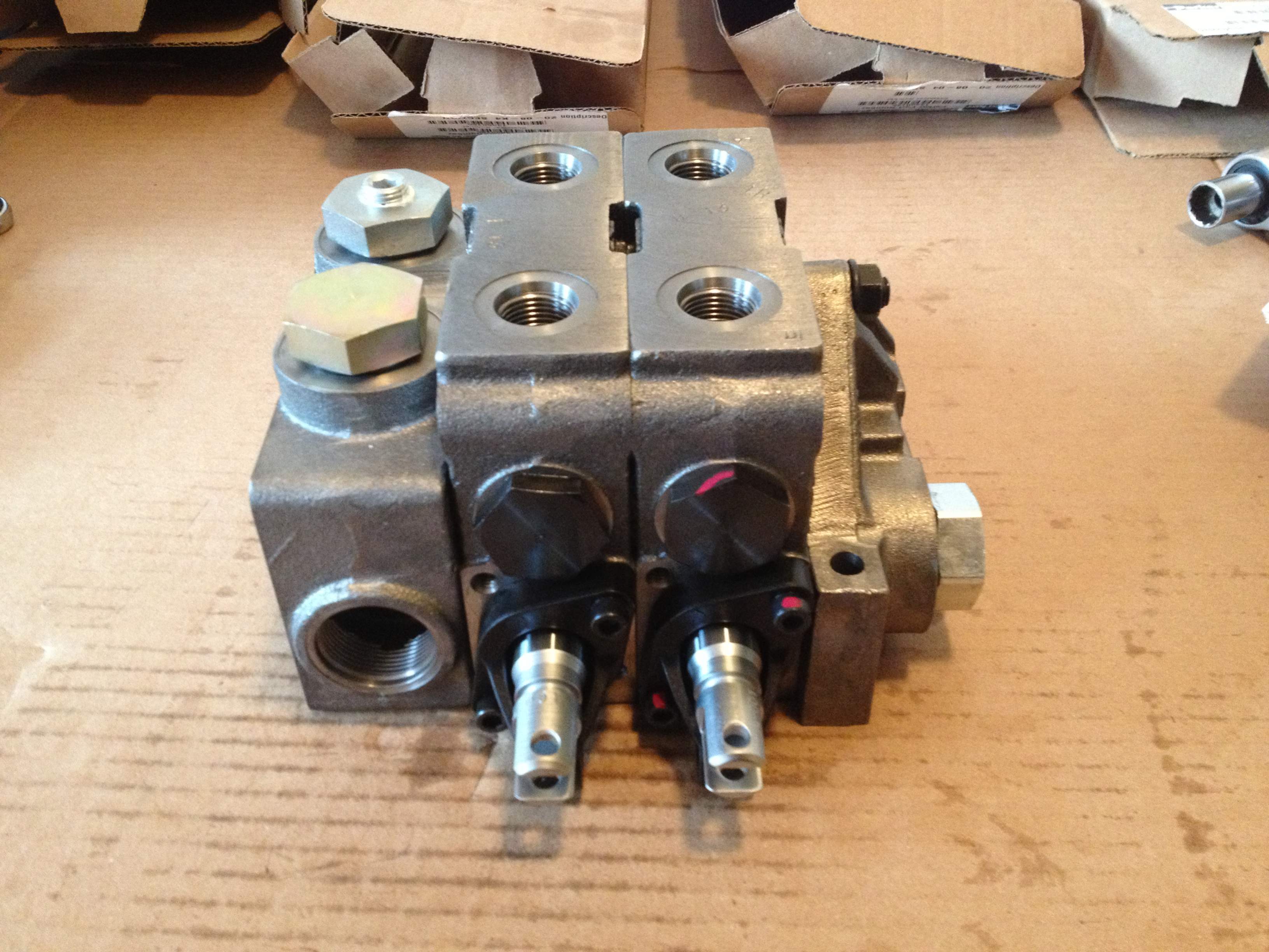

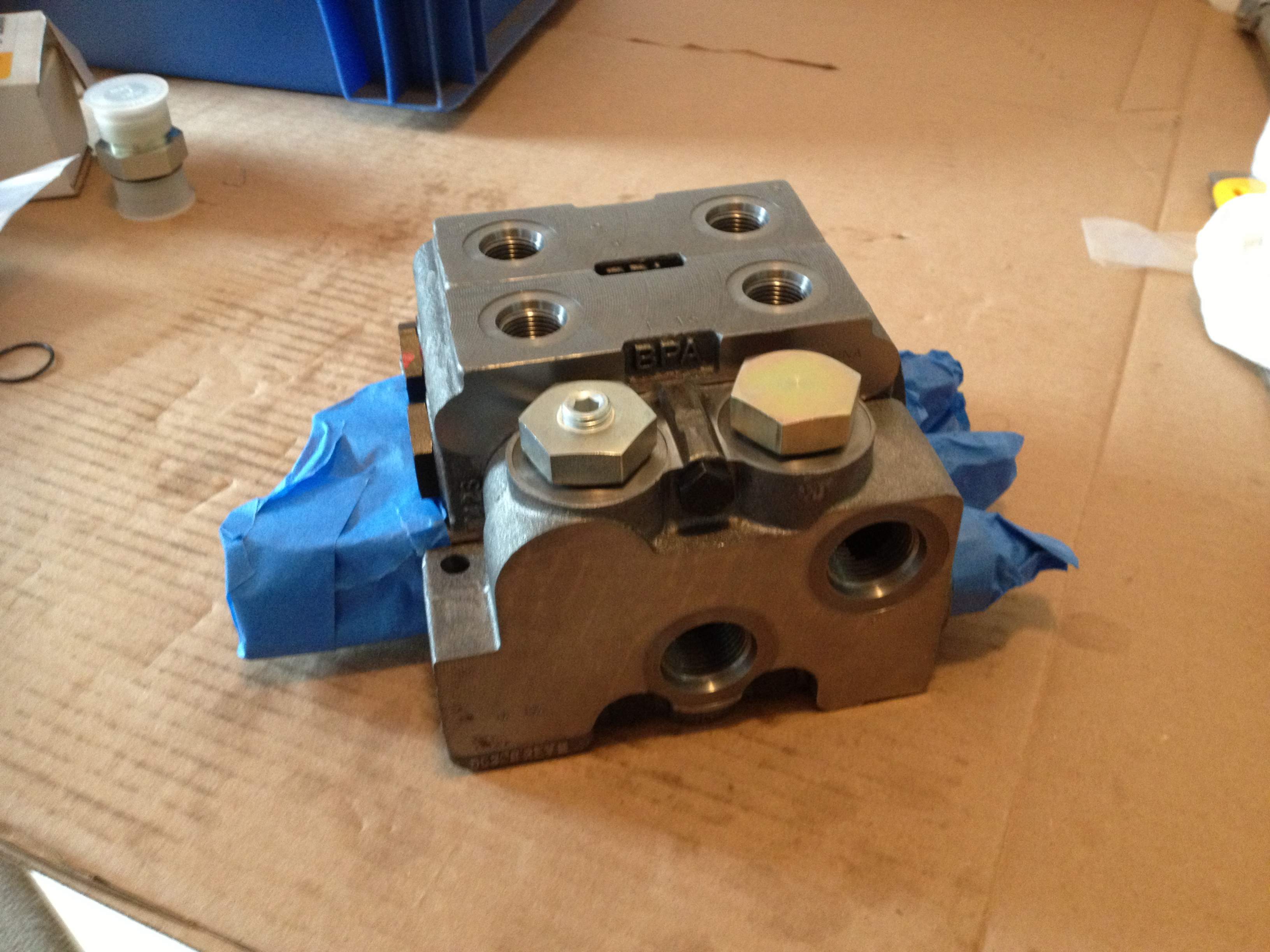

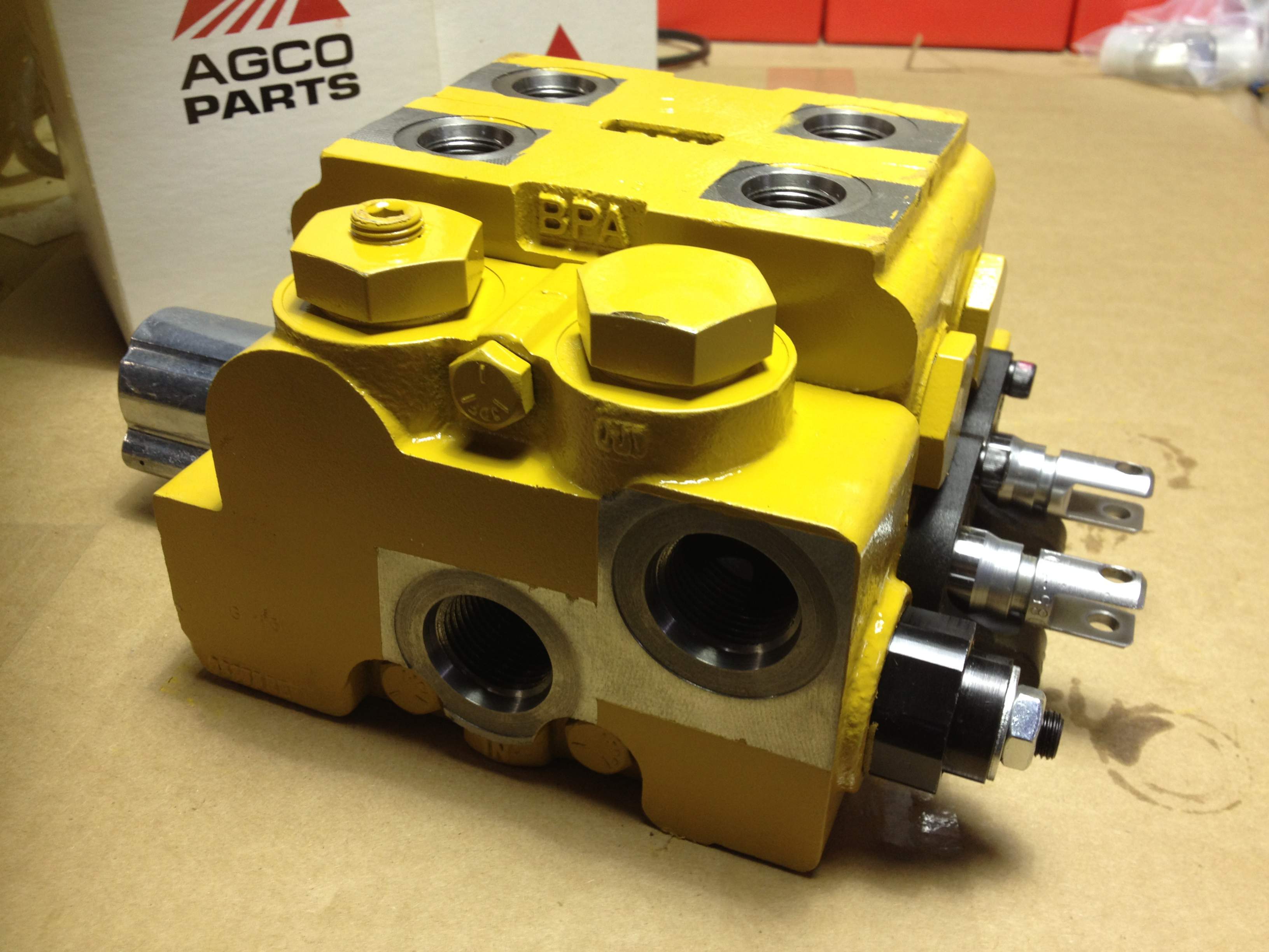

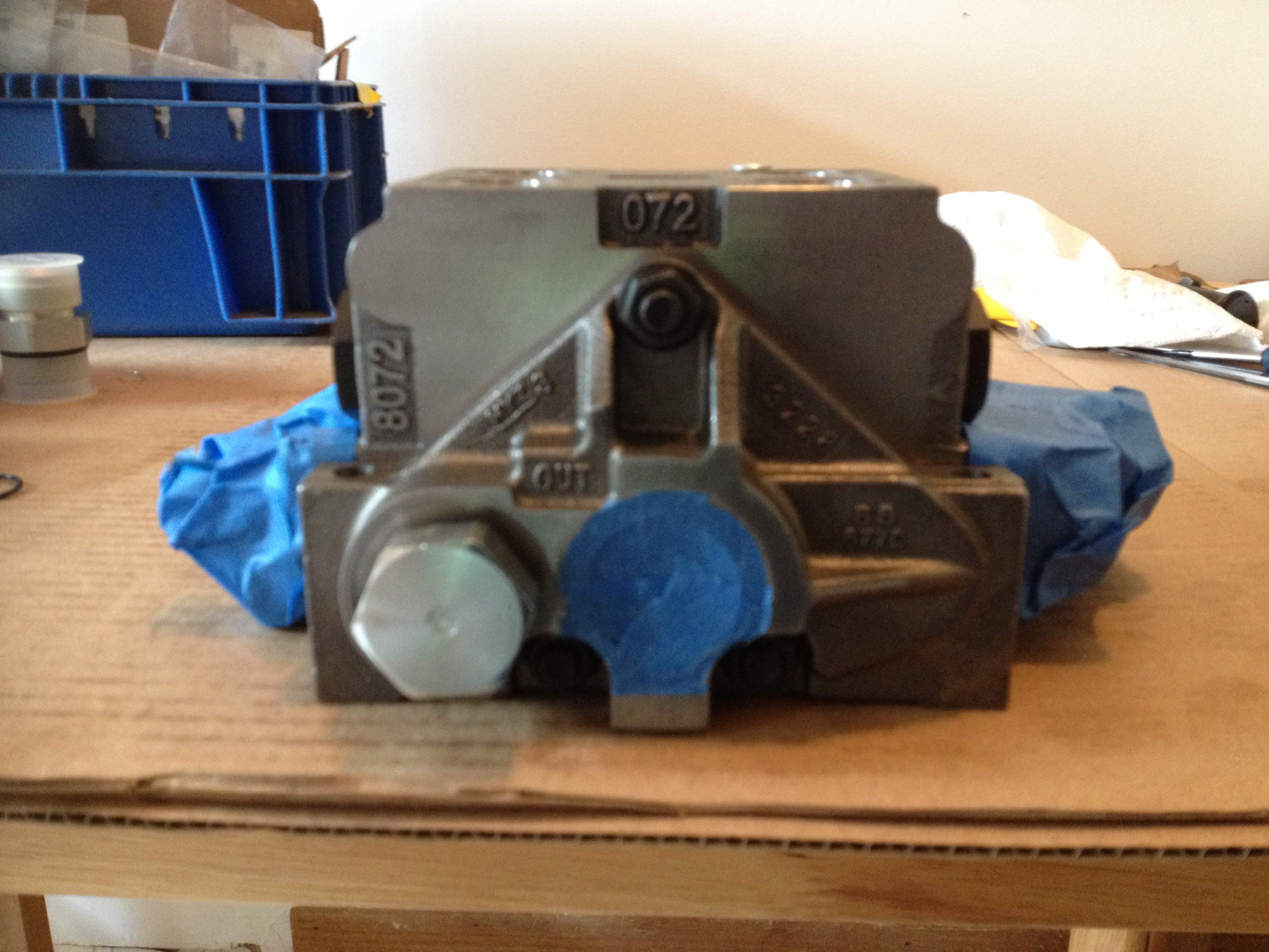

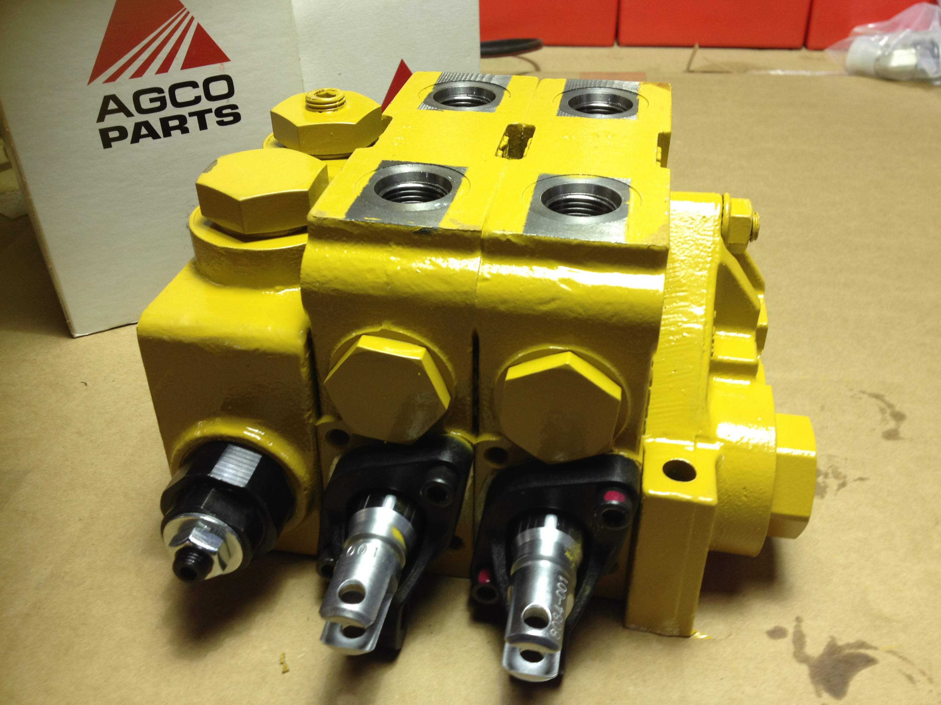

followed by painting MF Industrial yellow.Painted1.jpgPainted2.jpgPainted3.jpg
Next weekend I shall install this baby on the tractor.

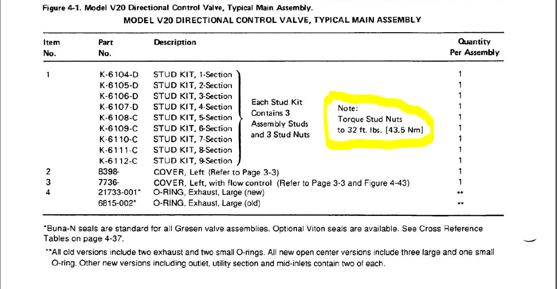

Did you torque the connecting rods as they directed?
Do not tighten the valve to the frame to tight.
/ Replacement Directional Control Valve
#20
I torqued the studs at 25 ft lbs, figured I could always tighten a bit more if I ran into problems.
I will tighten about the same when I attach the valve to the tractor.
