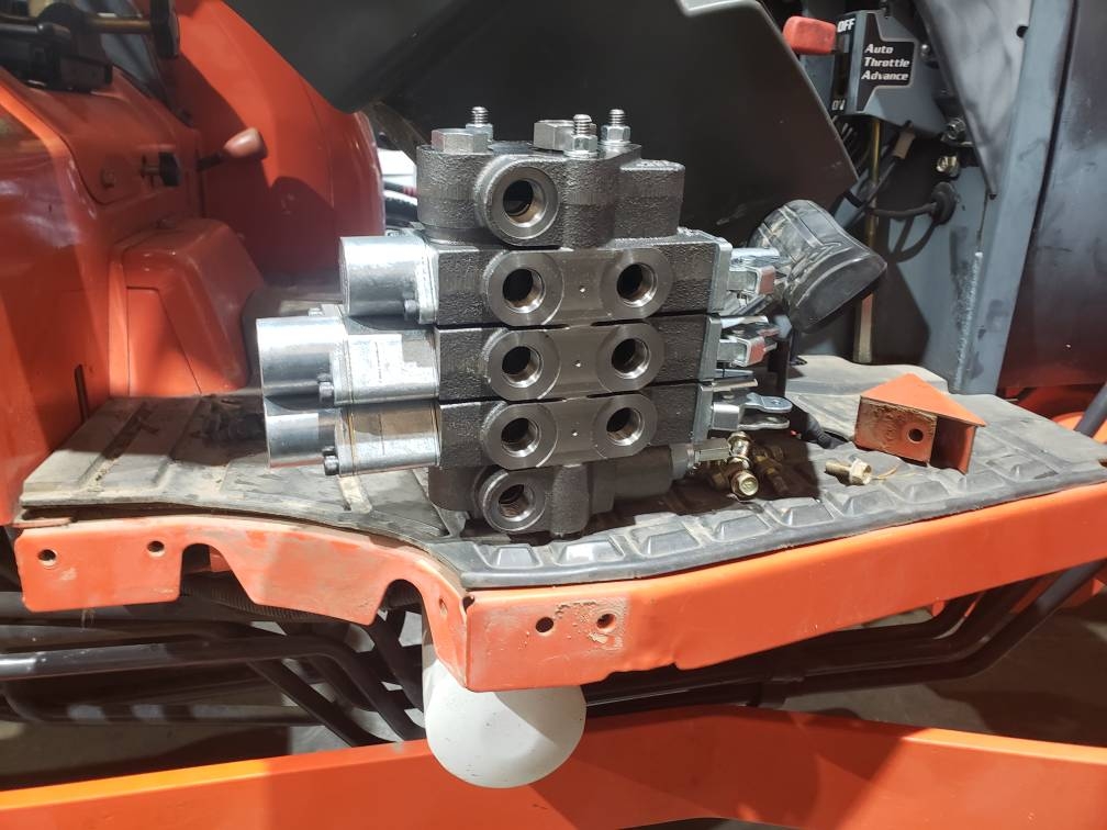

You can do multiple float valves on a sv stack. I have 2 floats on my 3spool stack for the remotes on my L3240.
Can they both work in float at the same time? What brand?
   / Top and Tilt l2501 DIY #24
Here's the stack.

I can attest that the Bucher valves are top notch. And if multiple floats are important to you, you can do that with the Bucher valves but not the Prince SV ones.

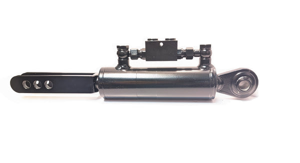

I was looking at getting this top link which has a double pilot check valve.
Which I thought in my use case would work as I figure I want my box blade to stay where I set it. My trail sections are short and tight with slope variations. I do not have a long driveway to maintain.
My understanding is a float valve will not work with the check valve?
