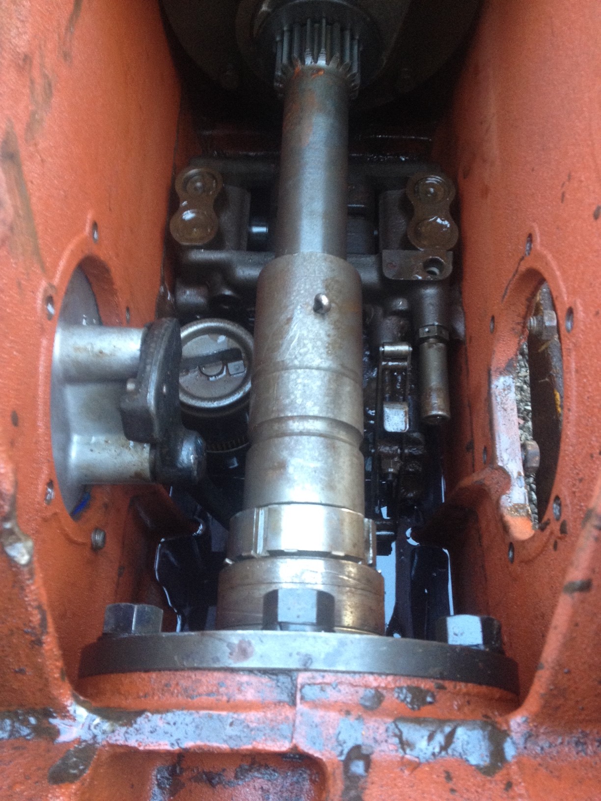

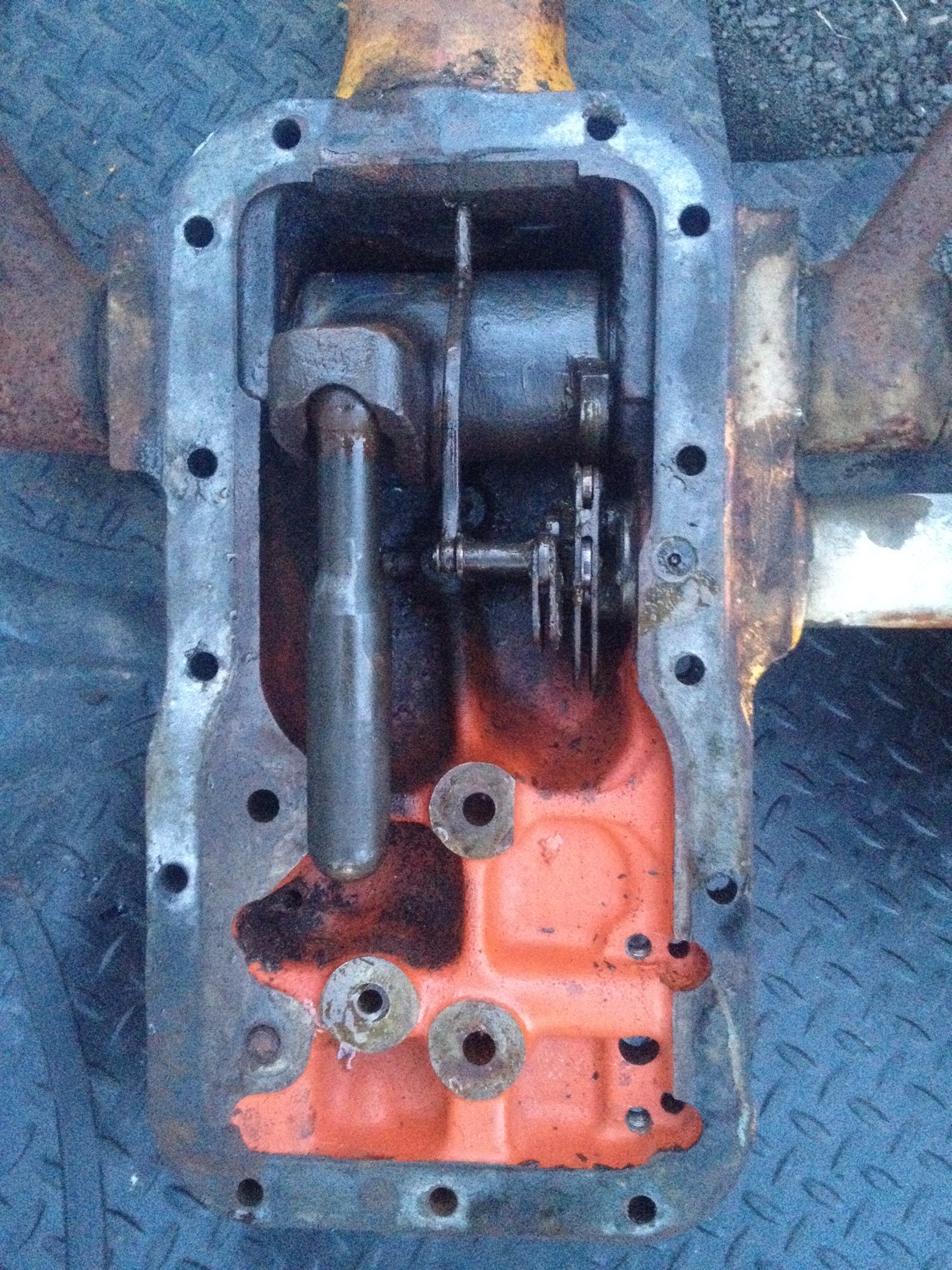

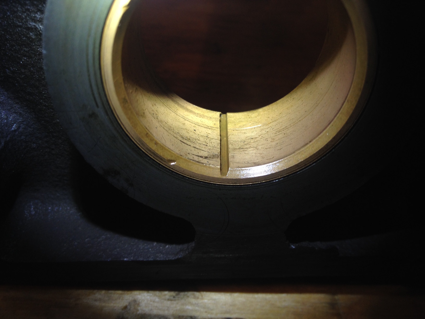

Some of you may remember my thread from a few months back:
http://www.tractorbynet.com/forums/...c-vintage/347197-early-60s-mf-35-utility.html
Well, life got in the way for a while and the tractor was on the back burner for a few months while I sorted out other issues. To sum up my issue from the last thread (which is way long at this point), I bought a MF35 Utility, got it all up and running except the rear hydraulics did not function. I came to the conclusion that the lift cylinder studs snapped off of the lift cover assembly. I finally got around to opening up the rear of the tractor on Saturday, and that's exactly what happened. I'm not sure whether it's due to water ingress, or the previous owner lifting something that was way to heavy and possibly bouncing it over a bump. The fact remains that the lift cylinder is indeed snapped off, all four studs. It otherwise seems to be in good condition.
I have the factory AGCO manuals, but one of the exploded diagrams is still leaving me with a question concerning the hydraulic pump. Considering how easy it was to remove the lift cover, I'm tempted to fix the lift cylinder and put it back together to see if it all functions, but wanted some opinions first.
Third picture below shows the innards of the tractor as seen from the rear. The lift cylinder was sitting on top of the main drive coupler, and the rock shaft was hanging down. In the upper right corner, all the way down in front of the hydraulic pump, I found a very long spring. It looks as long as the springs used for the lift/draft controls. I know there is a spring in the hydraulic pump down in that area as shown in the second picture I got from Google. This spring I found is easily 8-10" long. Is it likely that it came from the lower left side of the hydraulic pump picture?
I'll have to try and drill out the four broken studs, as the lift cylinder appears otherwise undamaged. I'd like to reuse it if possible. Aside from the usual o-rings here and there, is there anything else I should replace inside? Can I fill this thing with some diesel (to continue to flush the system) and run it with the lift cover off to see if the pump works? Without the stand pipe bolted in, I'm betting it would make a huge mess, right?
Thanks, all!

I'm more familiar with the TO/TE-20, -30, which has a different hydraulic control system. However I don't see that anything is damaged from whatever broke the lift cylinder attach bolts. Before you attempt to use the same lift cylinder, check the lift cover mating surfaces for flatness to make sure the lift cylinder was not distorted.
Attempting to run diesel in the system with the lift cover off will give you a geyser of diesel out of the standpipe. I'd build a defector (slide a rubber hose over it and point the end down into the sump) over the standpipe to pump the fluid back into the hydraulic compartment. It will tell you that the pump will pump with no restriction on it and that's not much info. I'd just try to turn the pump via the pro shaft by hand or maybe with a pipe wrench to see if there is anything mechanically interfering with it. If there is, drop the pump. If not, reassemble and test with fresh fluid after you have it buttoned up. You'll get meaningful information with the regular restrictions in the hydraulic circuit.
I'm pretty sure if the pump needs rebuilding it can be dropped without removing the lift cover. But check your shop manual to be sure.
As far as that spring, look in the parts manual to see where it goes. I don't think it's on the pump. I think it is under the lift cover where the control levers are attached. maybe someone with more MF 35 experience can be more helpful.

I've run the engine at idle with the lift cover off, and moving the pump control lever back and forth you should see the oil flow off and on out the standpipe hole. Pump comes out the top on the 35, 50, and 65 models, not out the bottom like 20 and 30. MAKE sure when replacing the lift cover the levers are in FRONT of the roller, I've used the dipstick through the lower side plate hole to hold the lever back.
I have a friend who has a mechanic's straight edge, so I'll use that to check the lift cover. When I emptied the case of oil right after I got the tractor, there was a little oil, and mostly water. I'm fairly certain that the case froze and broke the lift cylinder off. Luckily just those four studs, so as long as I can drill them out, hopefully I should be good. My main concern is with that large spring I found in the bottom of the case. Looks to be the size of the hydraulic lift/draft control springs, but it was broken in half and in the front right of the case near the lift pump as you look at it from the back. I need to make sure that spring didn't come from the lift pump. Maybe I'll try filling the case a bit and making a deflector just in case my RPM are a touch high when it fires. I know there's nothing interfering with the pump, as the PTO works fine, and I've driven the tractor (before I figured out what went wrong in the case) There were no odd noises or anything.
I don't see any way of getting the hydraulic lift pump out without pulling the top cover again, nor did I see any other method in the AGCO manual. That's why I'm considering pulling the pump now while the lift cover is off, replace o-rings and whatever is worn, refurbish the adjustments on the lift cover, then I know everything back there will last me another fifty years.
I did look in the parts manual to see where that large broken spring goes, but since I'm 100% unfamiliar with the pump I can't say for sure. It appears to be the size of the lift/draft lever springs, but neither of those are missing (maybe replaced and the old one fell in the bottom?) and I don't want to risk putting it back together then have to pull it all back apart.
Yep, I see where the stand pipe connects to the pump, I just wanted to be sure it wouldn't force fluid out like crazy. As for your last statement, I've read that a few times. I just read a thread on another forum where a guy fixed his lift cover adjustments and lift cylinder, started the tractor, and the lift arms when all the way up, didn't stop, and snapped the rear of the tractor nearly in half! That would be terrible, so I may order the vintage tractor engineer DVD regarding the hydro pump overhaul and draft/lift adjustments. I want to make sure I've got it 100% correct before starting it. Maybe I'll leave the lift lever in the down position, and crank it over with the coil disconnected to make sure that the lift arms don't do anything funky.
Thanks for the suggestions guys.

On my friend's 35, I had the gearbox off the rear casing to renew gearbox bearings and seals a couple of years ago. I believe the pump from memory would have been easily removed at this point as well - only a front PTO shaft to remove, although it's a snack to remove the top cover in comparison to splitting the casings behind the gearbox. BTW, you may need to remove your PTO output shaft in order to remove the hyd pump with PTO front shaft. I can't remember the finer points with any accuracy, but looking at your 3rd pic, it may be difficult to get the pump upwards past the gearbox-to-diff driveshaft.

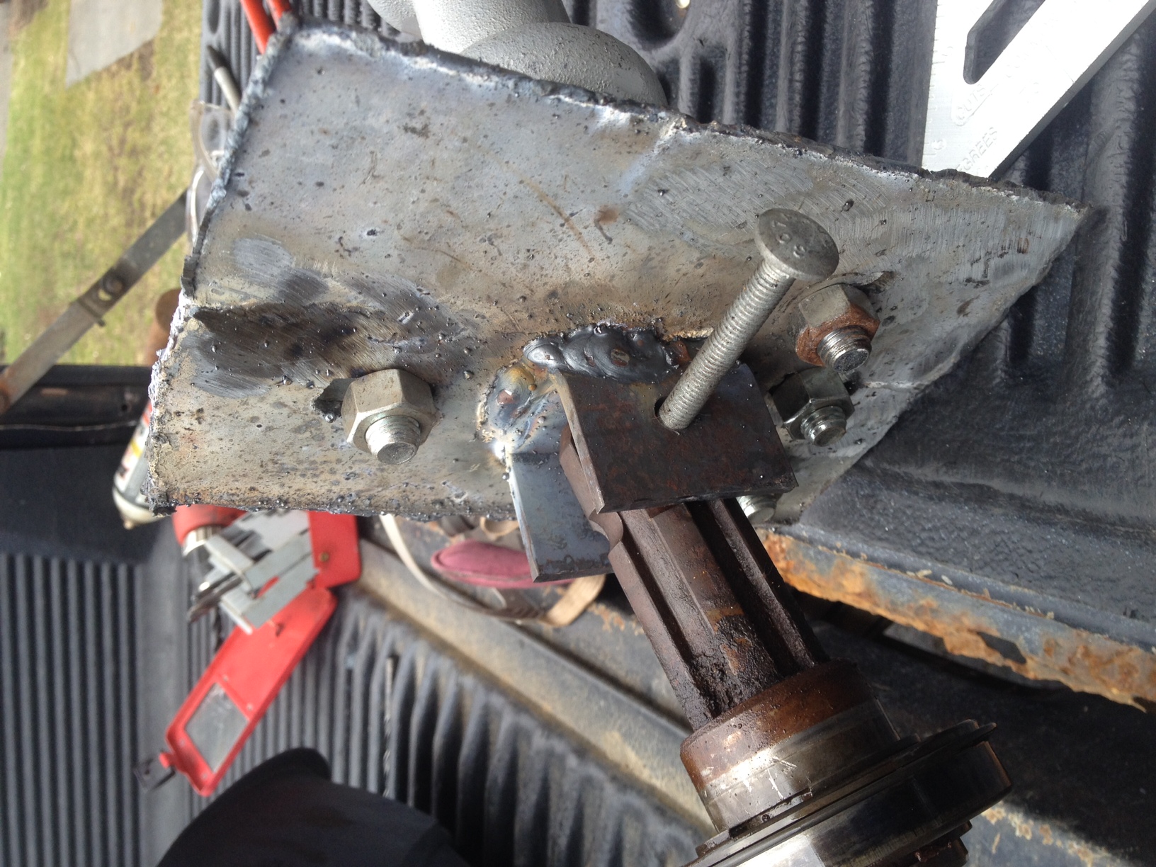

Well, I gave it a shot today. Got the sheer collar out in about 40 seconds. I cannot, however, get the PTO shaft out. I removed the three bolts for the retaining ring, I pulled the large diameter seal retainer with no issues.
I had a screwdriver through the hole in the PTO shaft and pried against the rear of the tractor with huge pry bars, still no luck. The shaft spins freely, but I'm guessing that the water in the case seized the shaft inside the inner bearing race. Suggestions? Other than this setback, the hydraulic pump is ready to come out!

The bearing is seized into the transmission casing. You need a slide hammer to "shock" it into moving. Don't forget there's a serious amount of oil there! Tapping it inwards a little may also achieve this. I'm pretty sure they are all the same - two pry-bars or some sort of slide-hammer on a strong bolt through the hole in the shaft might be needed to move it outwards. The bearing has from memory a snap ring/circlip before it on the PTO output shaft and this shaft should come straight out the back with the bearing on it. Renew the seal, O-ring and bearing (they are very cheap) and grease the outside of the bearing and the seal lip on reassembly. I would also strongly recommend fitting the protective cap available for covering the PTO shaft and seal area.

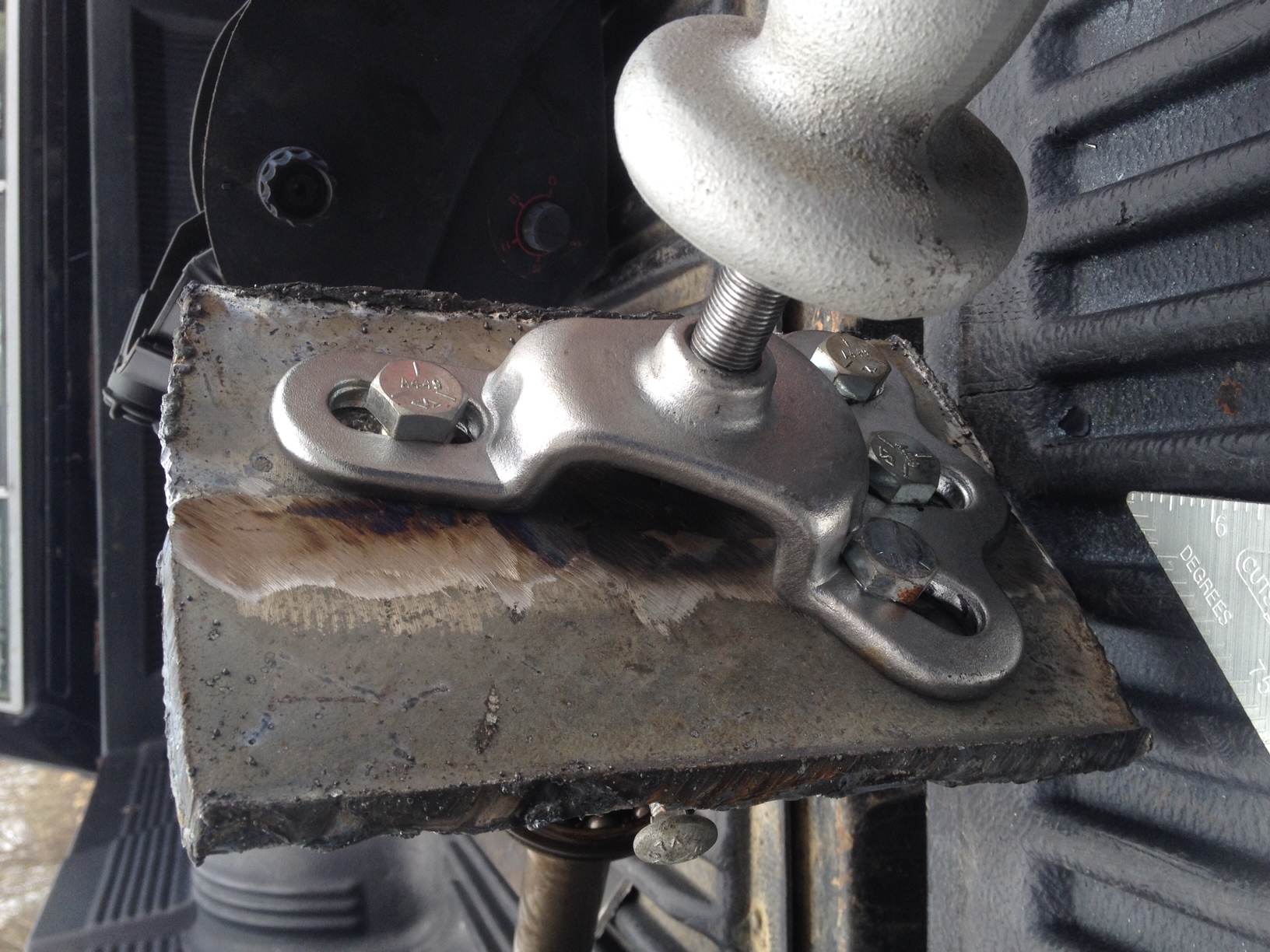

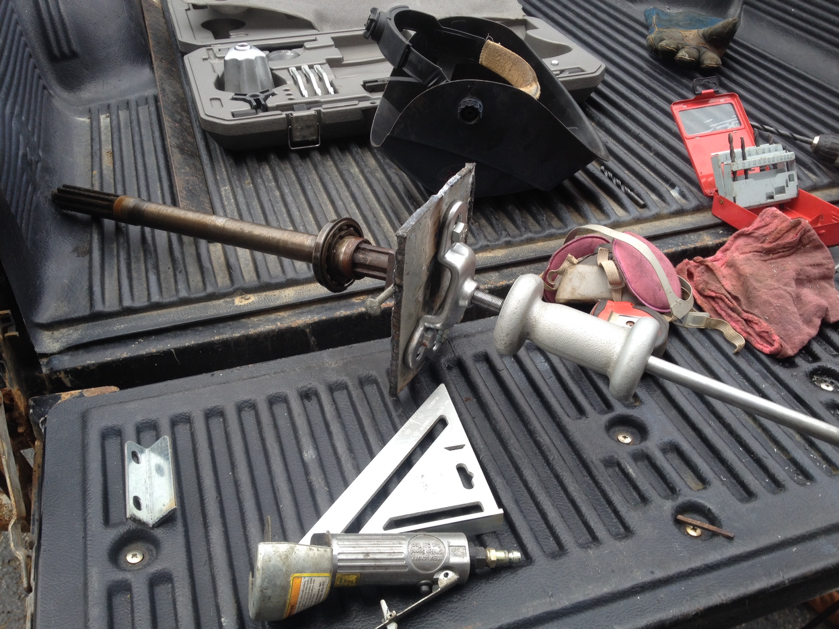

Well, I got it out. It's amazing, I had tried a 6' pry bar attached to a chain last week too. No luck with that. I shoved the bar into the ground and created a nice sturdy hole and let it rip. PTO shaft wouldn't budge. So I tried the D-ring method, but I couldn't get it tight enough and it kindof acted like the chain, it seemed to take up too much of the blow from the slide hammer. So I tried to think of ways to hook the slide directly to the PTO, or more solidly, anyway. Considering I'm working on it at my parent's house, it's not uncommon to see my father wandering around with the dog. He walked by and suggested the method that worked like a charm.
I found a piece of heavy angle iron, grabbed my plasma cutter and cut it down the middle. (I couldn't find anything else thick enough). Ground it down, welded it into a flat piece of steel. I traced the slide hammer end in marker, cut out the holes and bolted the universal end of the slide to the plate. On the back side, I bent up a piece of band iron into a U-shape, drilled two holes and welded it to the larger plate. I stuck a bolt through to hold it to the PTO shaft, gave two very solid hits with a 5lb slide hammer and the PTO shaft ended up in my lap. Excellent.
Now the hydraulic pump is out, sitting on my workbench in my basement. Sometime this week I'll start pulling it apart. I've attached a few pics to make it clearer what I did to get the shaft out.
Also, it seems that the control valve on my hydraulic pump is seized. The large spring I found in the bottom of the sump definitely came from the pump. The good news is that the pump still spins very freely. Hopefully getting the control valve unseized won't be too difficult. I'll take pics as I go.
Thanks for all the help, I'll be back with more updates soon!

Great news - you got it out! Love your work! :laughing: Persistence combined with ingenuity pays off! :thumbsup: I like your and your Dad's idea very much - obviously very effective too. I've never seen any stuck as tightly as that. What a mission! Now you can continue. I look forward to seeing your continued progress. :)

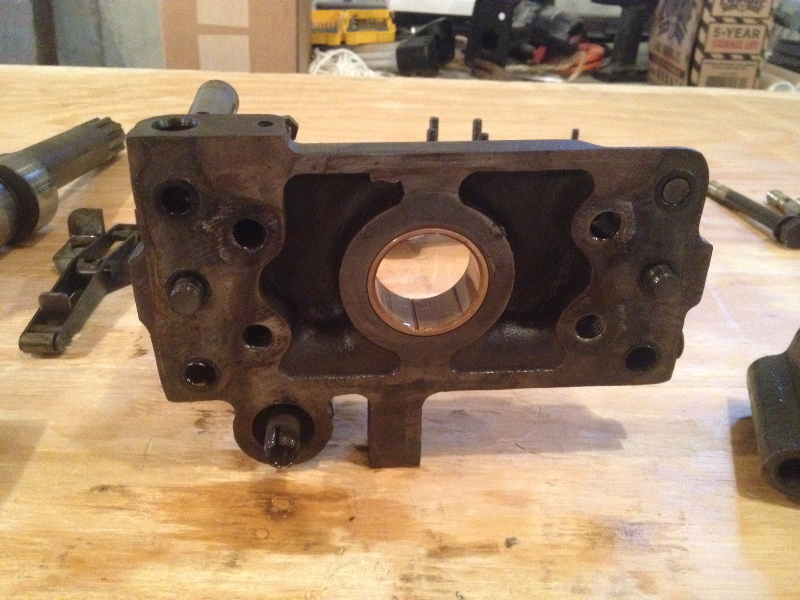

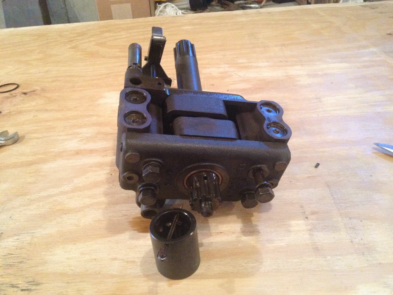

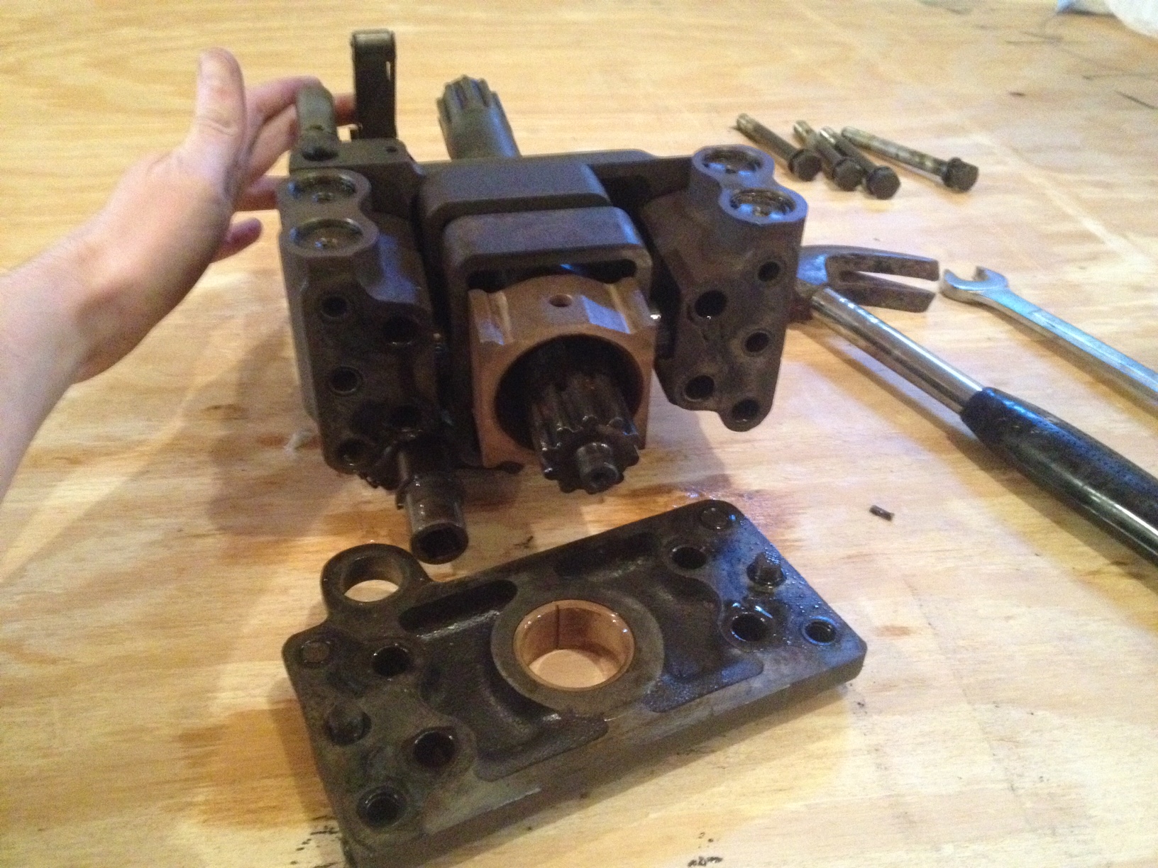

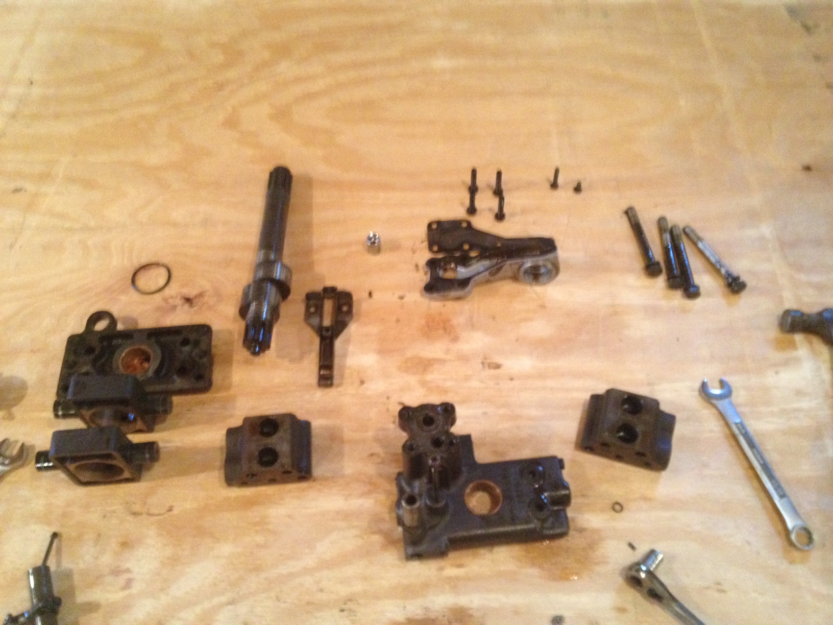

I've got the pump torn down, I just need to grab my snap ring pliers to get the valves out for inspection. It looks like work may have been done to it at one point, though I can't be sure. I found a piece of debris in the pump that might be the remnants of a broken piston ring. I find this odd because my pump is fitted with the filter, but I digress. There is a little marring of one of the brass journals, but I can't feel it with my fingernail so I'm not overly concerned about it. I forgot to take pics (my hands were very oily, so not a lot of pics) of the brass cam blocks. There is a little marring on them, too, but not on surfaces that make contact with anything else. It looks like debris fell on top of the pump and as it rotated, got crushed against the pump casting and pistons. I'm checking with my local Massey dealer today to see what he thinks, he used to work on these machines daily so I trust his opinion.
Also, of note- for anyone looking to rebuild their pump, the Vintage Tractor Engineer DVD is truly the way to go. It takes out all the guesswork and goes into great detail. I'm pretty certain I could have pulled this apart and put it back together, but they go into detail about what to look for, and all the adjustments you need to make to the control levers and draft spring to make your hydraulic system function as intended. I highly recommend it!

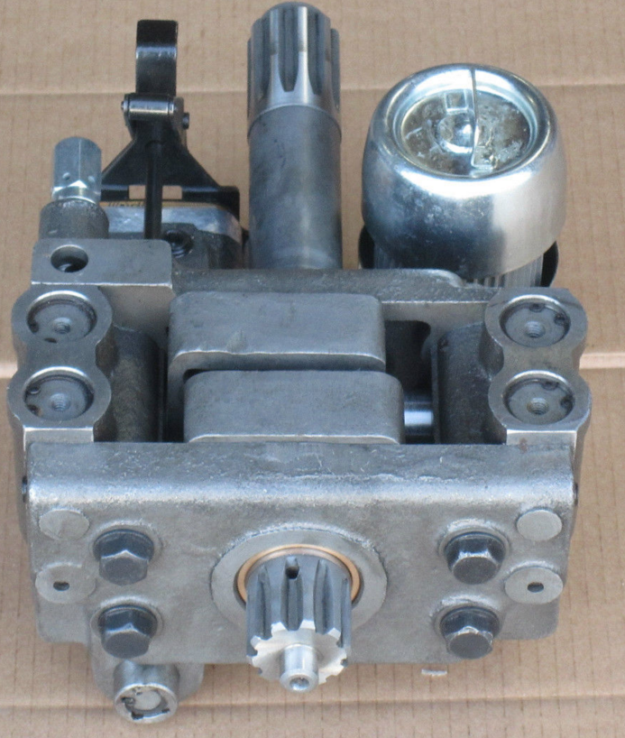

On to the pics, they're grainy because I was working in my basement. My hands were oily, so cut me some slack. :)

Great, you've surged forward now! Nothing really high-tech - just thoroughness and attention to detail.
/ Repairing MF35 Utility Hydraulics
#18
Yep, I had a concern about the brass cam blocks being slightly scored, even though the scoring isn't on a mating surface. Local Massey dealer says they're fine. Looks like a good cleaning, new 0-rings, control valve/spring assembly, and pressure relief valve and I'll be putting it back together. Very promising!
I'm VERY happy I pulled the pump out, despite that pesky seized PTO shaft. The control valve wasn't operable in it's condition. The c-clip and end piece are long gone, the spring was laying in the bottom of the case, and the control lever with the rollers was not connected to/touching any part of the valve. I'd have been quite upset if I put it all back together and it didn't work.

Yes, it would not have made sense not to have investigated the pump condition having already gone that far into diagnosing the problem.
It all sounds rather straightforward from here.
