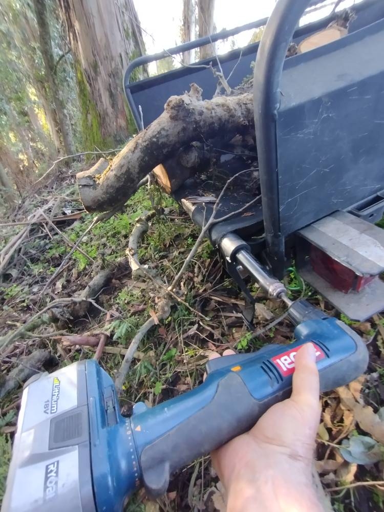

I just used it to carry/unload a 4x8 trailer load of fallen Redwood limbs and branches, maybe a 800 lb load. It worked fine, just like the videos on YouTube. I don't know how much more weight it would move with such rough objects, without tearing.
I made an adapter to mount it in place of the trailer's tailgate, which has drop-in pins. And welded a socket into the end opposite the crank, to turn it with my drill and a 3/8 adapter. (This didn't work until it was near empty).

Using the unloader after modifying it to mount on the trailer.
/ Recommendations for Pickup Truck Unloader? #6
I see why you went that way for a trailer mount. Lacking a tailgate, the crank handle has no clearance. I never tried a trailer mount. I found that I could load up one of my trailers, then use the tractor's loader to lift the front to have it dump.

My trailer in post #5 above has a steel floor down the center then plywood for the left/right floor panels, I think to improve traction when loading a 4-wheeler. The manufacturer was Snow Bear so maybe the trailer was designed for a snowmobile.
At any rate it didn't feel like there was much friction between the plasticized fabric and that floor.
In that photo I had the trailer tilted as far as the 3-point could lift its front, and I had to gouge a rut in the ground for the crank handle to turn 360 degrees. I'm considering shortening the crank handle because it was fairly easy to turn the crank and I don't need so much leverage.
