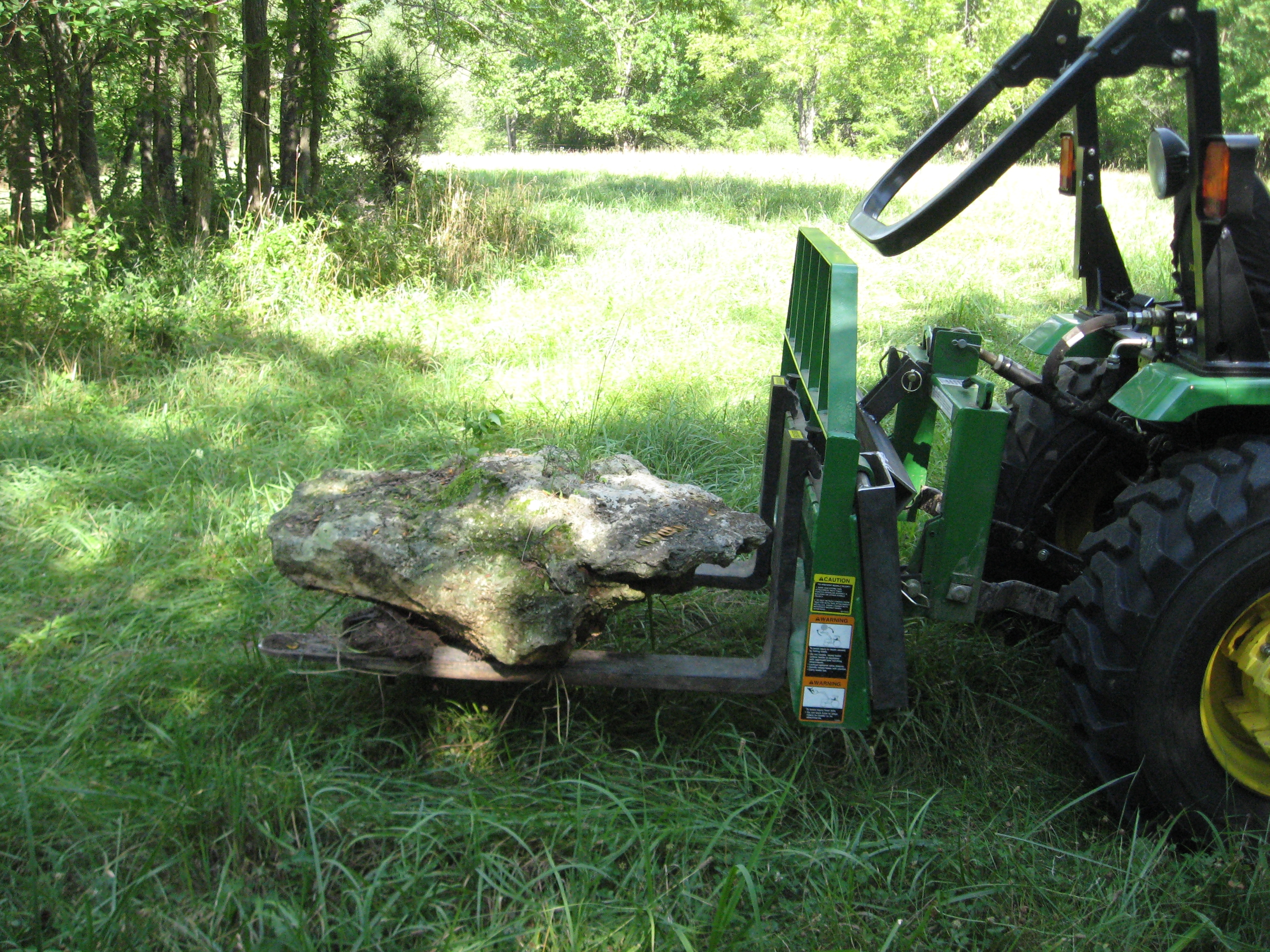

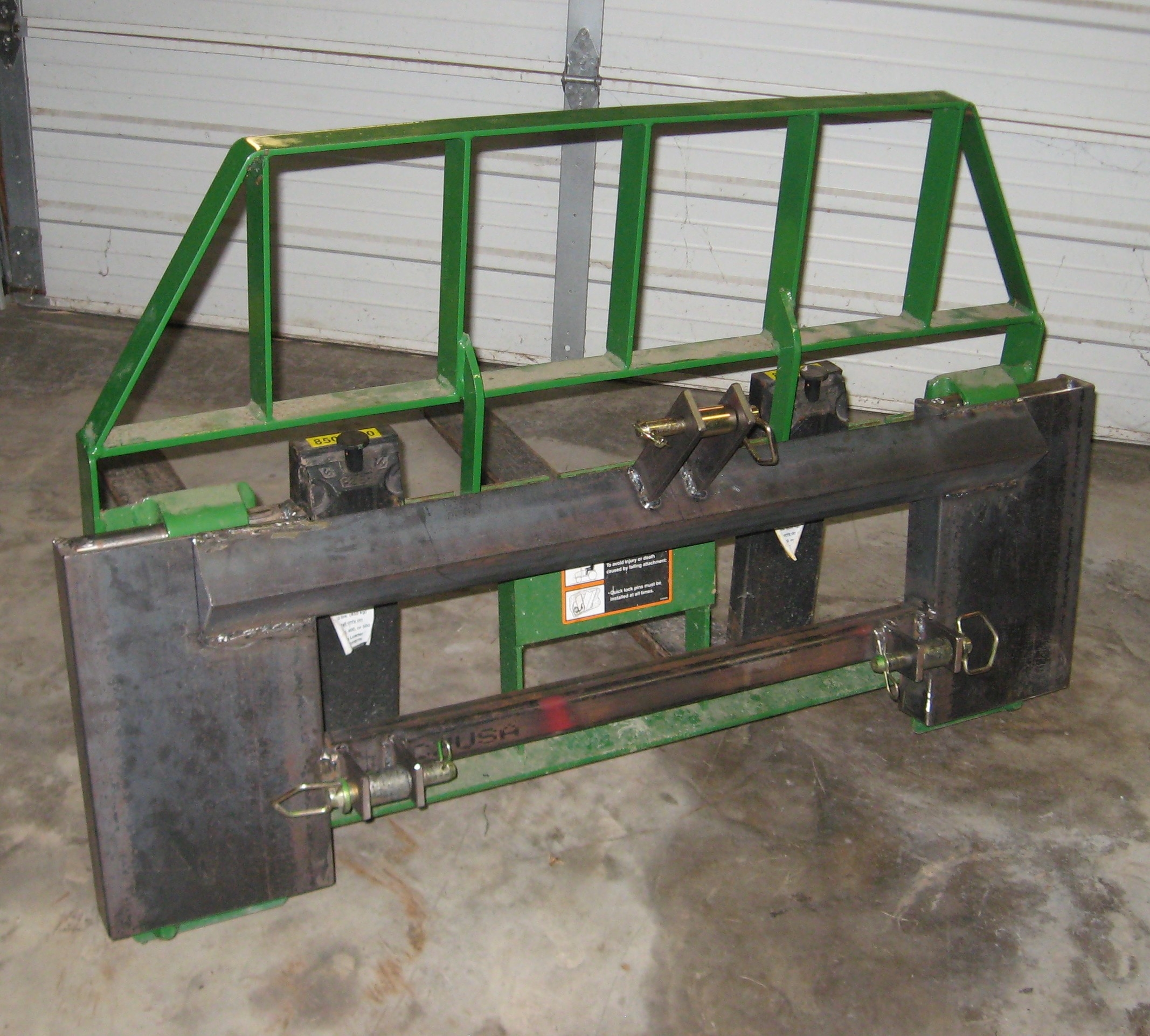

I built a three-point adapter for the JD hook and pin style pallet forks.

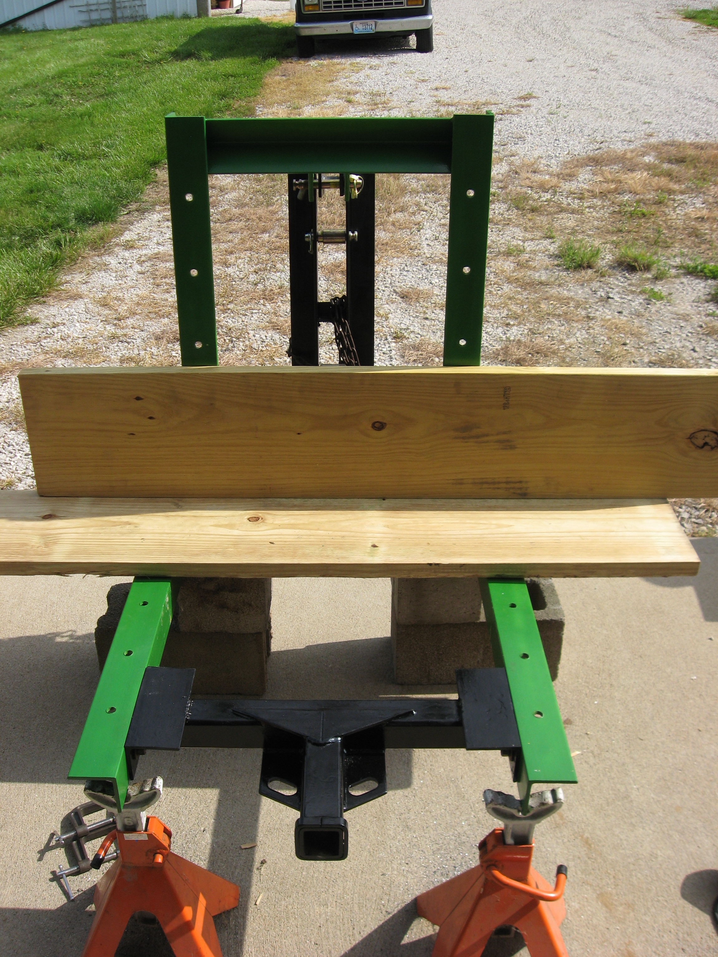

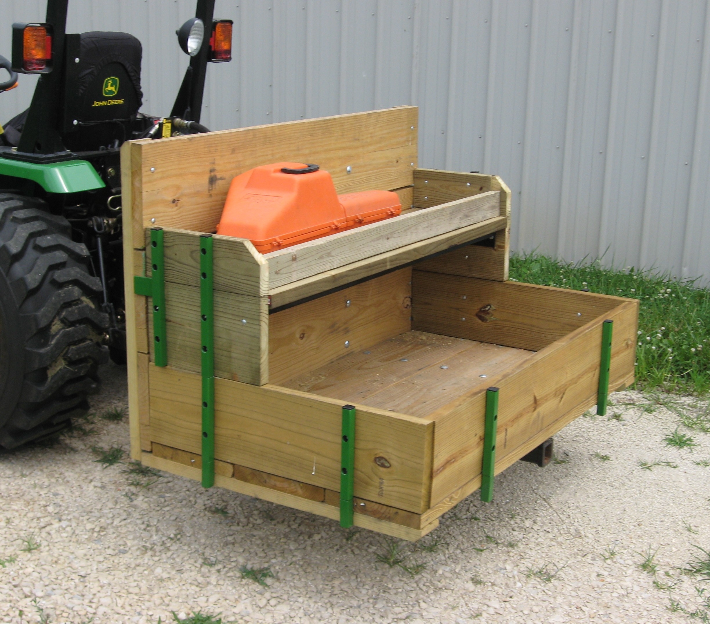

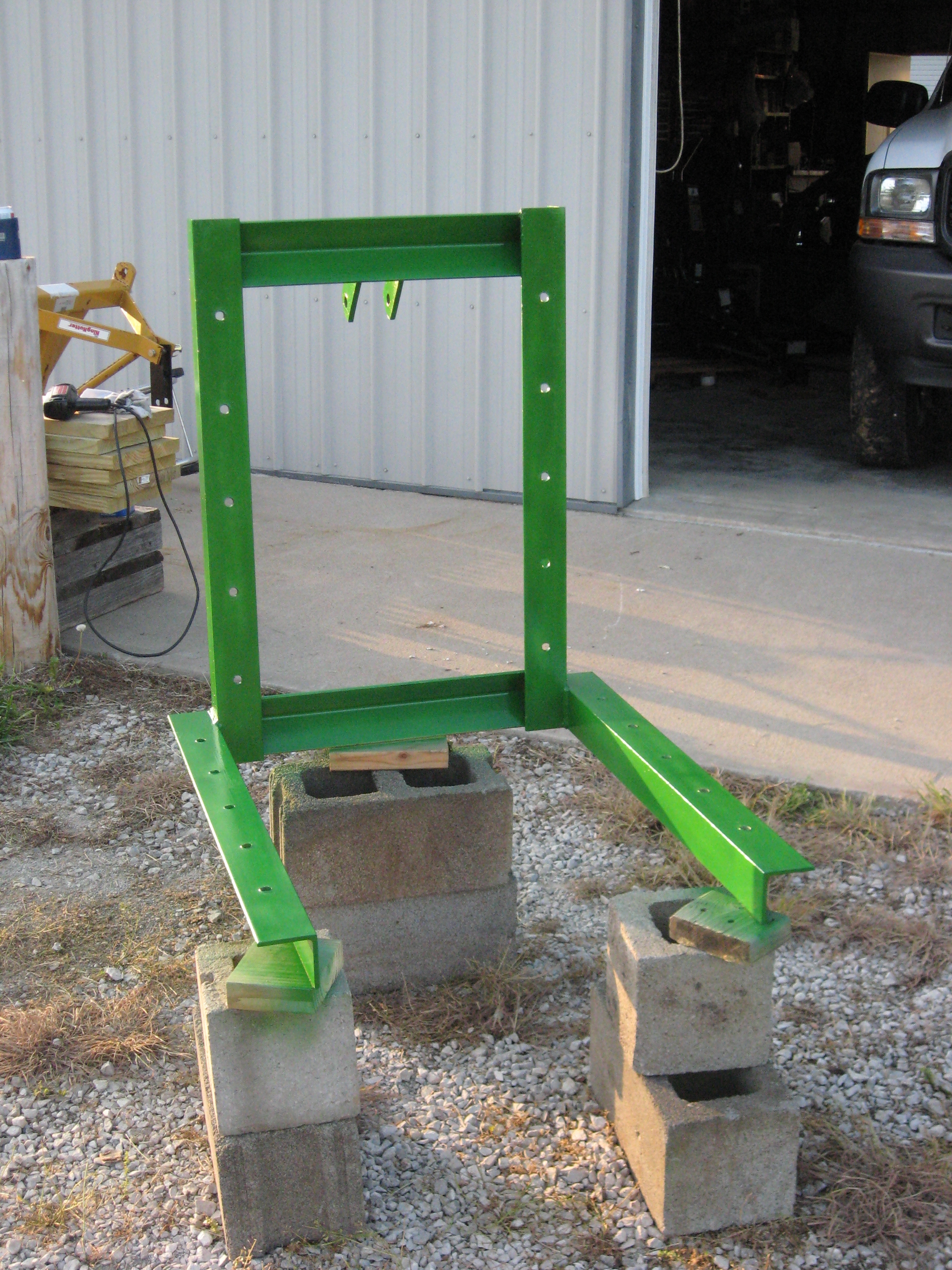

I bought my County Line carryall frame from Tractor Supply and did the wood part myself. If you look close, you can see that I also added a receiver hitch to pull my utility trailer behind. Here is what the bare frame looked like (except for the green paint).

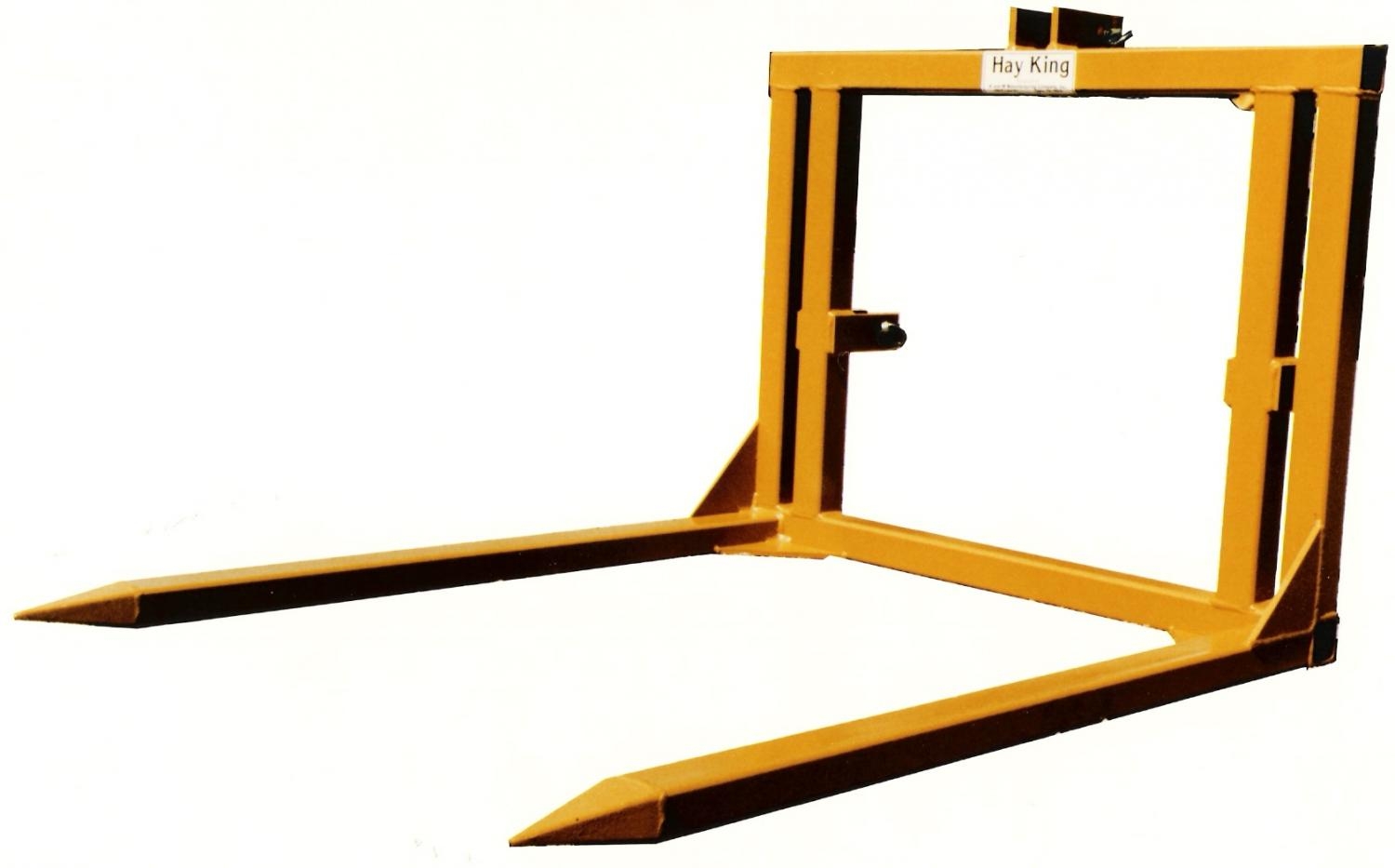

I use a three-point Double-Fork Carrier from Hay King for all sorts of material and tool handling. Heck, I even use it to move round bales of hay! :)
Very solid and well-built. You can certainly build whatever type of bucket or platform to fit on it.
Hay King is a small business located in Taylor, Texas. I have several of their products. Highly recommend them. More info here: Hay King Loaders

Yes ! Looking at Hay King ! Taylor only 45 minutes away from me.:) Long ago had a renovator from them. Was solidly built.
Did you do any modifications / make into a carry-all ? Maybe best that I build my own pallet ? What say you ?

They are great folks at Hay King. I have a small renovator and a disc harrow from them as well. Rock solid!
No modifications to the actual carrier, but I did build a wooden platform for a 200 gallon water tank that I tote around to water trees. The platform is just 2x4 and 4x4 designed so that the carrier tines slip under the platform that supports the water tank.
I typically use the carrier by itself for hauling cedar branches or long-handled tools or for moving long heavy objects like a tree trunk, etc.
You could easily build a sturdy wooden platform for it, kinda like a pallet, or perhaps weld on anything metal for your needs. I like the ability to "slip-on" and "slip-off" the water tank platform so that I can use the carrier for other tasks when not carrying water.
Good luck to whatever you do! (y)
