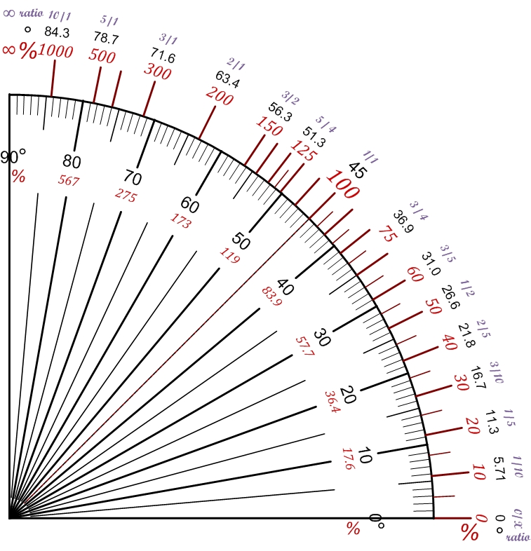

I run R4's on both my Kubota L4330 and on a very old Case backhoe 580CK. I would not use anything else because of the weight i often deal with and tending 'brush fires' etc. I do not use either when its raining or muddy because our soil would leave tracks for months, which it will even with turf tires on the zero turns. When you are going up a 45 degree incline with a full bucket or an 800lb mower and there is 17ft of water depth directly behind /under, you want all the bite you can get. at least I do.
by the way , which part of N. Texas are you in Texasmark ? i am in Waxahachie.
Case580ck, do you perhaps mean a 45 percent incline? A 45 degree incline would be a 100 percent slope. The vehicle you'd need for that would be a tram. :)
https://commons.wikimedia.org/wiki/File:pente-Slope_--Degres-Ratio_V1.jpg
