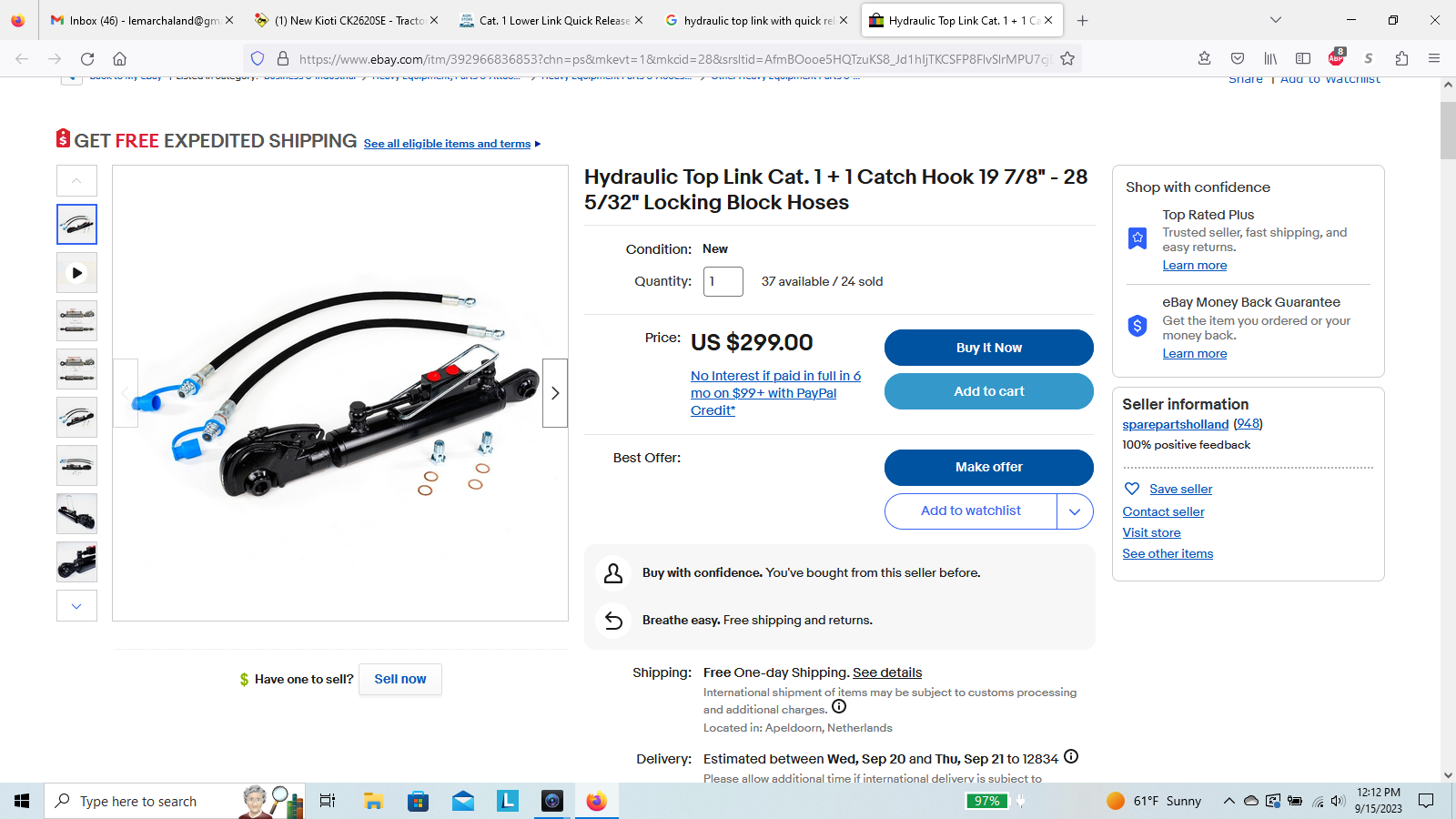

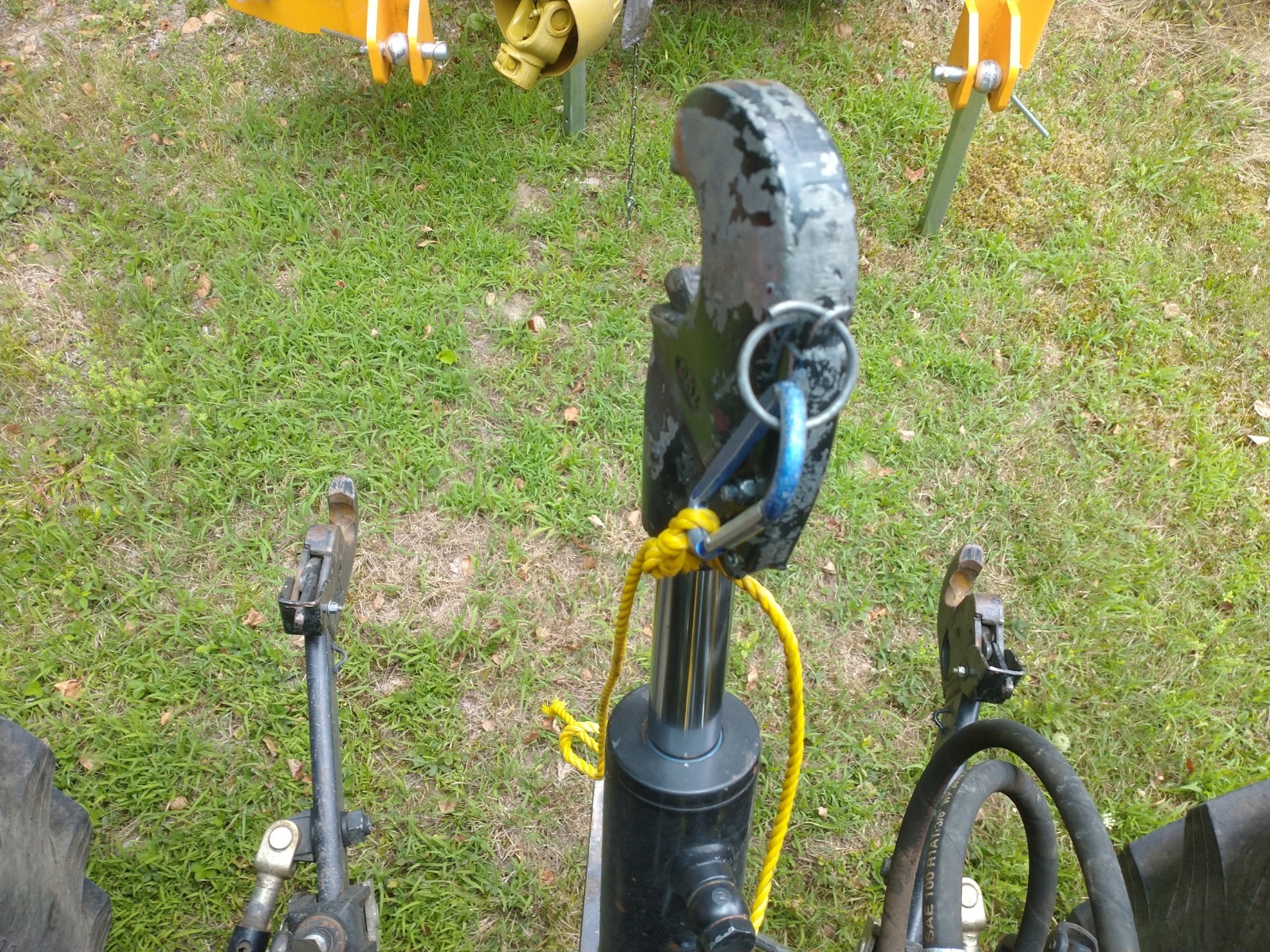

I've gotten spoiled with the quick hitch hooks on my 8050 including the quick claw top link. I would be tempted to go with something like this if the dimensions are good.
Because I expect that I'll be changing the lower lift arms from pin eyes to quick hooks sooner or later.
These are my preferences after quite a few years of messing with 3 points.
Edited to add;
I have a rope tied to the hook end of the top link, I can unlatch it, adjust to get it free, pull it off and tie off the top link. When I back up to the next implement I'll back in and lift to catch the lower hitch balls ( which stay on the implements as does the top link ball), once I have the lowers I can adjust the length of the top link till the hook will catch the top link ball. At that point my implement is captured and I can get down and lift any jack stands, hook up any hydraulics, pto (without a conventional so called quick hitch frame being in my way) or electrical and I'm ready to go to work.

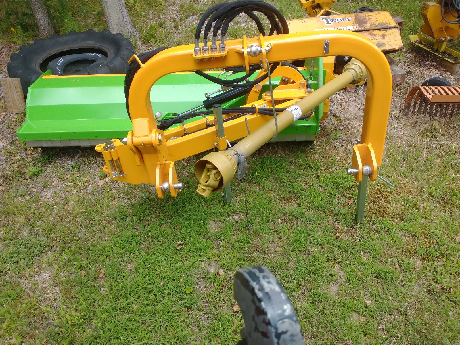

Sure this is on my Branson 8050 hooking up to my offset flail mower.
Backing up towards it,
You can see the hooks on the tractor and the balls that are left on the implement,
Backed in and one ball captured,
capturing the other lower ball, and lowering the top link hook towards the top ball,
Both lower balls captured and the top link ball captured,
All hooked up and time to climb out and start hooking up the pto, hydraulics, and raiseing the parking stands.
