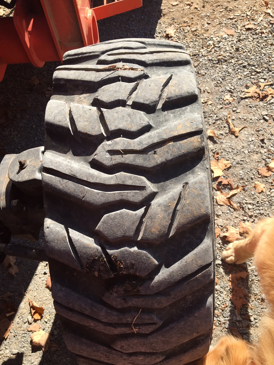

Been playing around grooving R4 tires to improve traction. See little road travel. Improved lawn/Pasture traction.
Used both wood carving disk on grinder and tire groover.

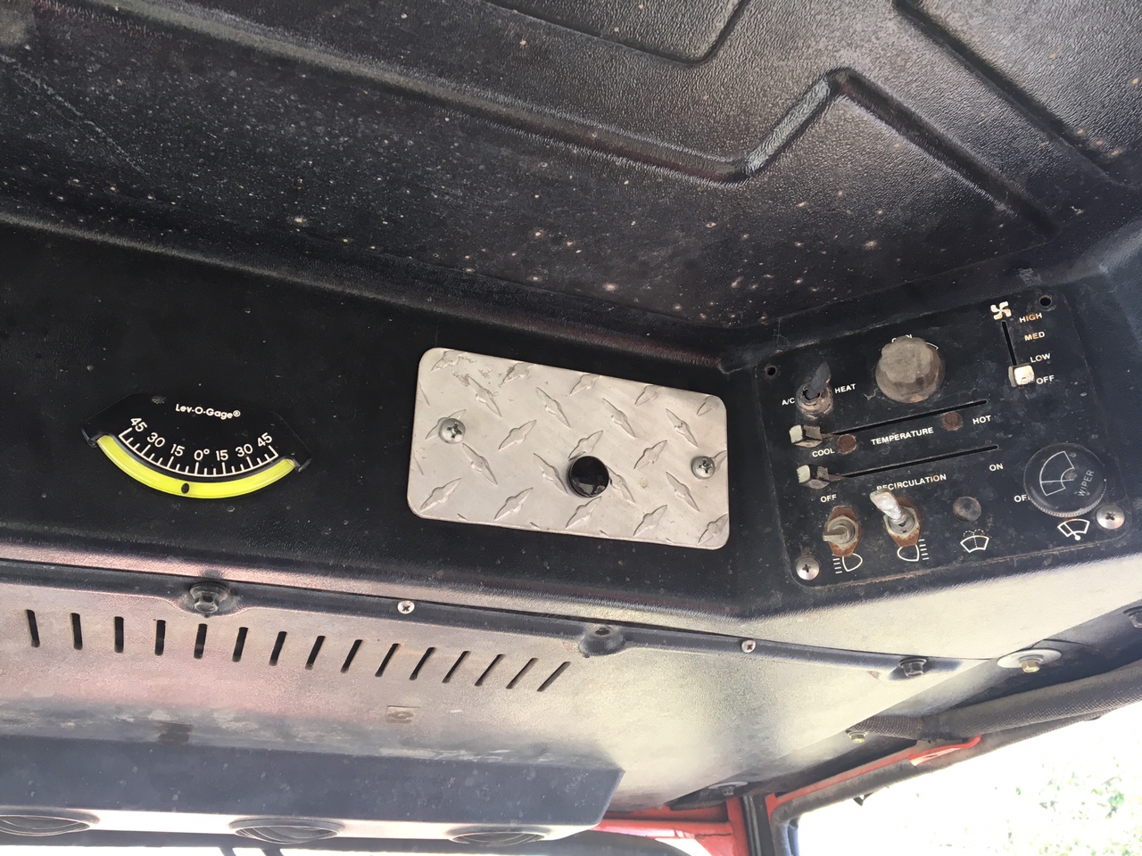

Have tilt gauges on tractors.
