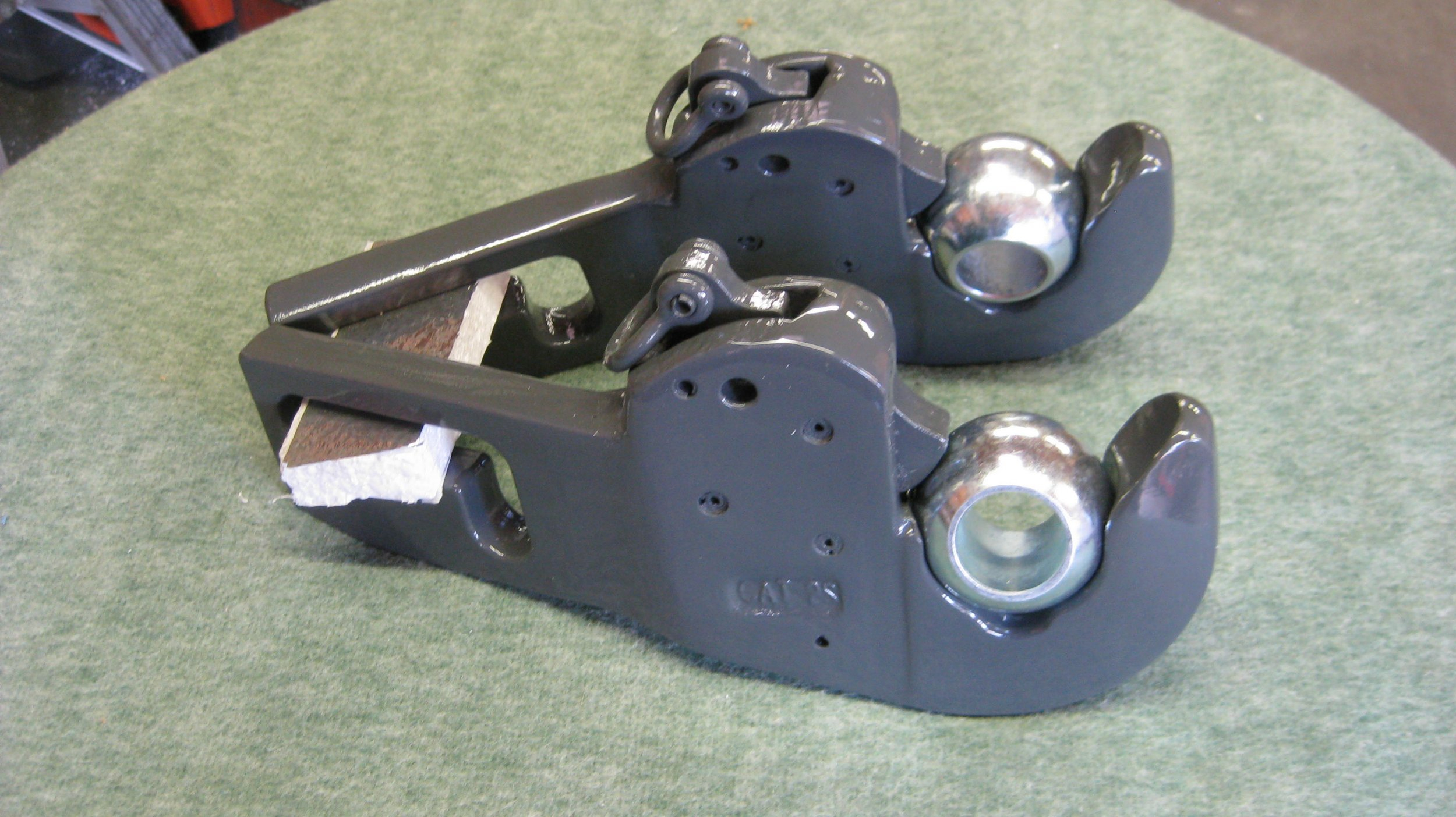

My issue is I have a jobn deere MX 6 brush mower with cat 2 pins and all my attachments are cat 1. I do not want to change the mower to cat 1 as John deere wants 275 for the kit. It appears that with your set up all I need are different balls and I can hook up to both cat 1 and cat 2.
   / Quick Hitch or 3 point extendable arms? #43
I can't remember if they make the balls for a Cat 2 hook with the hole for a Cat 1 implement though, but you can always get bushings for the Cat 1 implements and run the Cat 2 balls.
Just make sure there is enough space for the hook on the Cat 1 implements. These hooks are built to take a beating and therefore are somewhat bulky.
   / Quick Hitch or 3 point extendable arms? #44
My issue is I have a jobn deere MX 6 brush mower with cat 2 pins and all my attachments are cat 1. I do not want to change the mower to cat 1 as John deere wants 275 for the kit. It appears that with your set up all I need are different balls and I can hook up to both cat 1 and cat 2..
You would simply get cat 2 balls. Yes the cat 1 & cat 2 balls are exactly the same other than the ID for the different pin sizes.
The straight cat 1 hooks only have cat 1 sized balls that are a smaller OD. The cat 1-2 and cat 2 sized hooks take the same sized balls which are larger that the straight cat 1 hooks take.
As ptsg mentioned, you could very easily have clearance issues with full sized cat 2 hooks on cat 1 implements.

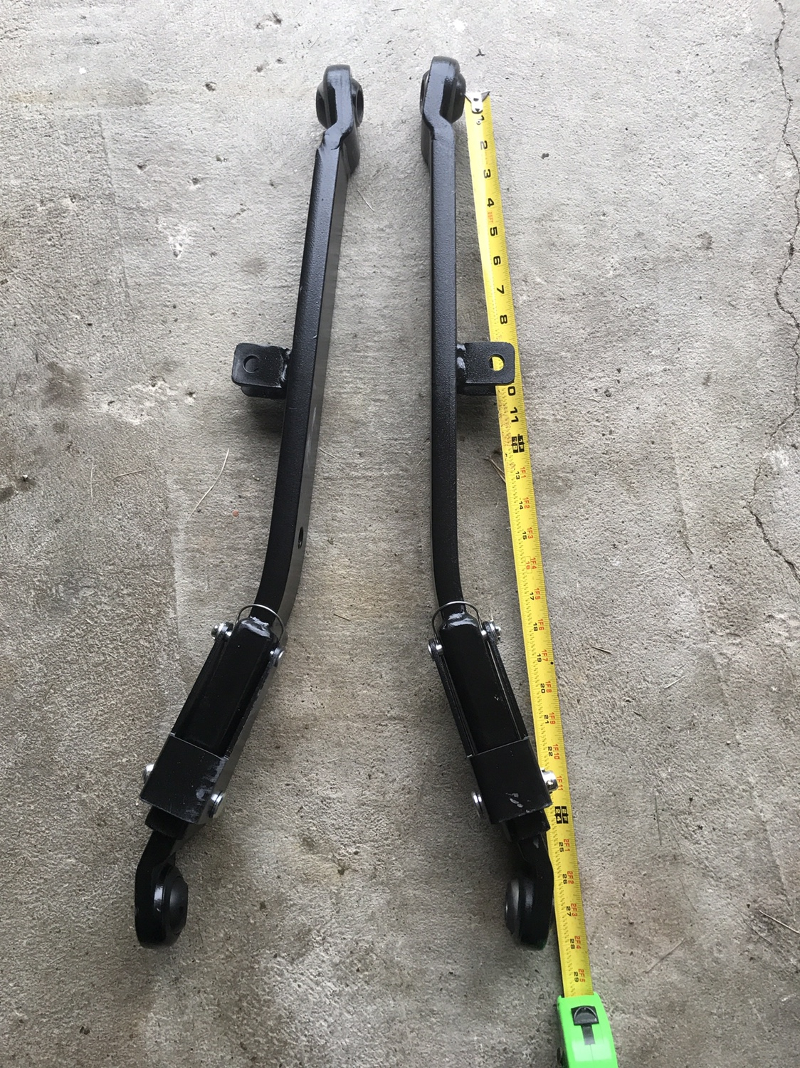

I picked up a set of these and will install tomorrow, they are also to work with the backhoe.

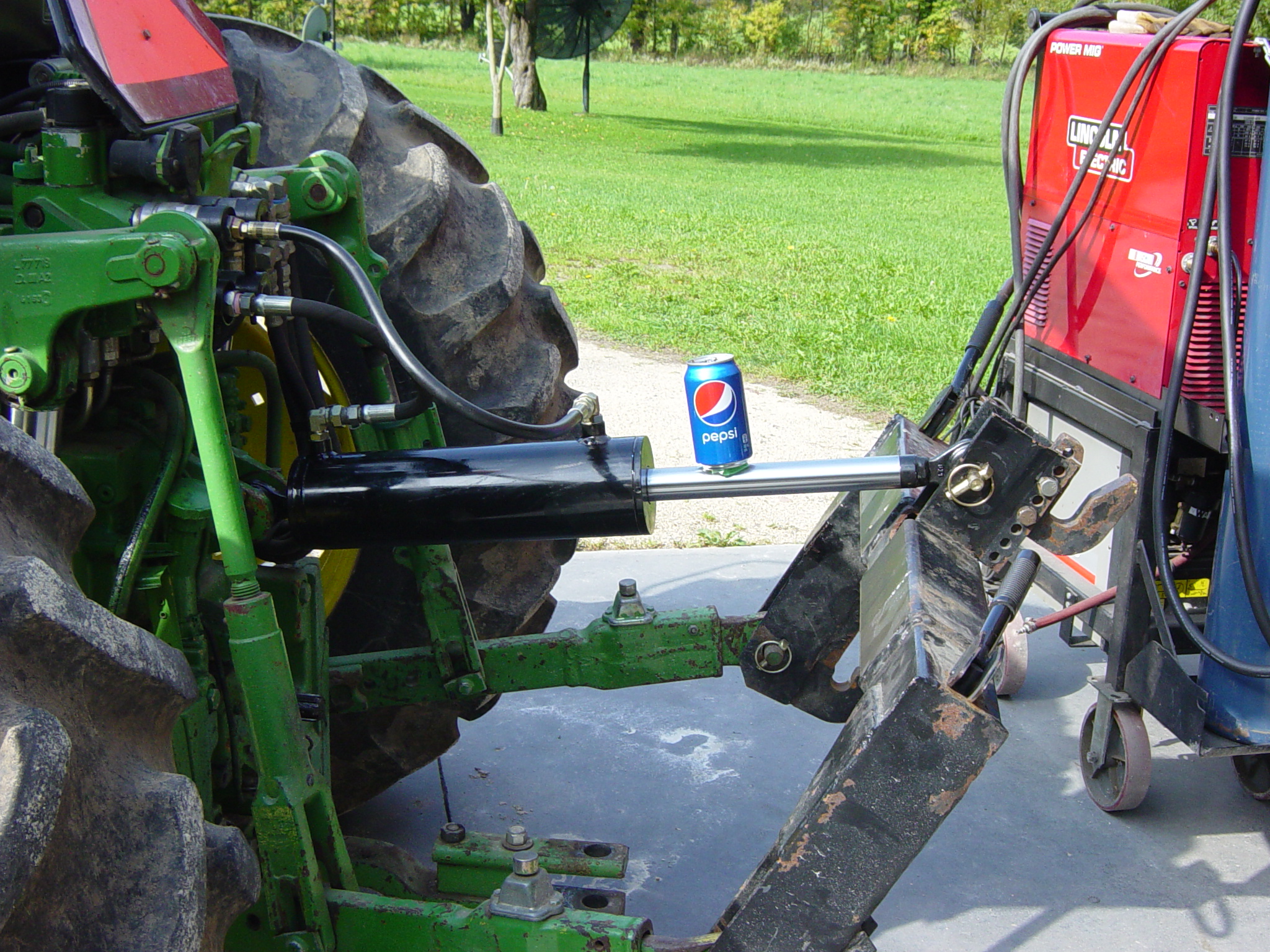

Here is a set for an L6060 that I supplied. :cool:
They are available for top links also. 👍
The last picture of the top & tilt set went to the tractor in the first picture with the draft arm European style QH.
I'm interested in a set for my New Holand TC35.
Do you make the extendable draft arm link with the hook? Also the hydraulic top-link with hook?

   / Quick Hitch or 3 point extendable arms? #49
Typically the existing extendable links get the ball swivel ends cut off and the Euro hooks welded on.
Yes I can-do build the hydraulic top links with the Euro hook, similar to the one previously pictured.
