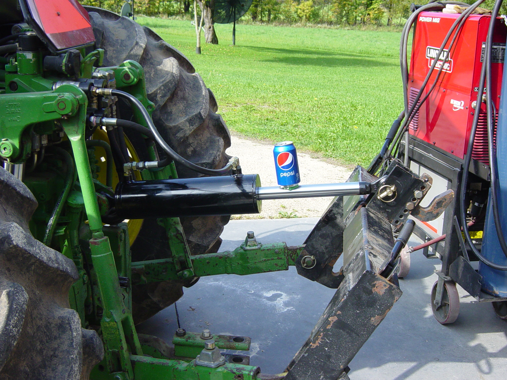

My quick hitch is garbage and light weight, got at a Richie Sale.
I had to modify it for width. But despite my lift capacity of something like 6000# and using it on my 8' Harley Rake, I have not managed to break it yet. Plus I guess, lighter makes it easier to put on and take off.
Oh, and the extendible arms were very useful, again, for implements you cannot move by hand. Sometimes though, getting them to lock back in is difficult.
That cylinder could hurt your tractor, bet it has 15-20 ton retract force.
