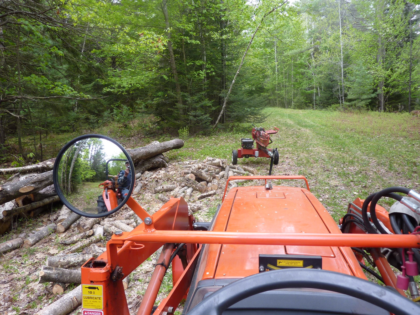

Old Square truck mirror mounted on canopy brace- works pretty good

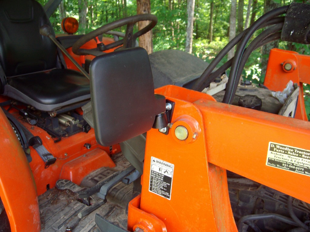

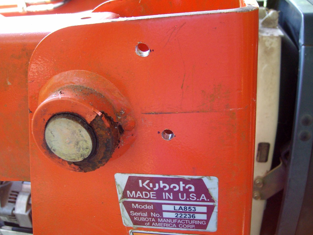

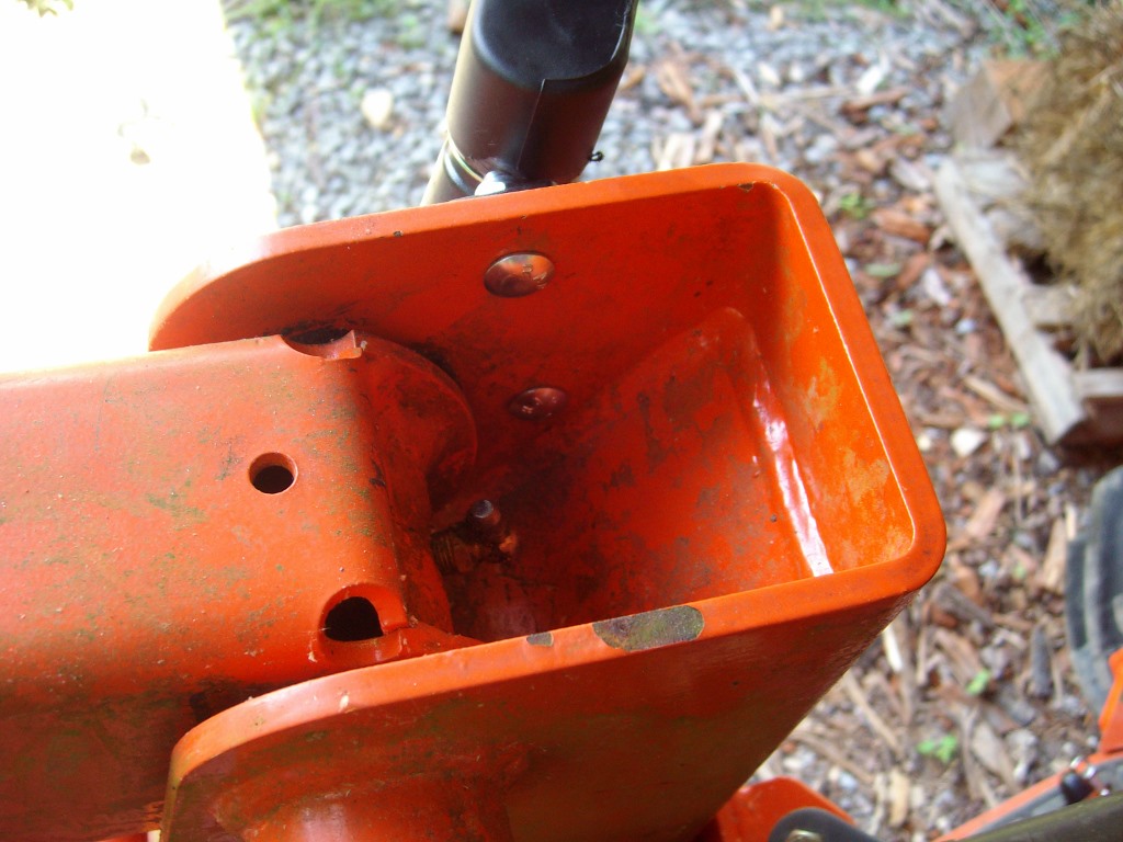

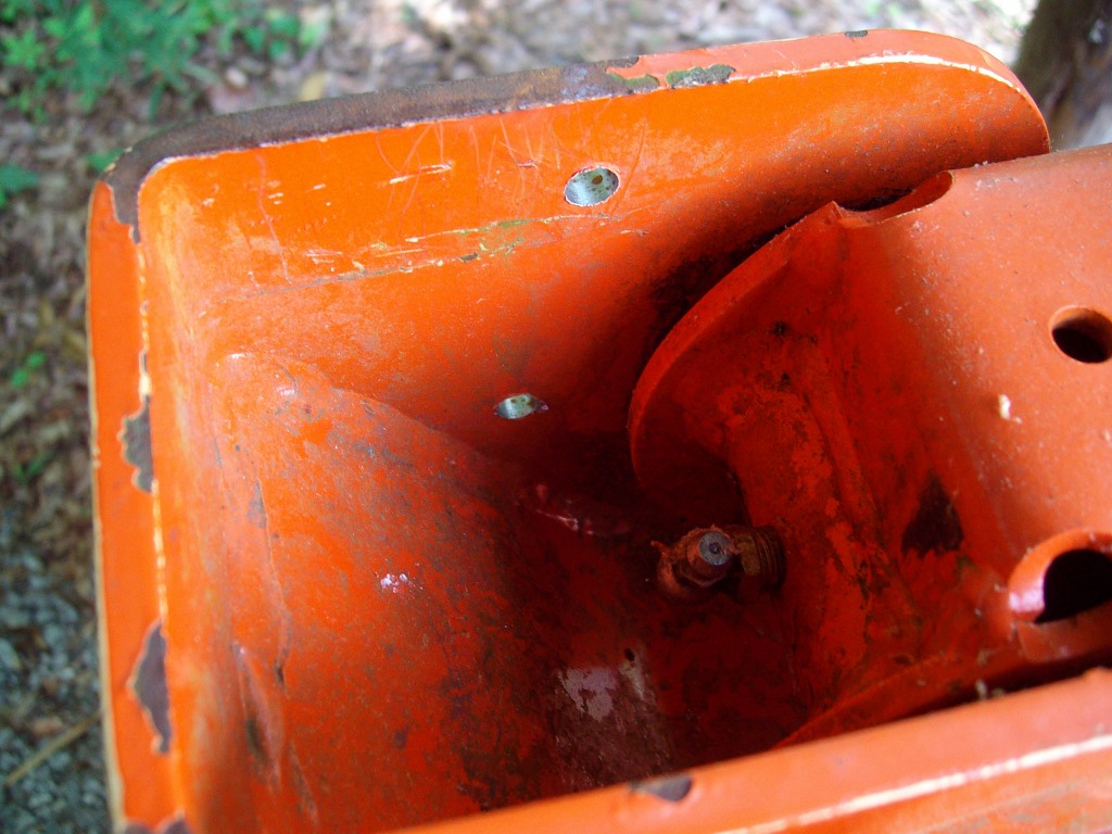

I bought a couple of cheap golf cart mirrors a while back and finally got around to installing them on the "towers" of my FEL mount.
Clamped the mirrors on temporarily with vice grips to get a good orientation that would allow for adjustment to suit both me and she-who-loves-to-bushhog. Drilled a pair of 1/4" holes in each tower. The "tilt" is a little odd-looking, but that's what was needed with these particular mirror brackets. Note that there's plenty of clearance and easy access inside the tower.

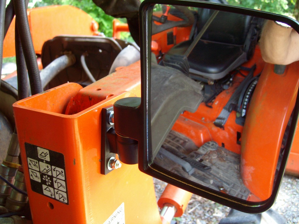

"Squared" out all 4 holes with a small triangle file so that I could use carriage bolts to insure good clearance on the insides. Note: be careful with the placement of the LOWER hole in particular, so that you can fit a carriage bolt head and your fingers in there.

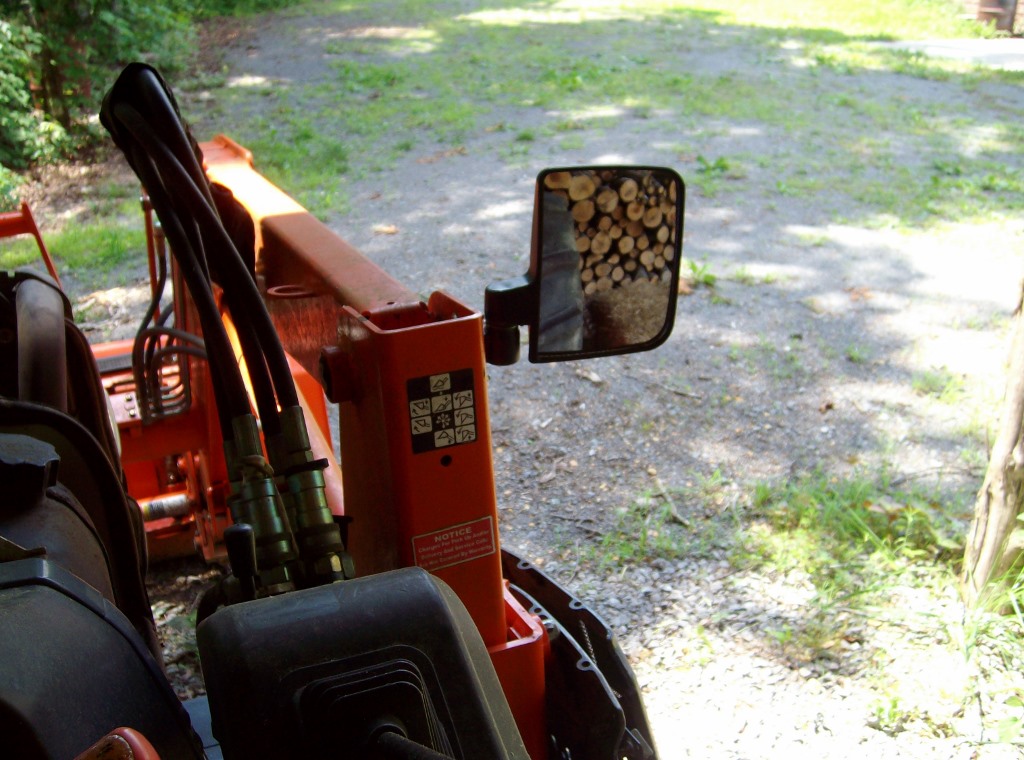

Other than the odd-looking angle of the mount holes/bolts, they work terrific. Total cost, less than $30.

Nice clean job...............also inexpensive!
