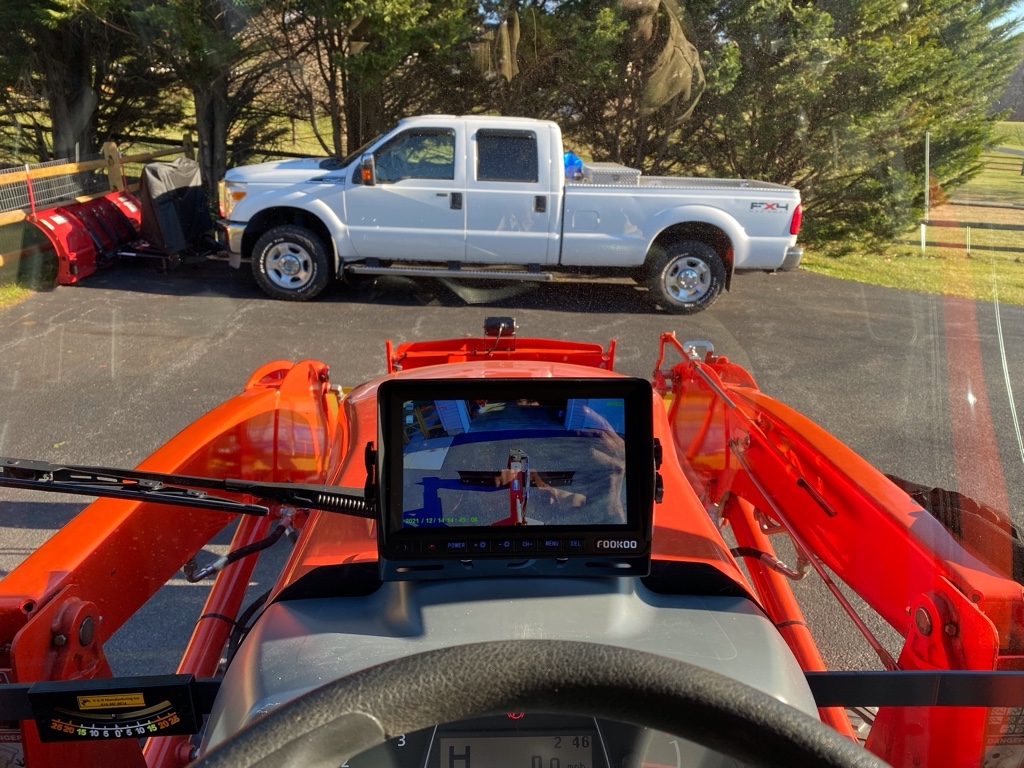

My rear camera does not get obscured while snow blowing, but I still prefer rotating the seat 45 degrees and looking over my shoulder.
If you try a camera, I recommend the wired type. They're more reliable and you have to get power to the camera anyway which is bundled into the video cable.

Where is your camera mounted? And do you have a brand/ model #
Thanks
Front and rear, mounted high on the rear of the cab, and front on the grill guard. I bought an inexpensive Chinese camera monitor set from Amazon like below...
