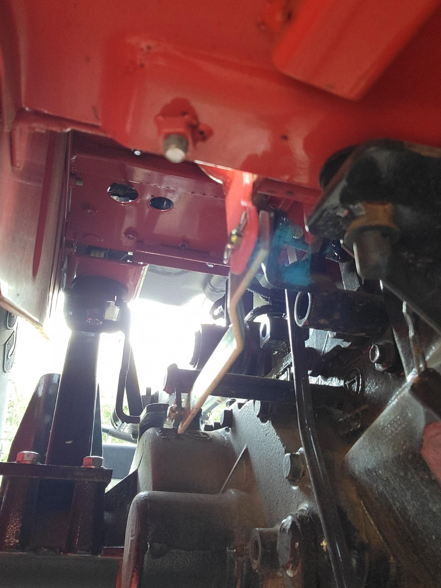

I have seen plenty of issues with the CK diff locks and bent linkage. Maybe it is time for some re-engineering?

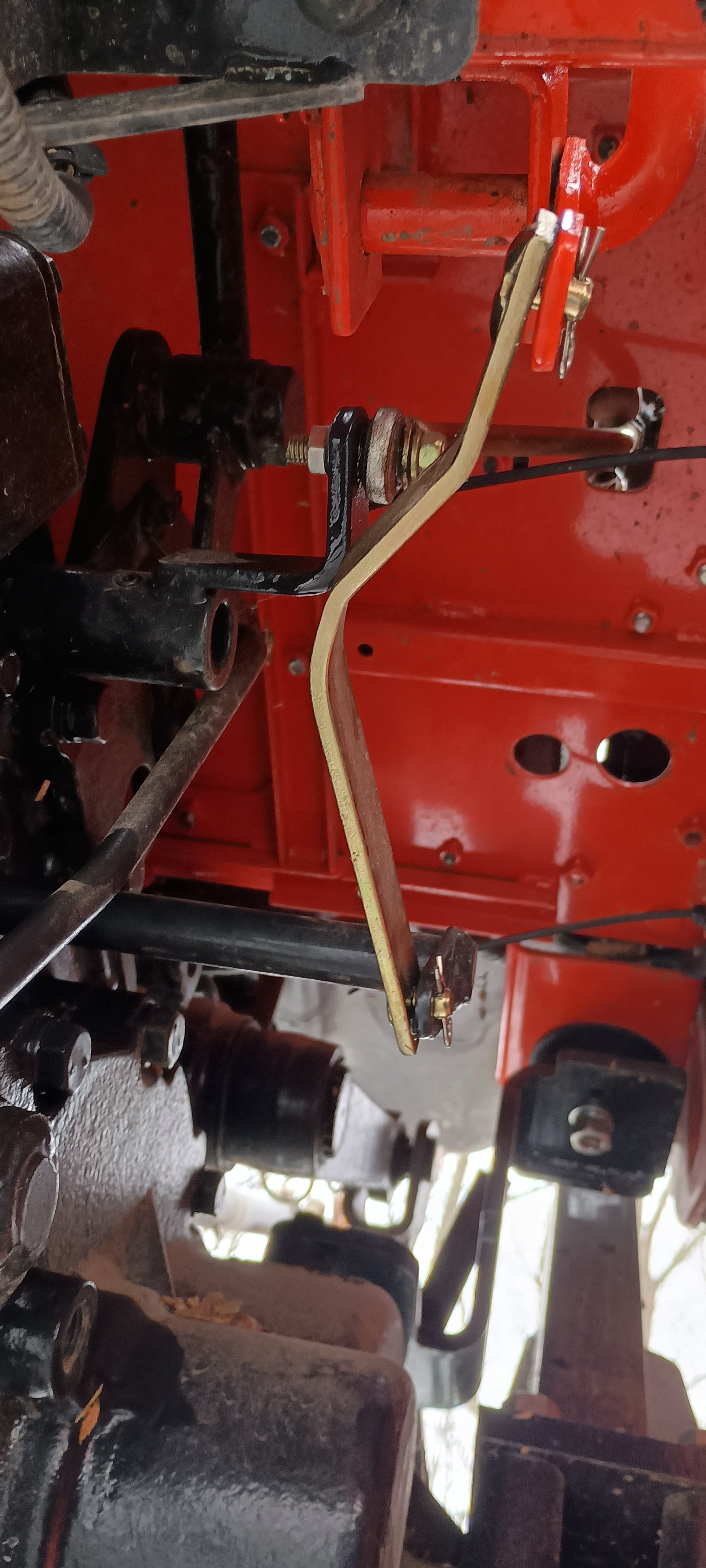

It sure looked odd when I looked up there, definitely not an efficient design with that offset.
Looking at my pic now it appears a little tweaked on the ends
/ Diff issue or too long since I've plowed?
#22
Looks like I can call this one "been a while since I've plowed".
Slightly above freezing today so went out and started the tractor, while it was warming up I marked the LR rim/tire and hoses down the linkages with PB blaster.
Put in in 2wd and tried to push a snowbank back and immediately LR spun. Went to reverse, RR spun. Tried the diff lock (still too stiff IMHO) and got them both to spin. Was trying to come slightly uphill so I expected to slip
Engaged 4wd and backed out. The diff look is not smooth, but it never had been. I'm assuming the bend is factory, but damn this looks goofy:

That looks much better. Be sure to spray a bunch of penetrating fluid where the diff lock pivot shaft goes into the case.

Ya, that linkage is definitely bent. As is the tab on the foot lever. You can bend it back into shape but it also can't hurt to ask the dealer for a new one.
Question is though, why did it bend?
Yep, when I first look at the other pic I thought it was a different tractor, but now I see the 4wd linkage. Image looks reverse for some reason, but shows mine is bent
I Can vaguely remember having an issue getting it engaged so I put some weight on it. I'm guessing it was stuck and I bent it.
Need to look at some PN and then reach out to dealer.
/ Diff issue or too long since I've plowed? #27
Almost looks like something round went in there just past the 2nd 'bend angle'. Large stick/branch maybe..?

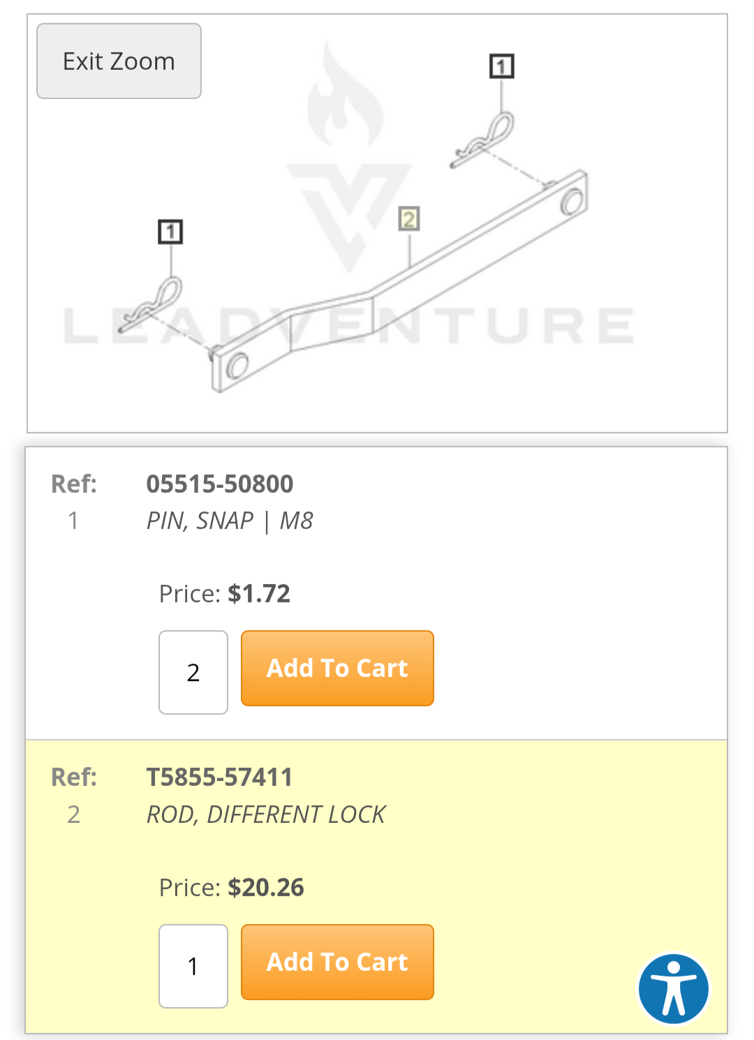

Searching MIE for the closest tractor, looks like this is the part:

Old vs new
Actual diff lock is still locked up though

I can say 2 things though:
1) 20F is not the time to be messing with this outdoors
2) I definitely bent the linkage with my foot. Laying under the tractor and reaching up to push the engagement I can get enough flex in the new linkage to clearly see this will bend
