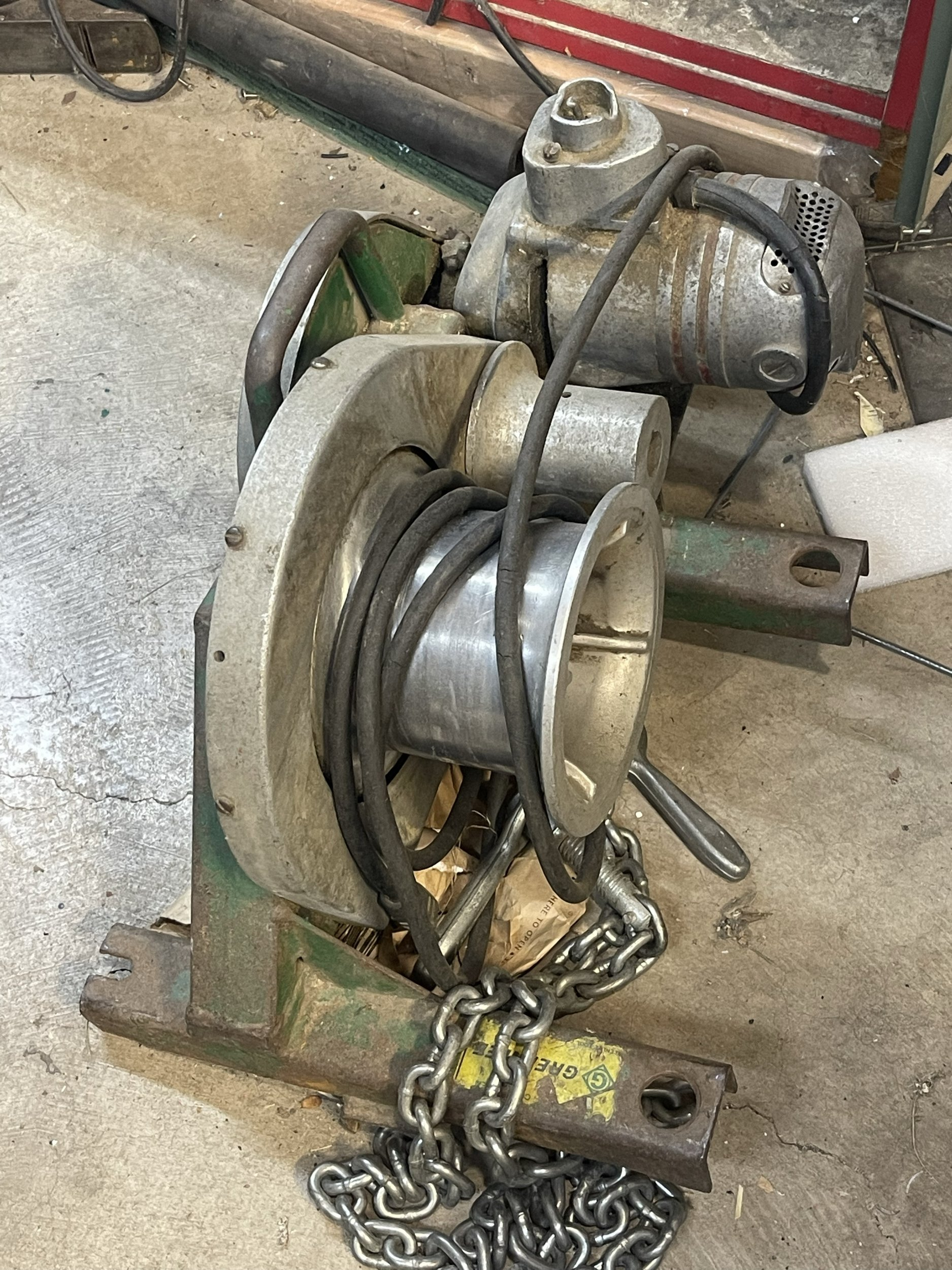

My preference is for the Chinese finger trap type grip, and a pull rope. Lube helps a lot, and for big gauge wires the trusty Greenlee puller to pull the rope.
/ pulling wire through conduit #40
Those pullers are great. Used them loads of times. Just keep the idiots away from trying to pull 12 - #10 wires thru a 3/4” conduit. 😍😂
