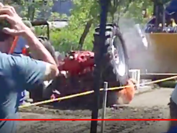

On the 8N, I don't see any sign of a low drawbar. I looks like it was hooked high.

I paused that video there too. I don’t know much about those old Fords, but it looks like there is a spot for a swinging drawbar, but nothing there.

go back to post 140, click on the link, and watch how DIFFICULT it is to flip a tractor over backwards.

The gist of what CalG said in post #171 that effective pivot point is not always fixed .. again what I've offered in support .. and what Moss asked to be clarified in #173 (... and for any who haven't read/processed every post in this thread) ...
Playing 'by the rules' here, (hitched below the axle, no?) suggesting that there are other forces/vectors/axes at play than only pulling the front wheels down by hitching point location ... (also level ground, wheels not chocked ...)
Is this proof of magic? :confused:
