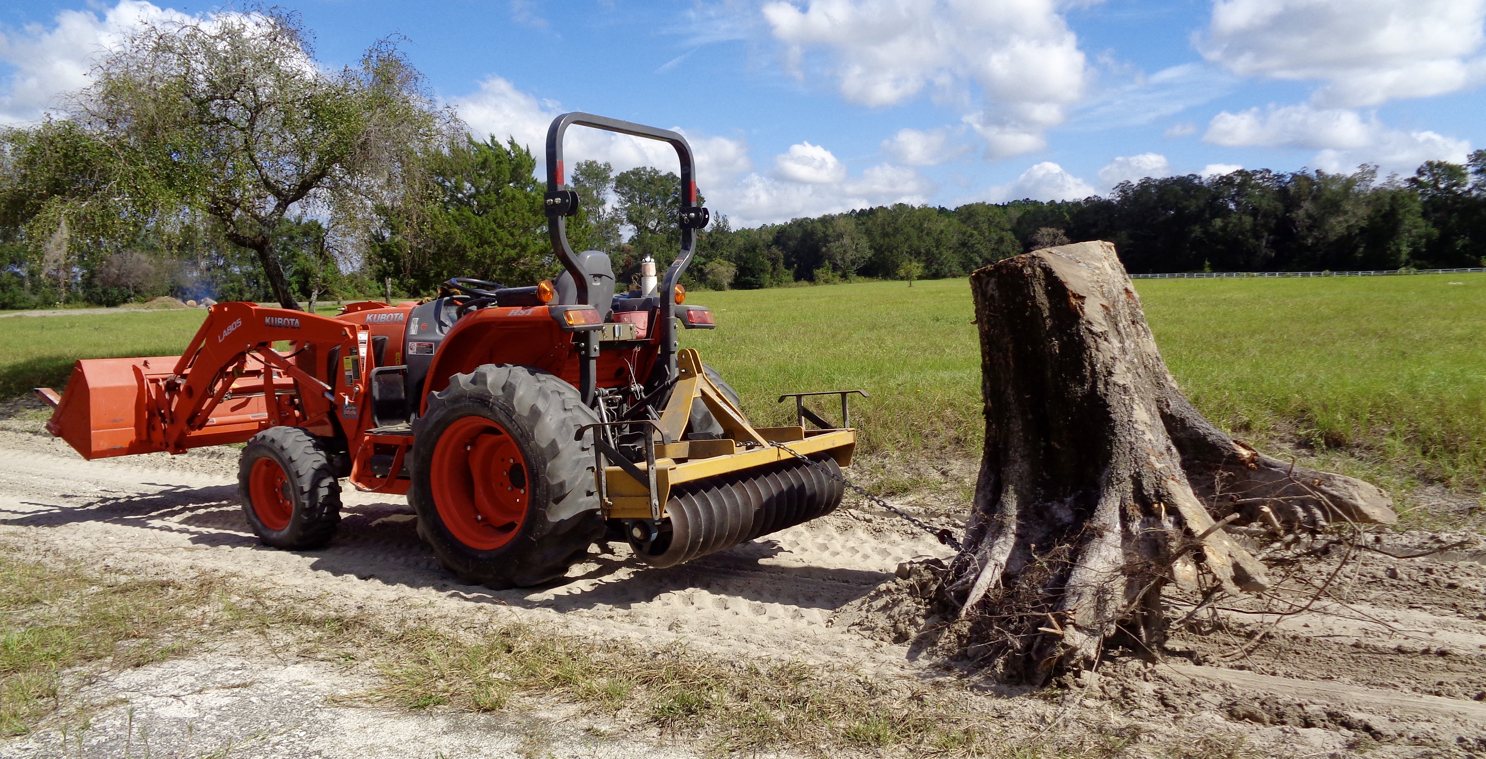

/ Pull from the front or the rear? #8
Pull from the drawbar.
In the pic in this post, the chain may be attached to the draw bar, but by going up and over the implement, the effective point of attachment is actually above the rear axle (assuming the implement remains where it is, though it can't go a lot lower and avoid ground contact).
100% true.
I was in HST PLUS/LOW/LOW with quite a bit of throttle, moving very, very slowly, over known sand where load would not hang up on something fixed. I had to lift front of the stump a tad to keep from plowing too much sand, stopping progress.
