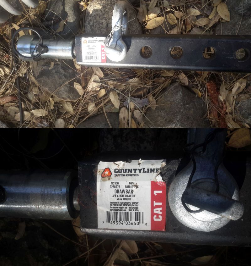

Stands to reason that someone would also misuse those ventilation holes in a 'spreader bar' and mislabel it to boot.

And yes I know I have used linch pins instead of driving in roll pins to lock adapters on, but I am not sure adapter are going to stay with this "xxxxxxx bar"

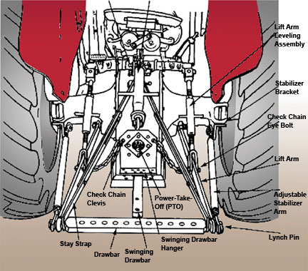

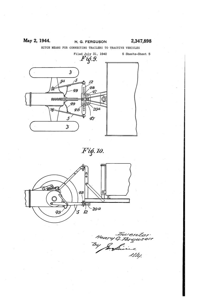

The 3-point drawbar was part of Ferguson's patented hitch system for transferring trailer weight to the tractor for better traction. I didn't notice any mention of it in the hitch patent, which was mostly about the draft sensing.
When the 3 point hitch first became available, almost all older implements were pulled, not carried. The implements usually had a clevis hitch. The 3 point drawbar (with stay straps to keep it at a fixed level) was convenient for these implements, and also allowed greater vertical angle in dips and ridges than the fixed or swinging drawbar and clevis.
Bruce
BCP you added the best info of all and got ignored. I like it.
I grew up with several small Fords. We had one 8n with the stubby drawbar that had nothing to do with the 3pt.
Others used a extension drawbar that laid on top of the 3pt crossbar with a clevis. I had though that the extension was just a scrounged up part but I saw very similar pieces at times so maybe it was a Ford part.
As mentioned, that setup made use of the stay straps to keep the 3pt from floating.
As far as the crossbars having several holes I think that goes back to the earlier tractors. Most had cross drawbars with several holes. There was even some equipment that mounted to the tractor using those cross bar holes.
We used a Minnesota brand sickle mower that had a similar crossbar. That crossbar was bolted to the tractor crossbar, a bit of a hassle in all.
That was why the mower was left on that 8n all hay season.
A swinging drawbar could also be used to offset the tractor tracking to the equipment tracking (plowing with the tractor tire in the furrow).
Farmall in particular used a floating drawbar on the crossbar using rollers. I remember looking at those Farmalls not understanding the point of the rollers (my family didn't know either). I was at an auction or something and brought it up. A oldtimer told me that the floating drawbar was used to help the tractor turn in the field. The tractor would start turning and the drawbar would slide to the inside of the turn, a big help especially with disc's that weren't raised for turns.

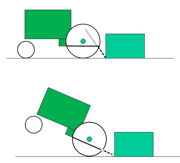

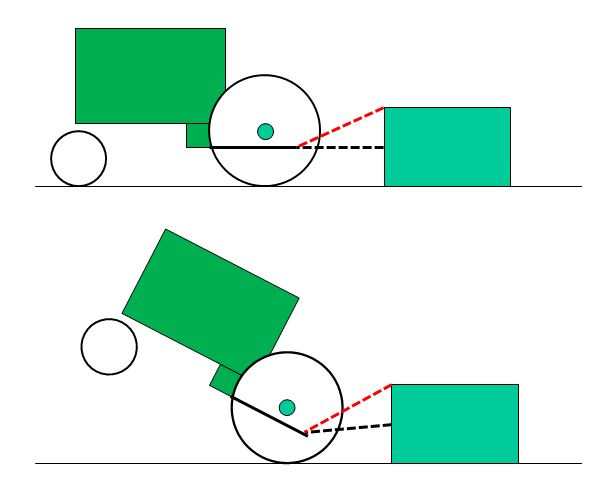

Vectors also change as the rotation begins, and if the 'anchor' (load) is hitched above the axle centerline the wheels will most certainly move forward as part of that change. Point being that we shouldn't assume that pull (tire contact) and load are immovable at all times.
Problem comes if when hitching below the axle we assume that wheels could slip but then not still exert that rotational force while skidding slightly backward. If wheels couldn't move with either hookup the vector guys would be validated.
There are things that make no sense at all to most of us. If you've ever pounded a workpiece already tightened in a vice down onto mill parallels or against tightened lathe jaws to square it up you know what 'bounceback' means, and understand why the dead-blow hammer is often essential to setting up precision work.
btw, I've been to college too, and there is a difference between having all one's hands-on 'lab' assignments suitably graded '100' and watching them lose a finger doing a sloppy setup on a machine that hasn't even been to kindergarten or understands vectors when it 'crashes'. A degree is a piece of paper denoting educational vs 'field' experience.
/ Pull from the front or the rear? #128
Claiming that pulling from below the axle can't pull the tractor over backward ignores the real-world wheel hop that will occur when nothing else gives way. 'Climbing the ring gear' as the old timers described the vector forces in terms they understood, is quite possible if the drive tires are bouncing.

The forces would be extreme. But you don't need vector analysis to imagine the scenario where the rear axle can't move forward (due to the drawbar chained to an immovable object) and a mechanical driveline continues to send torque to the rear axle that has perfect traction. If nothing breaks then rotating the tractor up and over backward is inevitable. I suppose if the drawbar extended out beyond the tires and didn't bend then the rotation would end when the weight of the tractor rested on the tip of the drawbar so the tires lost traction.
I don't think this completely accurate. At the point where the nose of the tractor is straight up in the air, the drawbar has rotated down. Since it starts below the axle, we have now rotated it further below, but also in front of the axle the same amount that it would hang below the axle normally. The object is immovable, but that distance had to come from somewhere. The traction is perfect, so it didn't come from slipping the wheels backwards. The chain presumably didn't stretch, either. However this also illustrates the position where the only place the drawbar can go to allow the wheels to move forward is to rotate backwards again and bring the front wheels back down. The only component left is the engine; my choice here is a stall.
