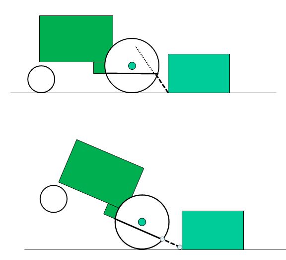

It is a simple vector analysis. Sum of the moments must be zero or the tractor will flip over. Pivot point is where the rear tires meet the ground. Opposing moments are tractor CG in front of that pivot point. Opposing that is pull at height above ground. Using English units assume CG is 2 feet in front of wheel contact point and tractor weighs 5000 pounds for 10,000 ft-lb moment. Assume drawbar is 2 feet above ground level. At 5000 pounds pull which is 1 to 1 coefficient of traction, possible with tractor tires, the front wheels lift off the ground. If the hitch point is 2 feet behind the tire contact point assume it drops to 1 foot as the tires lift. The CG will only move back by the cosine of the lift angle. Or now 9,000 foot pounds trying to hold it down vs 5,000 ft pounds trying to flip it over. When the drawbar hits the ground the flipping moment reaches zero. Centerline of the axle is not involved. When a free body diagram is drawn the outside forces acting on the body are the ones that are involved I.e the ground contact point and drawbar height, distance behind the ground contact point to the hitch point.

It does not matter whether the point of attachment is above or below the axle. It matters how high it is above the ground. Lower is better. The drawbar pulls backwards and the bottom of the wheel pulls forward. This produces a torque on the tractor that could flip it over backward. Next you have to know where the center of gravity is of the tractor and the tractor's total weight. Then do the math or do the experiment. With a little luck the wheels will slip before the tractor flips backwards.
Does that analysis include the torque that the pinion gear is exerting against the ring gear?
Those Forces are COMPLETELY taken out internally. You know, Cast iron, with bearings and the like. The TIRE contact is the ONLY resolvable force. Don't get confused, The pinion cannot climb the ring! It can only apply a force. If not reacted upon by the TIRE contact, There is nothing....

So the tires will lose traction before the tractor is standing vertical even when the drawbar isn't long enough to reach the ground at any point? Seems to me the resistance to going over will lessen, not increase, as the tractor approaches vertical.

Tires losing traction is not in my play book. I'm not sure where that theme comes from.
What is wanted, is a lever arm that opposes the turning "torque".
Imagine a lever arm EXACTLY the same length as the tire Outside radius.
The tire turns one way, the lever arm opposes.
Could the tractor over turn by tractive forces alone?
No inertia etc.?
No! It could not.

When a tractor turns over backwards when pulling from a fixed draw bar below the rear axle, the axle of the tractor actually moves backwards (towards the immovable object) as the tractor rotates around the tires. The rear tires aslo roll backwards towards the immovable object. When this happens, it happens very fast because the tractor is rotating around the rear tires while the rear tires are rolling backwards so that draw bar (where attached to the pulling line) stays the same distance from the moving object as it moves down and forward with respect to the rear tires.
This can and does happen. I've seen it happen with a John Deere Model A. Big Ag tires, and a light front end (typical old field tractor design) makes it very possible to roll over backwards when pulling from the draw bar below the axle.
Small diameter R4 and turf tires and much more forward weight distribution make this scenario all but impossible with a modern CUT or SCUT.
Now if you pull from the top of the ROPS, you're likely to lift the front but it will lift very slowly so it's easy to react to. If you pull from the fix draw bar below the axle you are unlikely to lift the front and even less likely to roll over backwards, but if it does start to happen, it will happen very, very fast. To counter this, when pulling from the fixed draw bar, pull very slowly.

As CalG says there is no actual 'climbing a ring gear'. (post #152) The term is folklore and figurative, as if whether the wheels wouldn't spin when a tractor would/did flip over backward by 'climbing'. Still, I wonder about tire slippage 'or not' ...

It is important to note that the "rapidity" of the over turn is proportional to the load.
A rather light pull at the ROPs will turn the tractor over rather slowly, while a very STRONG resistive force near the axle location will turn a tractor over backwards quite rapidly. (or restore equilibrium at some :front wheels off the ground attitude)
Back to vectors.. they have both direction, and magnitude!

Basic physics - even known when I got my engineering degree and available through every states dept of agriculture. Modify your tractor so the coefficient of traction approaches infinity and it’s going to flip backward. The diagram I posted is from a basic tractor engineering book. Pivot point is bottom of rear tires. Multiply force times lever arm to get the opposing moments. Pull times pull height is opposed by mass at CG times lever arm. If the traction is poor the pull cannot reach the point where the front end will lift. If the traction is high the front end will lift, just like shown in all these tractor pull pictures. Same thing in the picture I’m sure everyone has seen of the driver who chained logs to his wheel. Every time a log hit the ground the tractor front raised.
