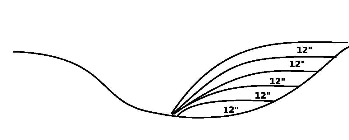

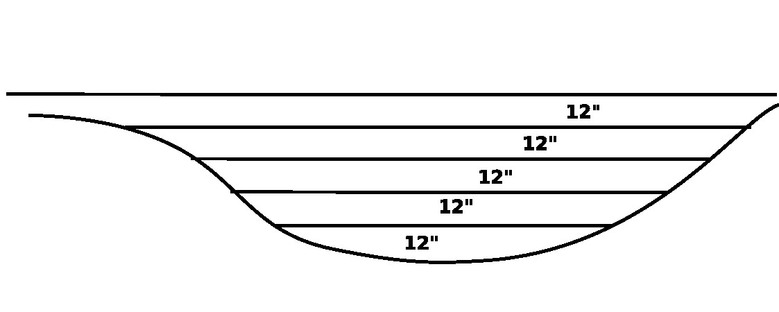

If you do think you might want to build a detacted garage or something in the area in the future; you really want to scrape the top soils off (and stock pile), along with rocks and clay; and place a clean, well draining sandy soil.
/ Pull behind roller/compactor for Kioti DK6010SE tractor? #22
In "slope fill 1" section; I wouldn't feel bad about having rocks and clay in the bottom 2 lifts; as your top 3 lifts would be fine; once again, assuming we are talking about yard/landscape area.
You pretty much want good material atleast 4 feet outside of any foundation.

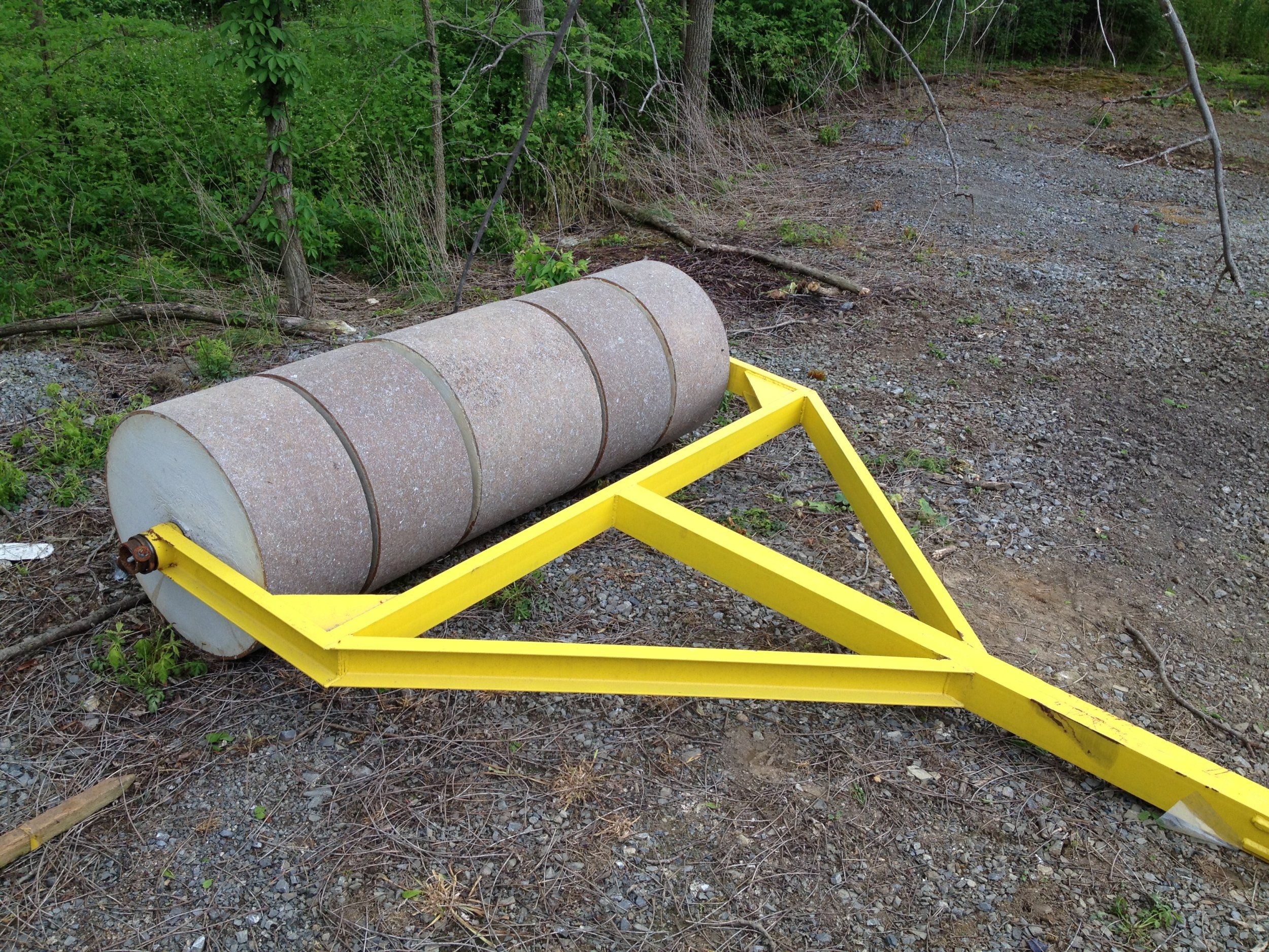

5) a 48-60" long, 30-36" diameter steel drum filled with water or concrete, and many passes
6) a traffic roller type set up; including one's that pull behind a medium sized tractor; most have a water or sand tank to add weight; the rubber tires help prevent bridging over soft areas

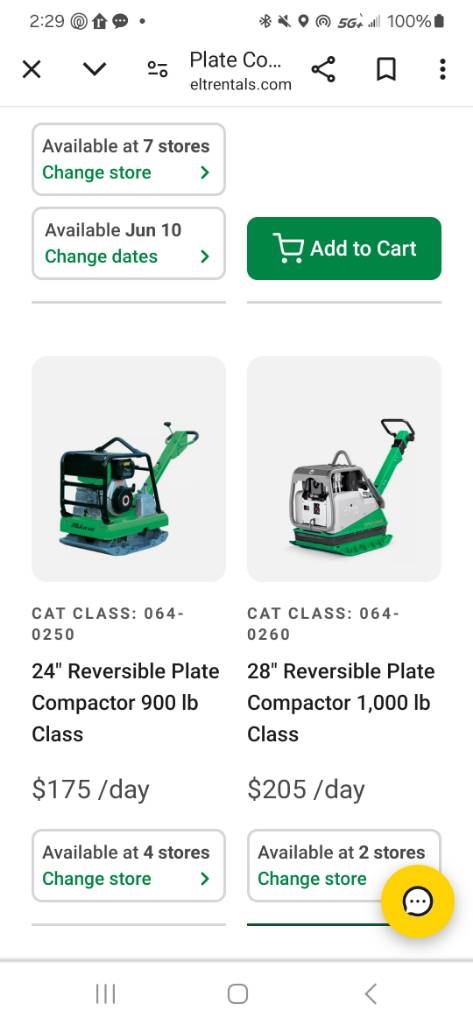

You mentioned a plate compactor in your post. Would that be referring to something like this? I could see using this in multiple applications. Driveway and pads for storage shed, portable timber mill, etc...
/ Pull behind roller/compactor for Kioti DK6010SE tractor? #26
Yes, although I don't know about that specific one. Some are reversible, and are more or less self propelled; some weight I. at 500# of so; while others might be 120#. The small ones honestly don't do that much for compaction, but the large ones certainly are capable. I dont know that it good faith I'd recommend them for landscaped backfill; for a couple reasons;
1) $700 is a lot of money that might be better suited to a rental
2) you mentioned the time/trips involved in wheel compacting; this probably covers less total square feet than your tractors wheels; and makes multiple passes.
3) they are a Lot of work
/ Pull behind roller/compactor for Kioti DK6010SE tractor? #27
From HFs own reading; 9500 sq ft per hour. That's Optimistic. I would say 4000 sq ft per hour. If we are doing 0.25 acres; that's 2-3 hours of plate tamp time per lift. If we are doing more like 0.5 acres; your going to have something like 20+ man hours in compacting those 4-5 lifts of fill.
With a loaded bucket of fill; your DK should probably be putting something like 1000#/sq ft of pressure on the fill with front tires; and something like 250#/sq ft with the rears; but covering probably in the neighborhood of 4 sq ft of area per linear foot of travel. You can handle mounds, slopes much easier too; all from a seat; vs dragging a 500# tamp around, and still needing to drag/level the area with the tractor.

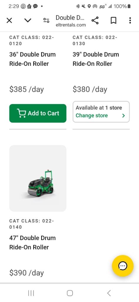

Dang; Sunbelt is expensive on compaction equipment.... and even with a roller; you would probably have 2-3 days of rental min

Yes. Rentals up in this area are crazy. I've watched recent YouTube videos where people were renting for half the price(might be a bit of an exaggeration). As for the plate compactor I was only thinking of buying because there is a 400 ft driveway that needs compacting when it goes in, the parking area in front of the garage, the gravel under the slabs for the home and garage, and some other miscellaneous areas. I am guessing I could get away with the tractor in the more open areas but inside stem walls/footers it is probably going to need be a plate compactor right?
