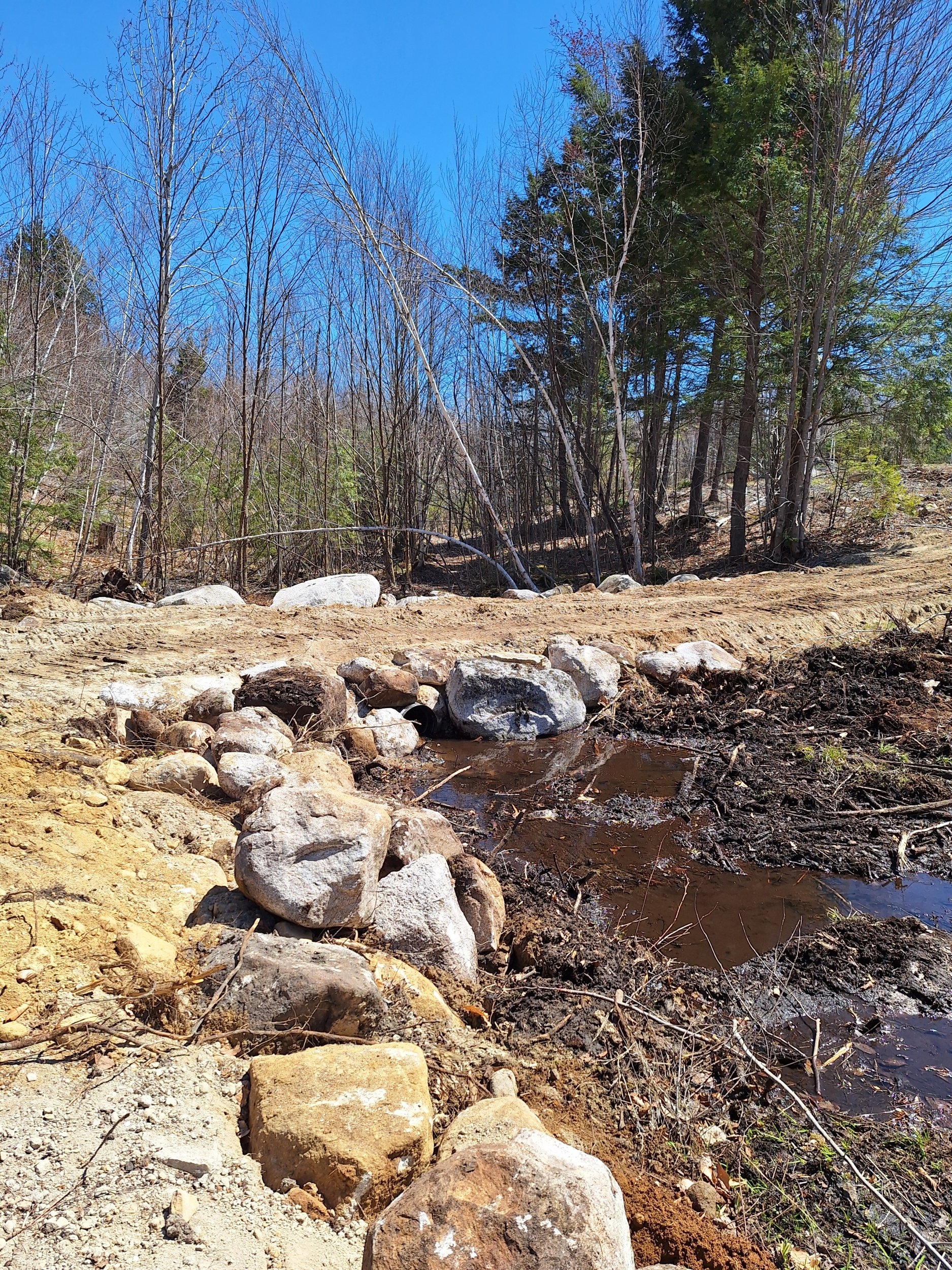

Surly you have or can find some big rocks to place at the "toe" of your slope. That's how I get rid of my big rocks.👍

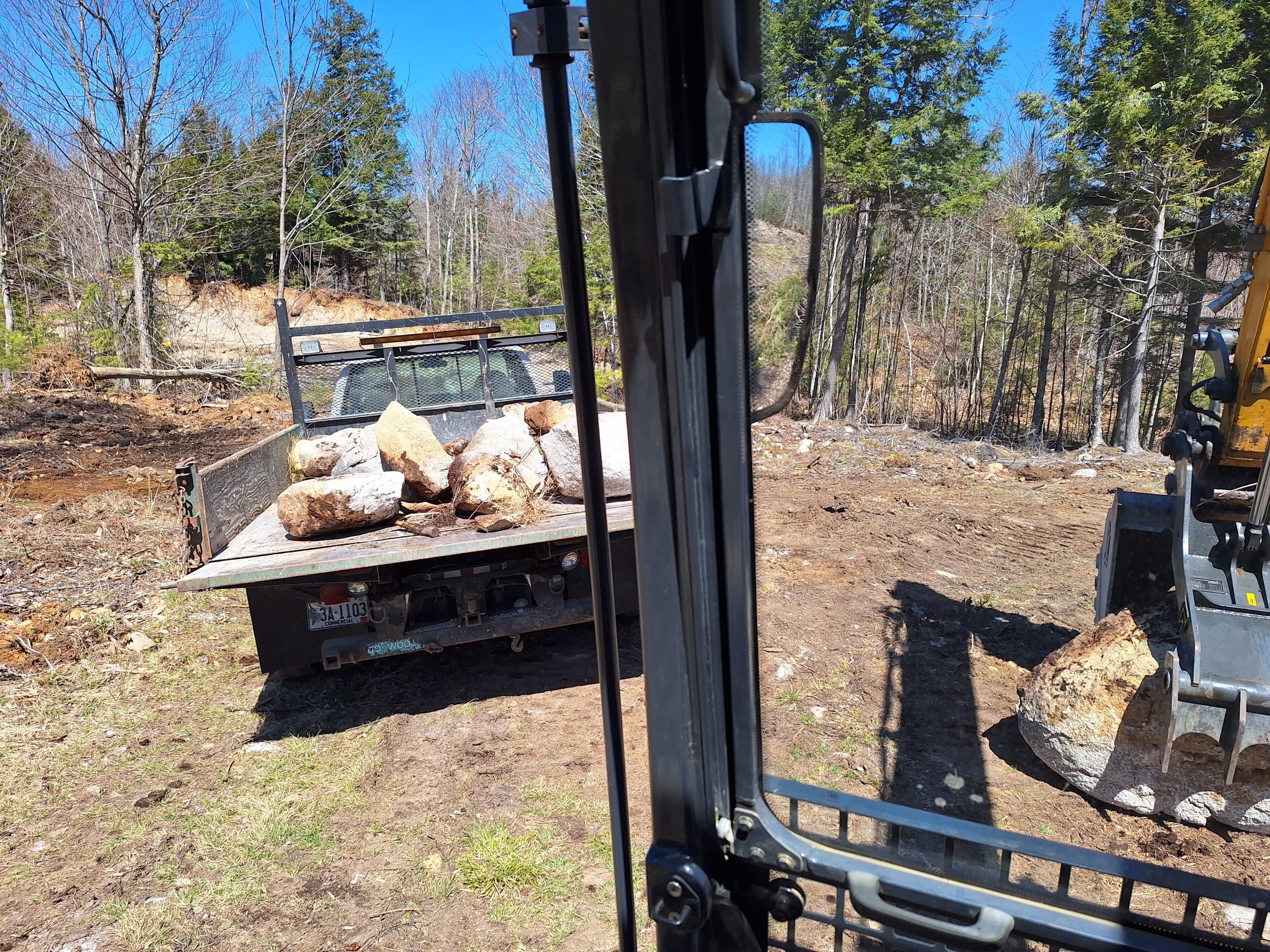

Yes. Plenty of large rocks but those are being saved for rock walls and stepped retaining walls on both sides of the walkout

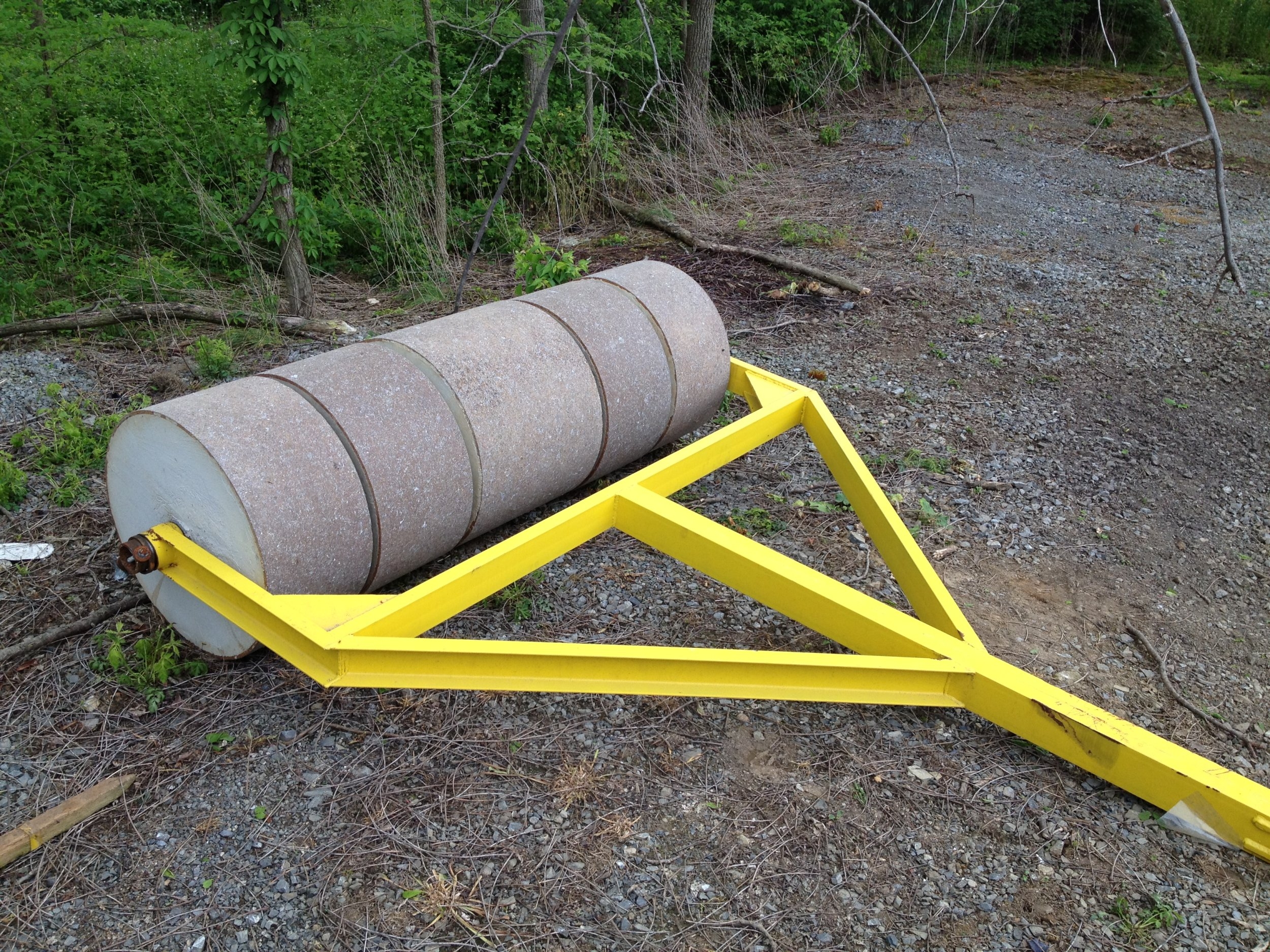

We made a roller at work several years ago to compact millings. It sorta worked, but I rented a vibratory ride-on that worked much better. I brought it home one Spring to get rid of a bumpy section of yard. It wasn't worth the effort. Didn't do diddly.
It was plenty heavy, but the PSI apparently was not enough to get decent compaction. It was made from five sections of concrete-filled 24"Ø SCH40 steel pipe. The center one was about 19" and the outer four were 12". One of the reasons I built it in sections was to eliminate some skidding when turning sharp corners. The cast-in pipes were left longer than the thickness of the "wheels" to maintain a bit of clearance between them. IIRC, the cast-in pipes were 2-1/2" SCH40 and the long axle was 2" SCH40 steel.

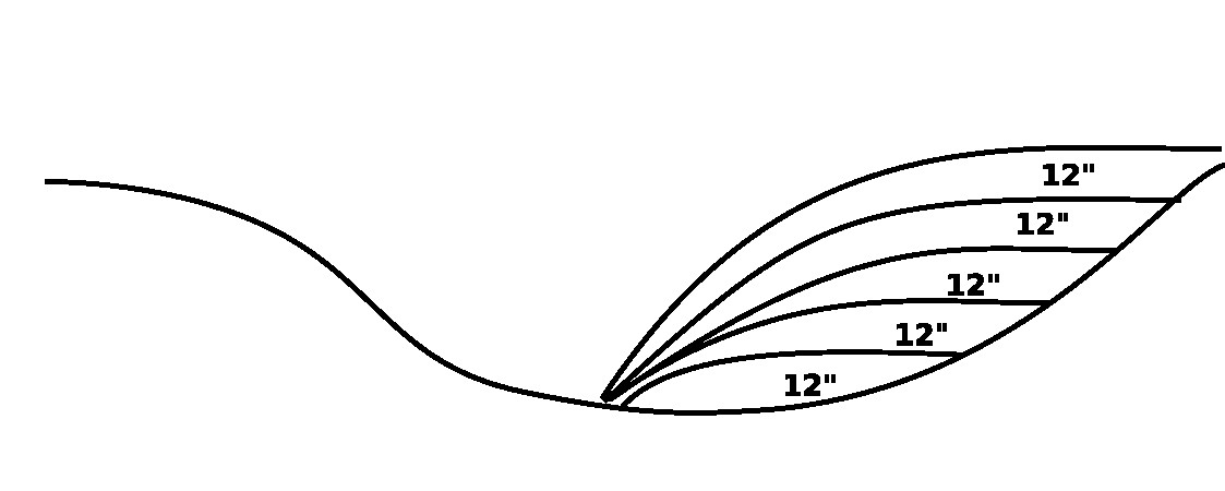

So, in general, for slopes, it's best to place your fill in kinda stair steps; not uniformly across the slope. Not sure if I explain that well? My general advice is, what's the cheapest, easiest, way to get the 80% result for the 20% cost. For this; I would place maybe 12" backfills; run a sprinkler or two over night; get a fill bucket of dirt; and track everything in with the front wheels. Then kinda level it up, reroll, and then place another 12" and run the sprinkler all night for a 2nd night; then tire roll again. This isn't a foundation; and you May get some minor settlement over the next few years; But the difference in 90% compaction of 4 ft; vs 95% compaction of 4 feet; is 5". That would be catastrophic for a road or foundation; but for a yard, that's a few top dressing of sand over the grass in any low areas that do spring up.

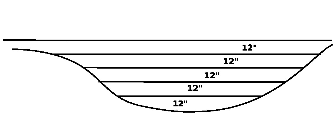

I think I get the stair steps approach. Like this rough drawing I put together? What type of fill would you use? Sprinklers is tough since there is no water on the land at the moment.
Or something like this if I want to extend the slope
Yes, pictures are correct.
For fill; down here, we typically would use any relatively clean material, with as little clay, or organics is fine. Basically, you want to avoid any rocks larger than your fist, and any roots bigger than your finger as a rough guideline. If you ever intend to place an outbuilding on this, things change, but my understanding is you want to have a yard area. Honestly, if you can 100% say you never intend to build a structure on top of this back fill; you can put a pretty good bit of roots, clay, rocks, in the lower portion of the fill; say, the bottom bit of 4 ft; but it's not ideal. I dont mean dump your tree stumps there, I mean, that bottom, some roots, head sized rocks, and all will be fine. As you get to the top 24" you really don't want expansive clays or roots.
As far as water; rain is better than sprinklers; but there is no replacement for proper soil moisture when compacting. As a Very general statement; you want it wet enough that you can form a ball, but when you drop the ball, it crumbles apart. This is why any road project you see, there will be water trucks to get the moisture if it's too dry.
