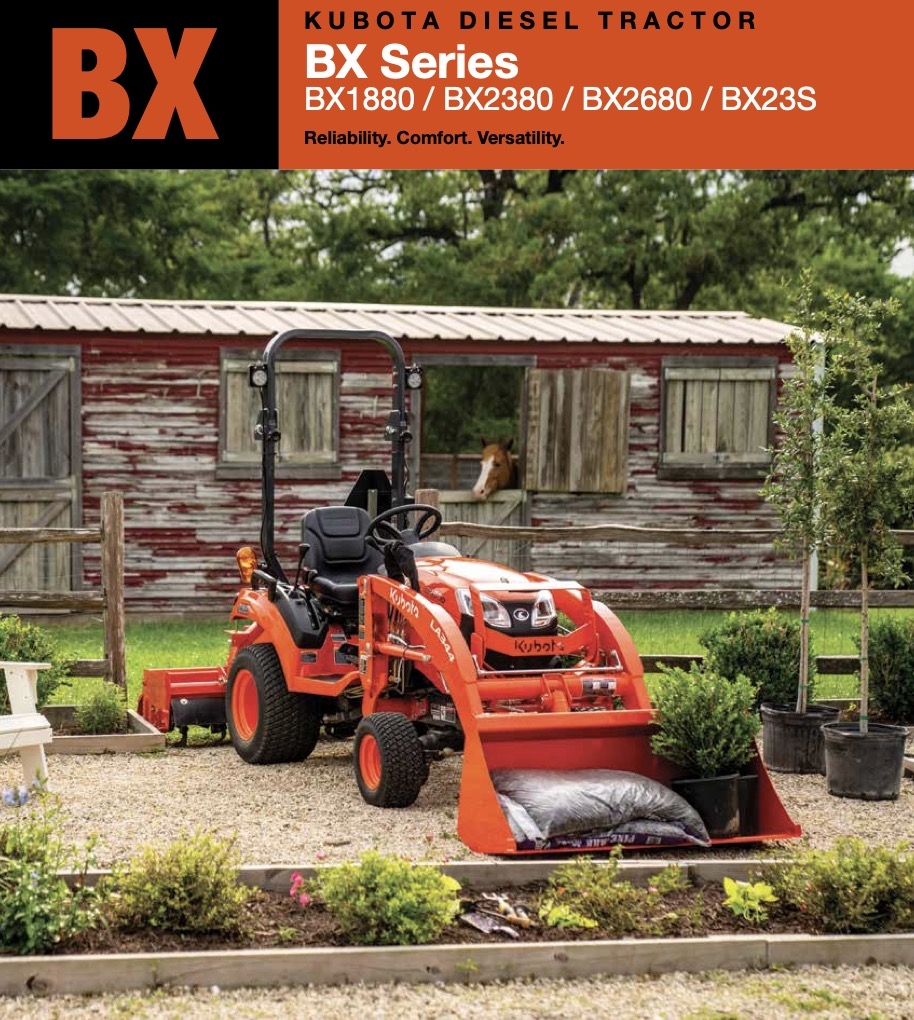

   / Publishing Loader Capacity Numbers That Far Exceed The Capacity Of The Axles #27
What 1600 lbs worth of mulch and shrub looks like in the BX brochure
   / Publishing Loader Capacity Numbers That Far Exceed The Capacity Of The Axles #28
I would suggest that the low capacity number is for a load over rough terrain. Heaven knows that nobody here has ever loaded a bucket and gone bouncing across hills and hummocks but I am sure some have.
Exactly. If that 1600lb rating is good for when you hit a 6” rut at 8 mph, it’s good for 2000lbs on a stone driveway at 3 mph.
What the axle is rated isn’t just one number.
