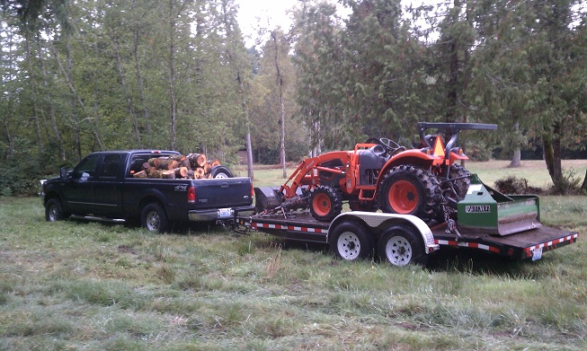

Update:
I thought it might be nice to close the loop on this, if only to say thanks for those who helped and to leave some advice for any future searchers.
I got the WD hitch. It took a while for all the parts to show up, but I got it all settled and working about a week ago or so. I haven't had time to use my tractor lately, so it took a while to get everything ready but I haven't needed it until the past week, and I've been towing it a bunch the past week or so.
Here is my opinion on this: I should have just got a higher rated receiver for the truck. It would have been simpler in many ways.
I never had any sway instabilities with this setup before (when I was running over the hitch rating w/o WD). I still don't = no change. Steering in the truck is unchanged. Basically everything I could feel is unchanged. The one problem I was hoping this would help was the way the truck/trailer combo would "pogo" on the freeway due to the ripples from the way they screed the concrete. I do not have this problem when traveling w/o the trailer. This, sadly is also unchanged. So while I am now safely within the limits of my hitch, I have the added hassle of dealing with the WD hitch whereas if I got a bigger receiver, I could just hitch and go like before. Installing a receiver would have been a simple unbolt old,/bolt in new, so that isn't anything difficult, and the initial setup of a WD hitch takes a bunch of time also as you try to get all the settings correct. I think that would have been a wash either way.
Since I will have this truck a long time, I would have been far better off getting a heavier receiver. Not that the WD hitch use will be too difficult, but I could have avoided all that extra effort forever forward.
Other folks with different situations may have different answers to this. This is mine. I'll live with the WD.
Thanks again for all who helped, and I hope this helps someone in the future.
-Dave
Yeah, well, kinda/sorta...
Pogo'ing doesn't go away COMPLETELY until you go to a gooseneck trailer and get the ball AHEAD of the rear axle center line - but that is a whole 'nother discussion.
If it is still BAD then you probably need to adjust tongue load and then the hitch bar tension (again).
It can be a reiterative process, but worth it.
The load re-distributing hitch (should have) at least reduced the probability of sway.
Even if you never experienced it you were still prone to it - there is a first time for everything, etc.
Exactly the wrong combinations of road surface, cross winds, speed, steering input, etc. can start a sway in a rig that has been driven fine for many thousands of miles with no previous symptoms of sway.
Just saying you have wider margins now - unless you use 'em up (-:

Dave, if the rig in your avatar is how you load, then a lot of your pogo problem is due to the way you have it loaded.
Looking at the picture (with my famous eyeball scales) it looks like you have more weight to the rear of the trailer than the front. No way is there 15% of the total load weight on the ball. Try this, with the WD bars not connected back the tractor on the trailer so the winch in up against the front lip. I'll bet money that the back of the truck sags to beat the band. That's OK, now put the WD bars on and it should bring the back end up to near level. It probably won't pogo when loaded that way. The pogo is often from too little ball weight.
happy hauling.
happy hauling.
I think he is right.
Chris
/ Bigger hitch capacity or weight distributing hitch? #68
Looking at the trailer, the wheels are almost centered, like a balance. I would agree with hitch weight also. Best bet would be to go to a truck scale and find out. I would try to get aleast a 3" to 3 1/2" droop on your truck before locking in the wd bars if possible. You were correct on getting the wd setup, just need the weight more forward for that style trailer.

I am rather constrained on how I can load. This is the classic problem of the trailer not being long enough to allow enough adjustment to position the load best. The tractor "fits" but not perfectly. Here is a bigger pic, but this does not show the winch on the 3pt, which adds another 350 lbs back there. Rear tires are loaded and weigh ~500 lbs ea, if you follow the charts. I think the small avatar pic is a bit misleading, but I do not have an actual measurement of tongue weight. The front tractor axle is forward of the rearmost trailer axle. I think the loading distribution on the trailer would be worse if I turned this around. I could back it up farther (towards the tongue) than it is - I just thought this was about the right place for it based on feel of the trailer tongue loading (as it appeared visually to me).
attachment.php
I didn't mention it in the last post, but yes I think I still have some adjustments to do on the hitch setup. I followed the instructions, but I know I need to lower the hitch on the drawbar one notch for sure. It was close enough to get moving, but wasn't as leveled out as it should have been according to the directions. If it improves the pogo, I'll report back. Won't be until at least the weekend. Unless a miracle occurs, I'll stick with my assessment that a beefier receiver would have been the simpler solution. Within rated specs either way, which is good.
-Dave

"Normal" trailer design is center of axle or axles if tandem is 60% back from the front of the trailer, not counting the tongue. Unless a trailer is special built for some purpose that demands otherwise this is what is usually seen. Hard to tell for sure from your pic but the 60/40 rule doesn't look like it was followed on your trailer..
/ Bigger hitch capacity or weight distributing hitch? #73
Thanks for that bigger photo. I agree that you should be backed on as you are. I actually thought that the trailer tongue was on the left side of the photo. With loaded rear tires, and both tractor axles ahead of the rear trailer axle, I am going to guess that you are actually very tongue heavy and the location of the trailer axles on the trailer is odd but actually helping your situation. You will notice that your W/D bars are rated for a tongue weight. Mine are 1000 lb bars. You've got so much tongue weight that those W/D bars are probably not able to function as designed.
You may be exceeding the hitch rating even with a W/D system.

The angle of the pic doesn't help. I don't have a straight-on side shot. The axles are further to the back than midpoint. It probably follows the 60/40 or ~5/8 back rule, but I haven't measured for sure. It is classified as a 10k car trailer by the mfg'er.
The WD hitch is rated for up to 12k lbs and that bars are 1200 lbs. It would probably be a good idea to do the tongue weight test just to see where I am at. Always helps to know where you stand.
PS: I really could use a 20' trailer, and I know it (or even 22'). The problem is in storing it plus the expense of a new trailer. It would be hard to fit it in my storage building. I got this one used, and it can be very hard to find something that is exactly what you want used, so you make compromises. That plus I was new to this and was advised that this one would be fine by the guy I bought the tractor from (not the trailer owner). I see a lot of lighter trailers, and a lot of GNs, but very few in this range. 18' would have been better but it is not worth trading up to 18' from here. If I was going to upgrade, it would be 20 or 22' to be worth it. But then in the long term I won't need the trailer much. Right now I am storing off-site so it gets towed around often, but that will change when house construction starts in a year or two. So I'll probably just keep dealing with it for now...
