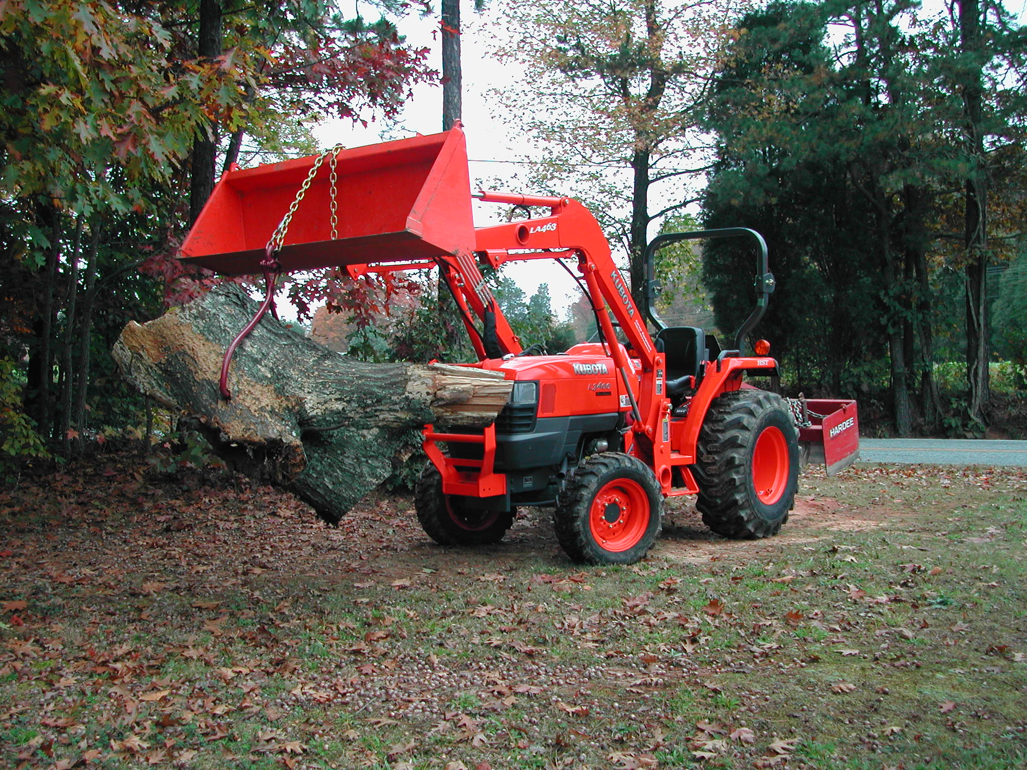

I am with TheGoose my loader treats me fine, I have not tweaked it at all my loader is factory set and plenty of times I have tilted the tractor lifting a rear tire off the ground trying to pick something too heavy up. My tires are filled and I have a 60" box blade on the back:) Can't imagine trying to lift more with it, considering the price difference between the L and grand L I would think you would get more with a bigger tractor:confused2::confused2:

I did not weigh these logs but according to weight estimators on the internet they are around 1500 pounds. The tongs are the largest that northern tool sells 35" You can plainly see in the picture they are open as wide as the can go, being conservative calaculating the weight of red oak 30 " in diameter 5 feet long - 1500lbs.:)
