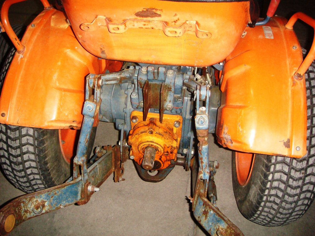

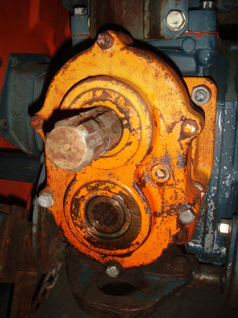

/ pto runs counter clockwise #3
Joel nailed it.
Here's the reverser he was talking about on the back of my B6000E.

Farmall Cubs and some Kubota;s also ran CCW I was looking for a gearbox for a cord wood saw one day a few years ago and while thumbing through a catalog I saw a reverser for Cub and I think Kubota,If I remember right it was Horton and was sold by Eastern Bearings.
