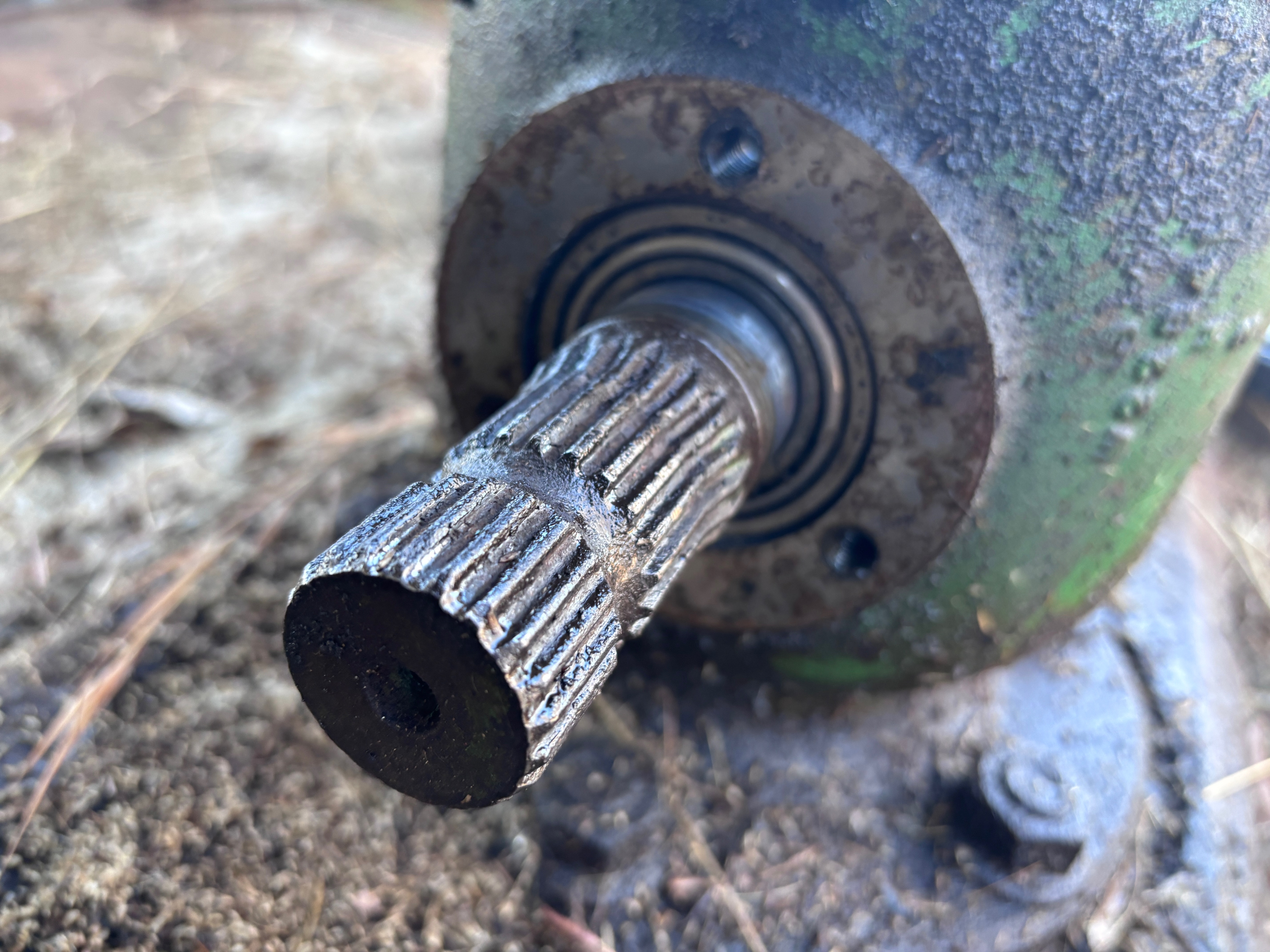

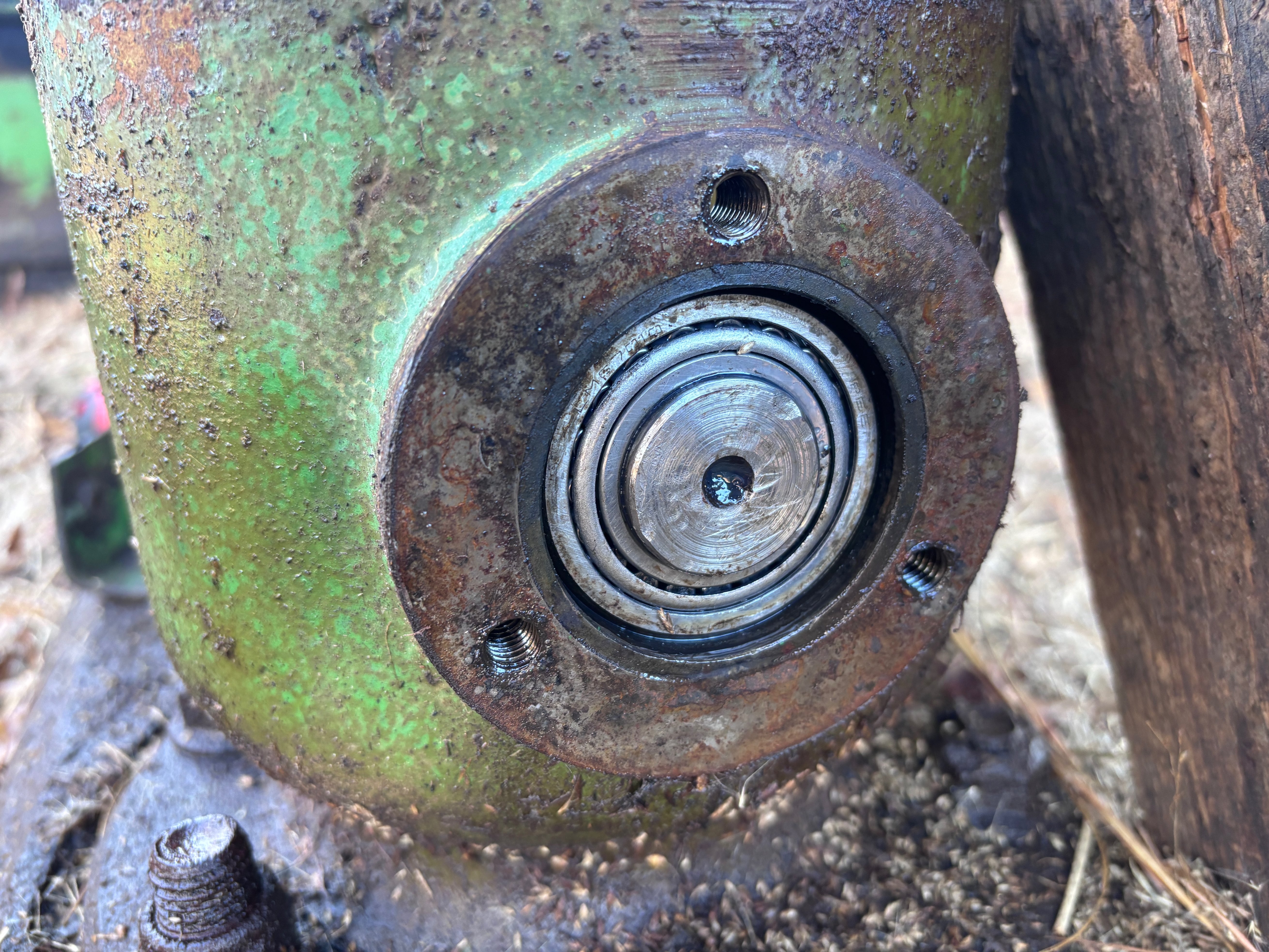

I looked at the shaft last night and it appears that there is a threaded hole going down into it as if it was held in by a bolt and it just came loose. This seems odd, but no pins on the sides of the shaft. I’ll see if I can get some pictures later today

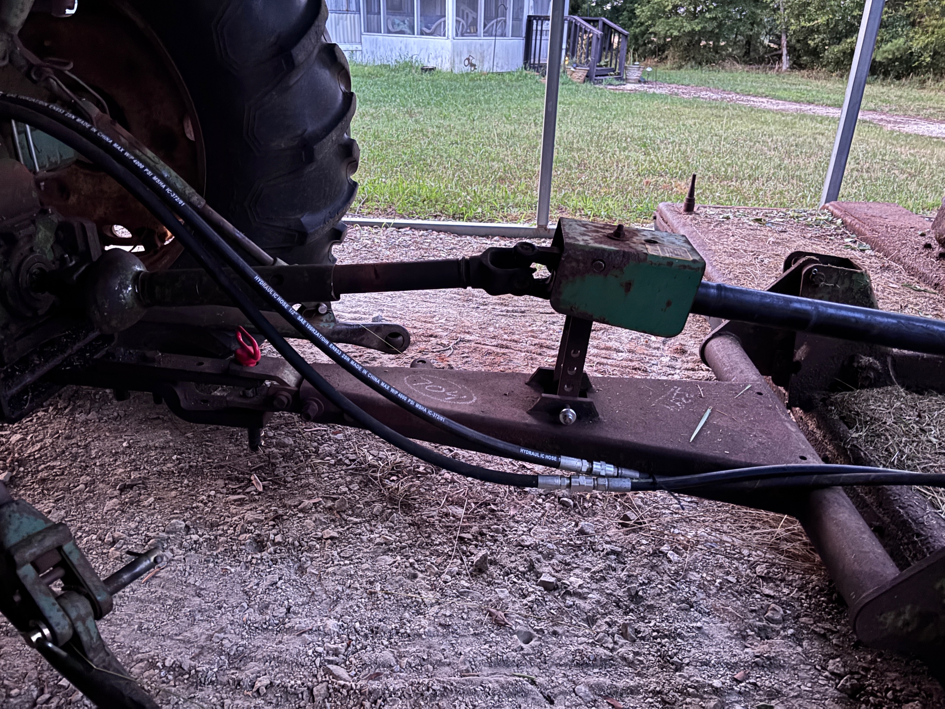

It occurred to me that the shafts are not put together wrong. Remember the caps were missing from one of the yokes. Photo shows its the PTO tube yoke. I'll bet some 'yoke'al replaced that piece and was not only careless with the bearing end caps, but also with the yoke alignment. Probably sawed off the old yoke and slide a new one on the end of the tube. So hopefully all this went together good and we get confirmation.
/ Cutter death trap #64
Recent used purchase of a 10’ offset John Deere cutter at 1000pto. This thing scares me and I lean forward when running cause I think the pto shaft is going to explode. Is this normal from the video. Most of the noise is coming from the loose shield. I’ve ran plenty of implements with pto’s and never been worried. See picture of the hookup orientation at cutting height along with the video. I can spin the shaft by hand and no bearings feel loose or anything else alarming.
Not sure what I should expect, but I don’t like the fear of a yoke going through my head.
Any thoughts from experienced users of batwing cutters or anything close?
Should I be worried and if so what do I need to do in order to correct?
I've had PTO shafts separate while cutting do to a malfunction elsewhere. There never was a problem as the shaft falls to the ground and the spinning keeps it in the area of the ground.

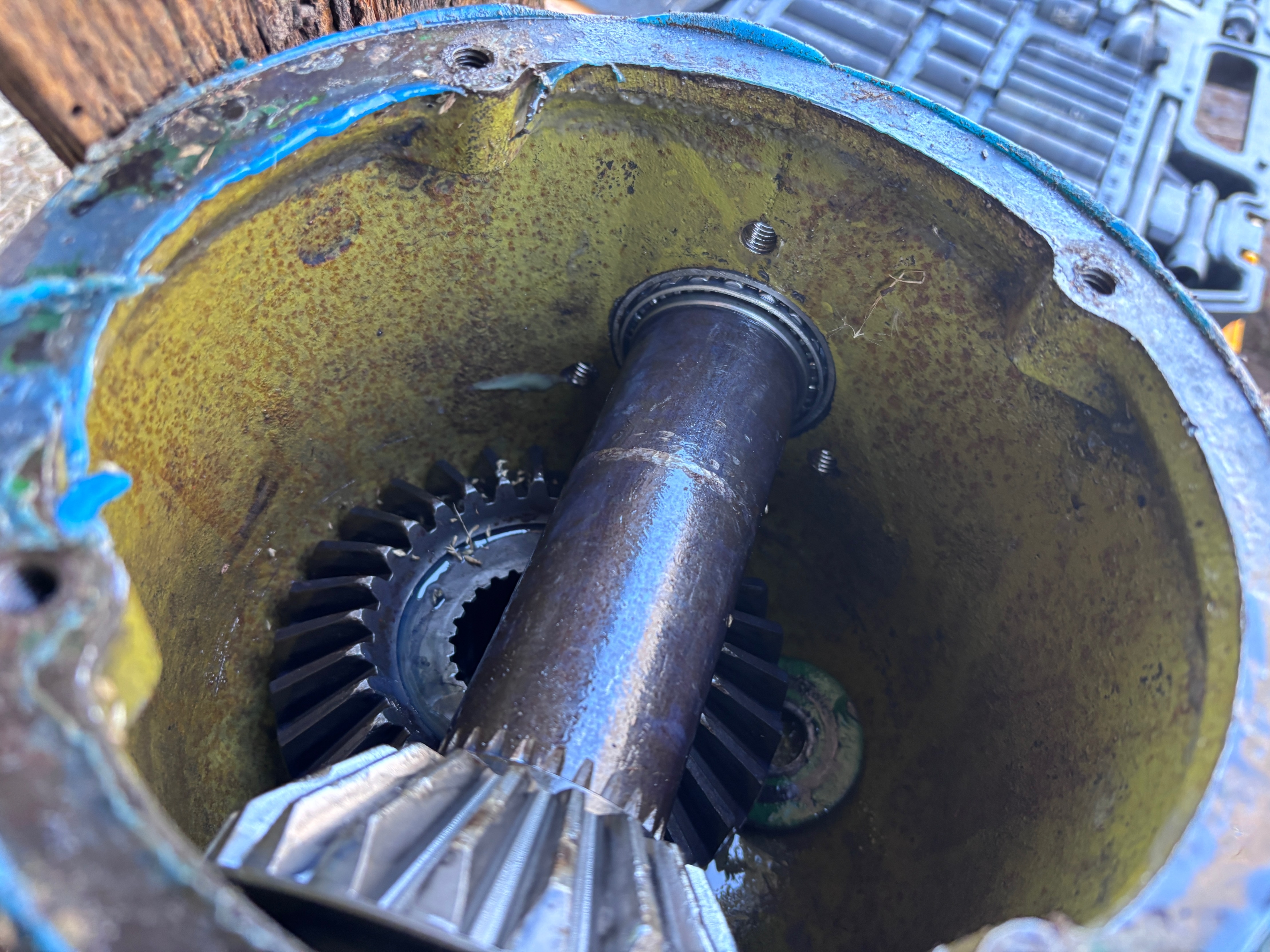

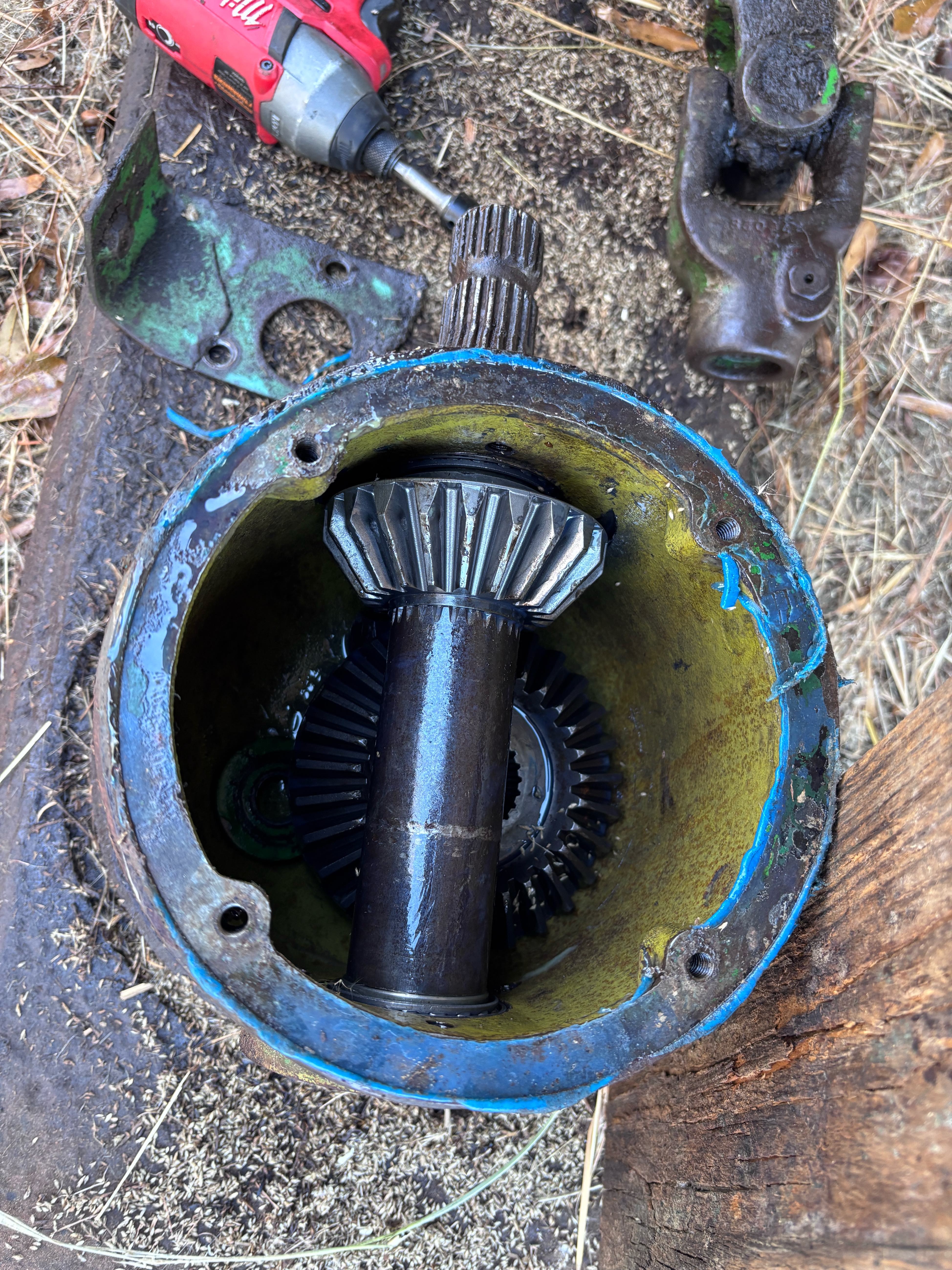

Well I finally got around to taking the cover off. It looks like the shaft/spindle just loosened up in the gearbox. I found the bolt and washer at the bottom. The teeth are a little chipped. Looks like I can just replace the seals and bearings on the cutter spindle and I’ll be all set. The horizontal shaft bearings are a little loose so I’ll do those as well but… How do I get this horizontal shaft out of here. Bearings on each side of the gearbox but I don’t see a pin or snap ring that I need to remove in order to replace those bearings and get the shaft out..

/ Cutter death trap #66
Does the shaft go clear through on the left side of this pic?
If so a big hammer and a large brass punch, to drive it out of the pinion gear and on out.
/ Cutter death trap #67
That doesn't look as bad as I thought it might. Looks like you have a 1418 Rotary cutter. Here are a couple links for parts. One to John Deere and another after market. Looks like the nut came off the shaft end possible because of bearing failure? The bevel gear doesn't look terrible. Hopefully with some bearings, seals, and maybe a nut a retainer you can reassemble and be back in business. Check the other gearboxes though.
