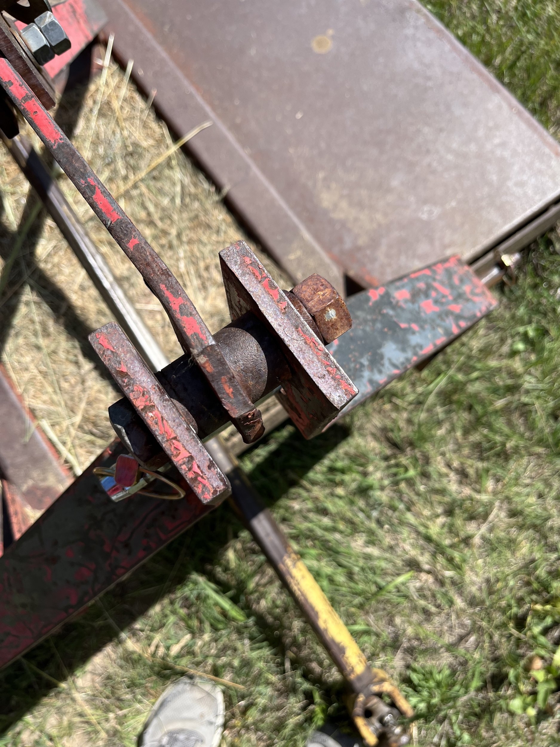

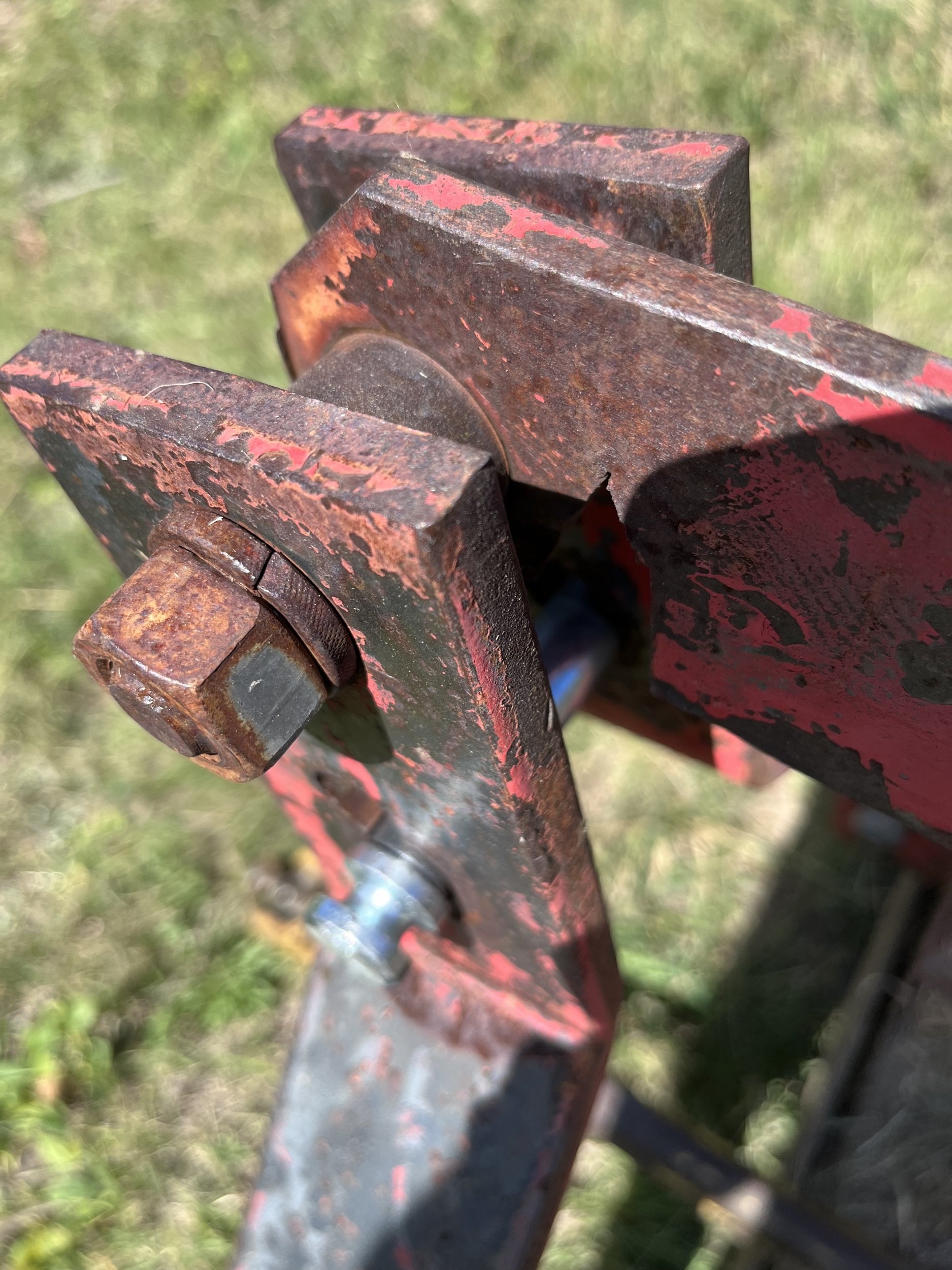

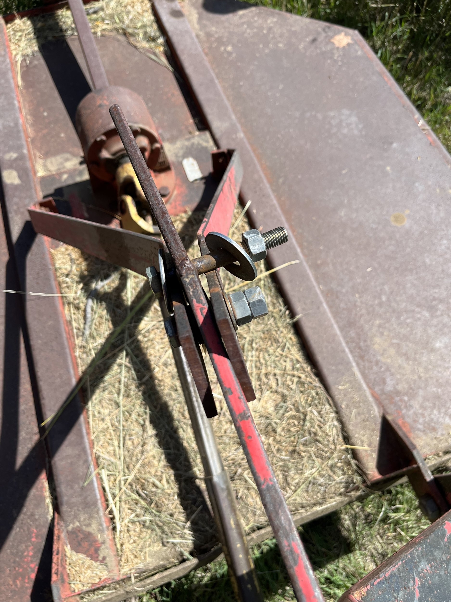

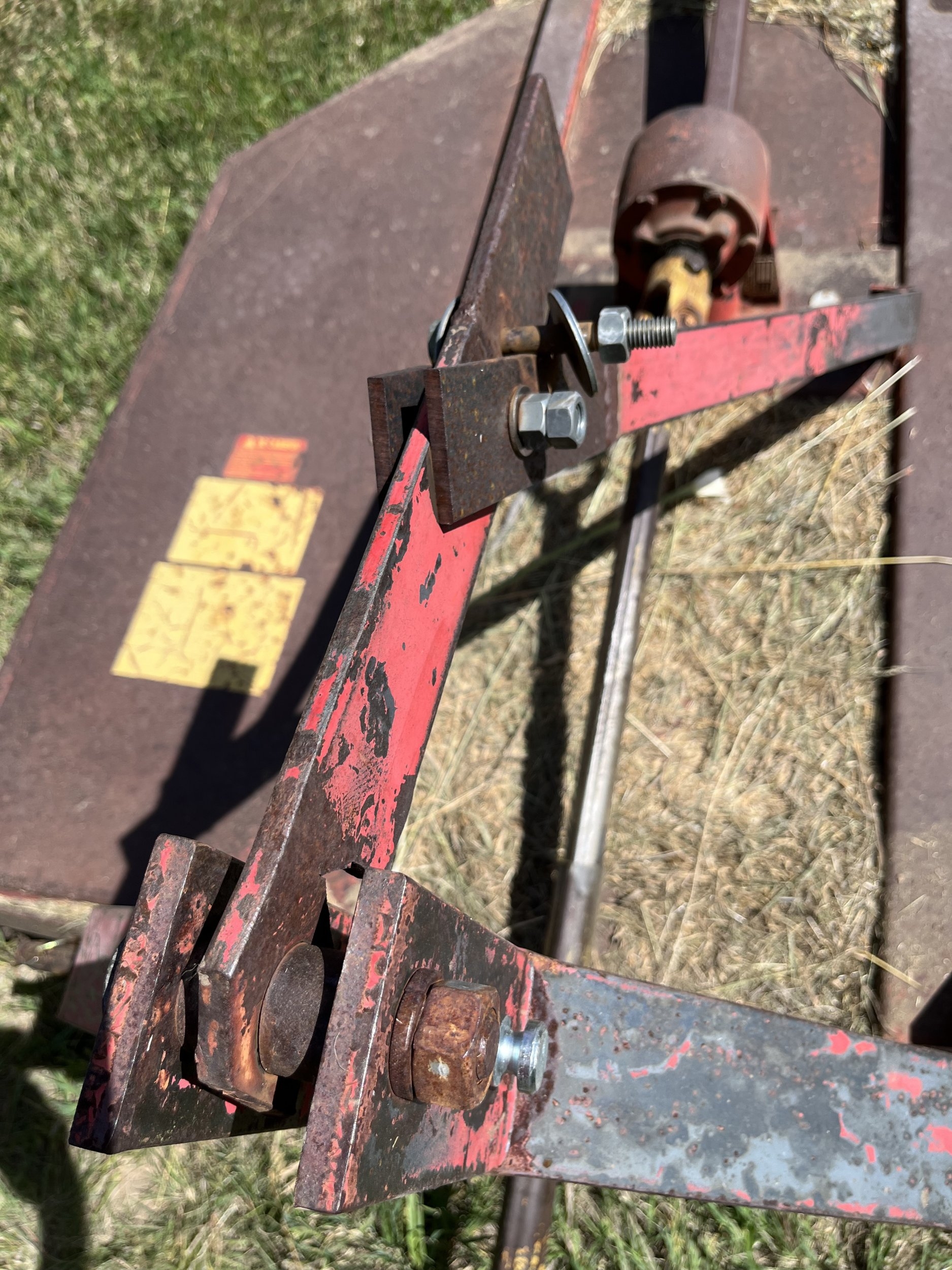

Greetings! I picked up this Mohawk B-5 "Brave" rotary cutter at a farm near my home. I've already changed out the gearbox fluid and checked underneath to find the stump jumper and blades in surprisingly good condition.
I don't think the upper link area is set up as it would have come from the factory, and would like to return it to something that works well and is 'safe.' I don't have a manual, but it's clear that the top piece of steel (3/8" thick and apparently random length) is a piece of creative engineering. Seems to work okay, but since I haven't pushed it hard yet, I'm not sure what to be worried about. If anything.
Do any of you see any glaring issues that I should address before pressing the old girl into service?
Thanks in advance.
Jim

Make sure the PTO shaft slides in and out freely. If it don't take it apart and grease it.
I would look at changing some of those bolts to grade 8 at minimum if they aren't.
