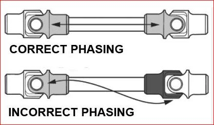

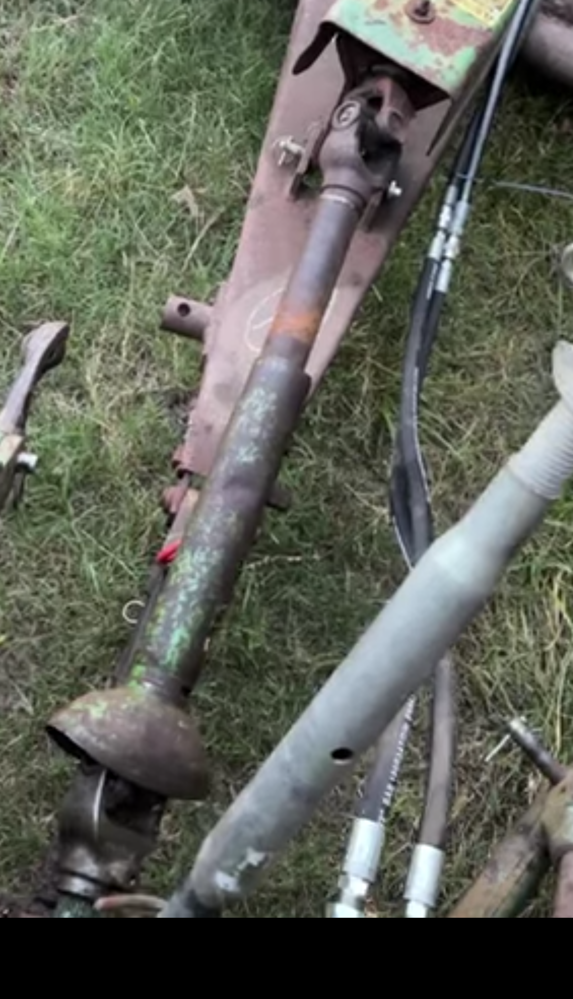

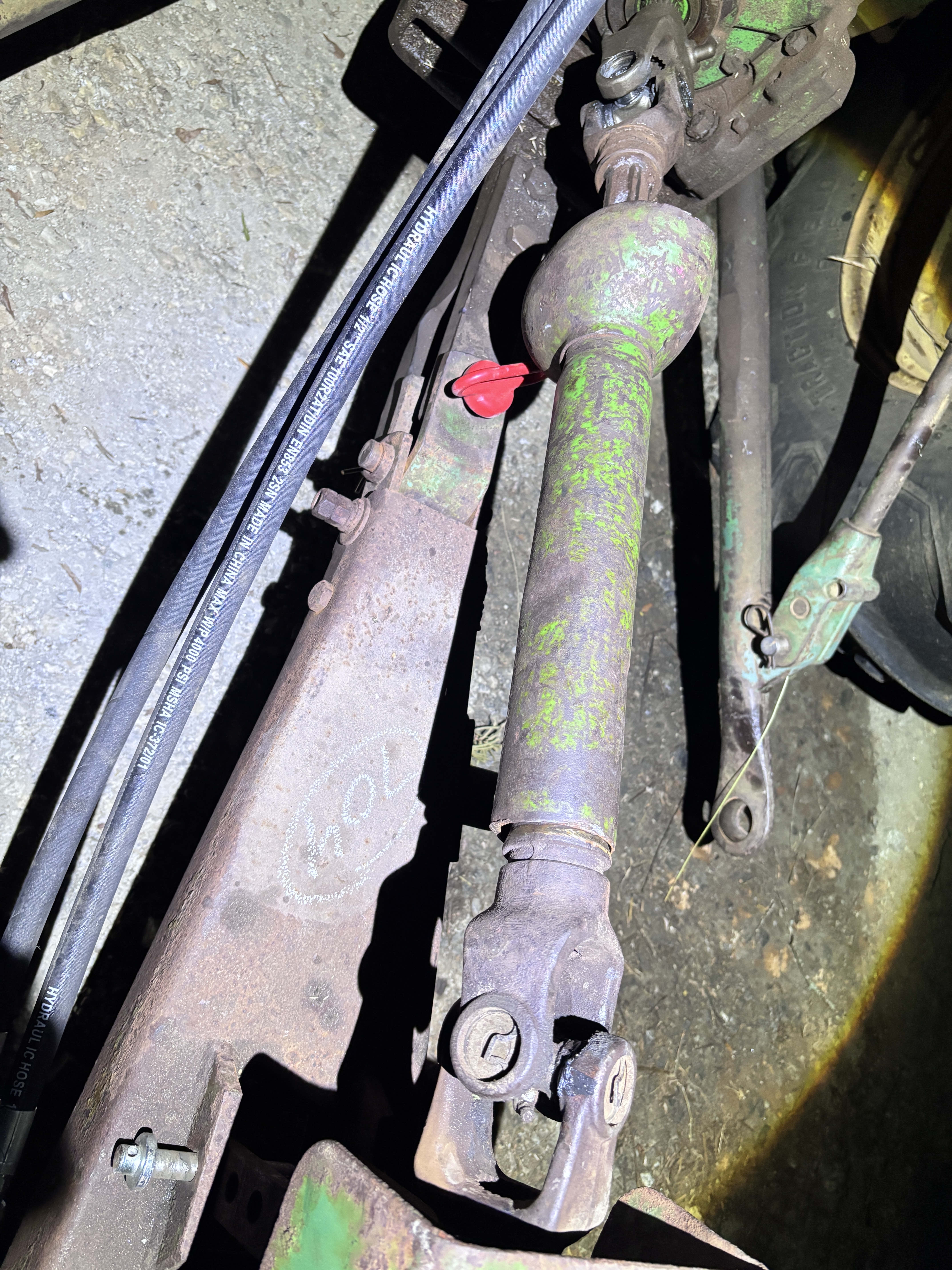

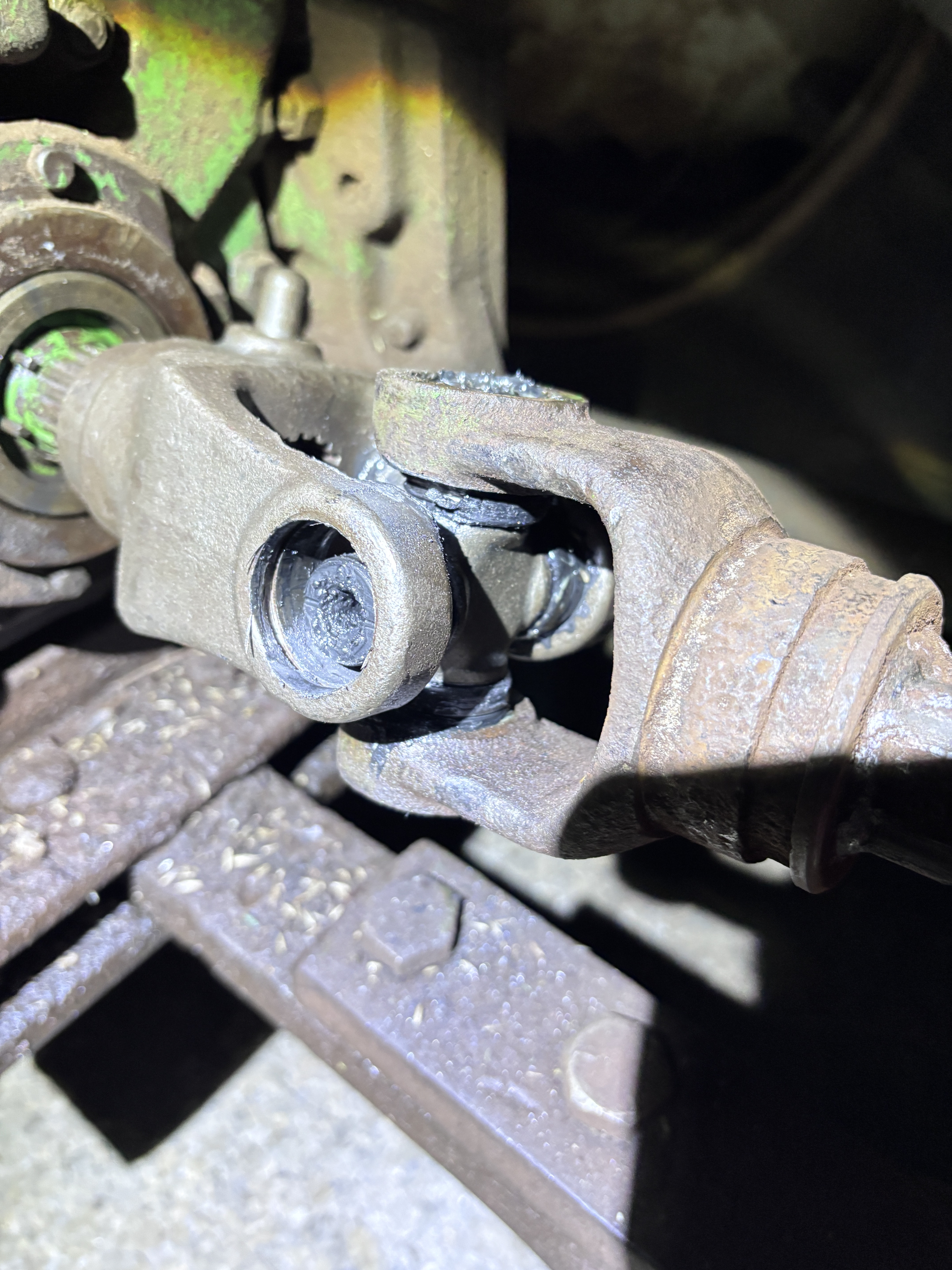

It occurred to me that the shafts are not put together wrong. Remember the caps were missing from one of the yokes. Photo shows its the PTO tube yoke. I'll bet some 'yoke'al replaced that piece and was not only careless with the bearing end caps, but also with the yoke alignment. Probably sawed off the old yoke and slide a new one on the end of the tube. So hopefully all this went together good and we get confirmation.

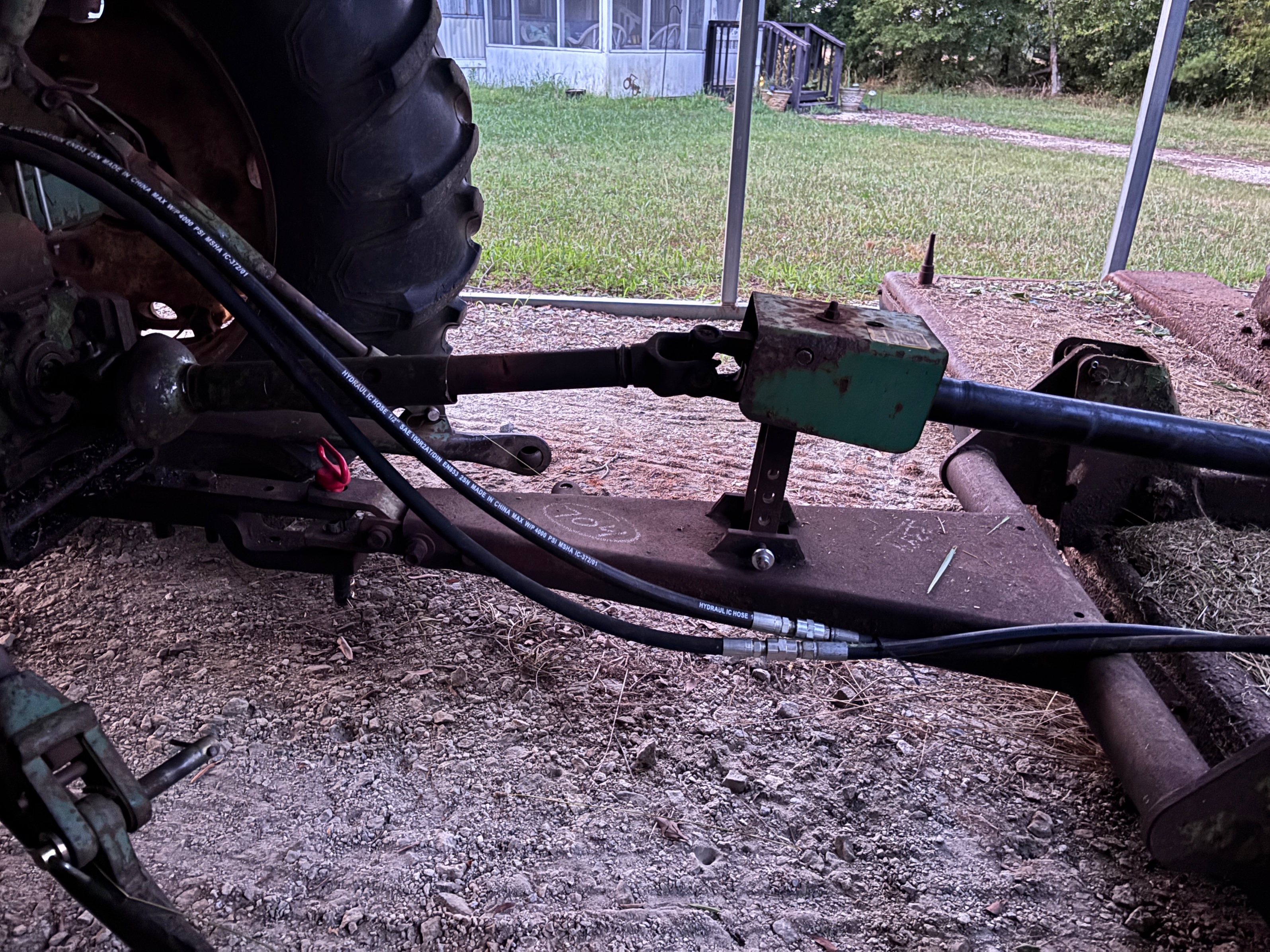

Recent used purchase of a 10’ offset John Deere cutter at 1000pto. This thing scares me and I lean forward when running cause I think the pto shaft is going to explode. Is this normal from the video. Most of the noise is coming from the loose shield. I’ve ran plenty of implements with pto’s and never been worried. See picture of the hookup orientation at cutting height along with the video. I can spin the shaft by hand and no bearings feel loose or anything else alarming.
Not sure what I should expect, but I don’t like the fear of a yoke going through my head.
Any thoughts from experienced users of batwing cutters or anything close?
Should I be worried and if so what do I need to do in order to correct?
I've had PTO shafts separate while cutting do to a malfunction elsewhere. There never was a problem as the shaft falls to the ground and the spinning keeps it in the area of the ground.
