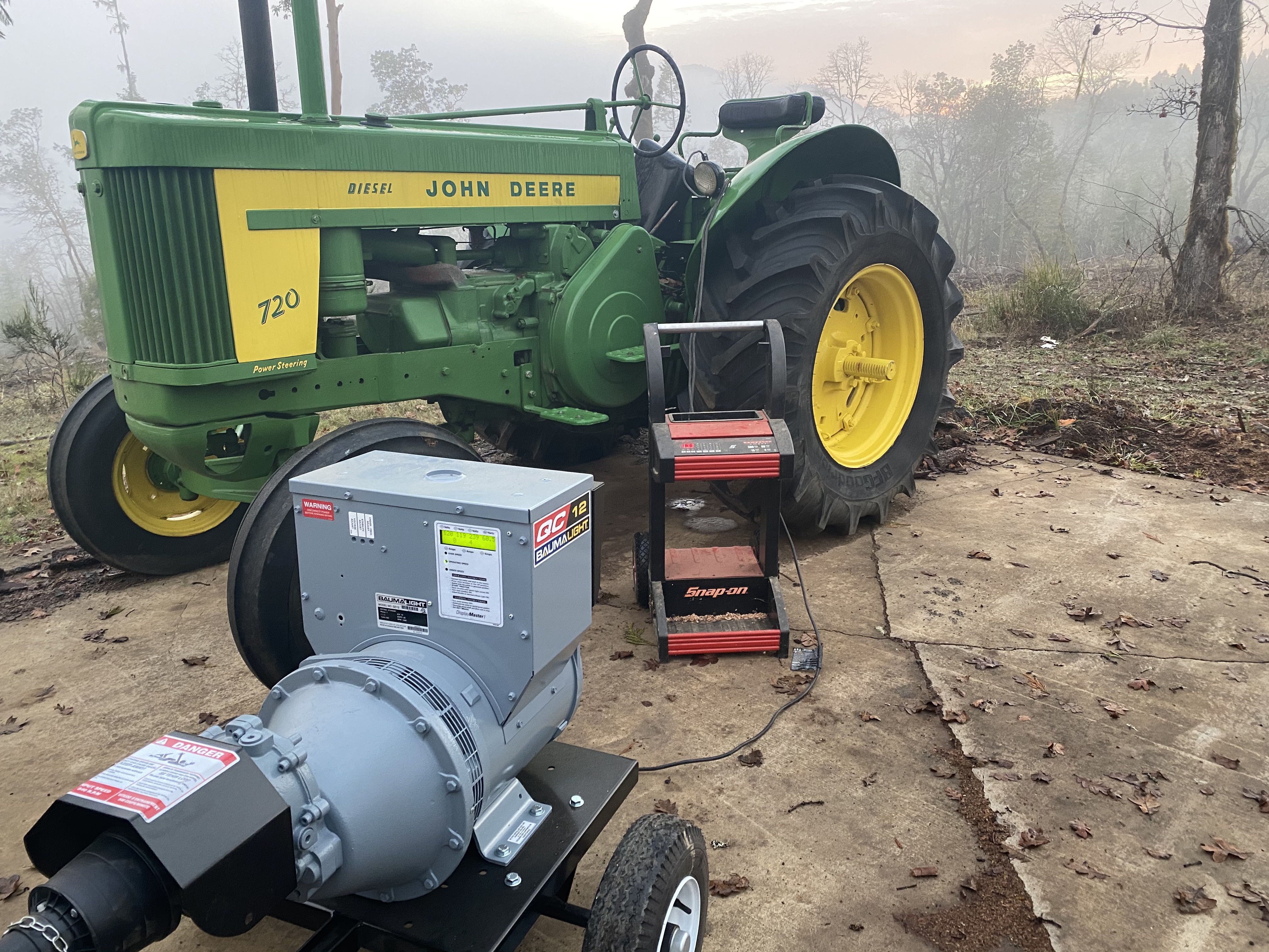

Maybe I said it before in this thread. Here, PTO sets are always listed in farm mag classified ads, CHEAP! I bought a 15K Onan years ago from a defunct chicken farm for $500.00 CDN. Mind you money was worth a lot more back then. I would consider it very foolish to buy one new.

Well, my 15KW Winco PTO generator cost me $1200.00 new, and I already have a tractor. So as far as I'm concerned it's a cheeep way to get a WELL MADE diesel generator that will easily power my house in any weather, without another engine to take care of. I always have diesel around for my tractor and my tractor is always ready to go...
I'm NOT dealing with "unknown china quality" (or lack of) either, the Winco is rated continuous duty as is my tractor...
