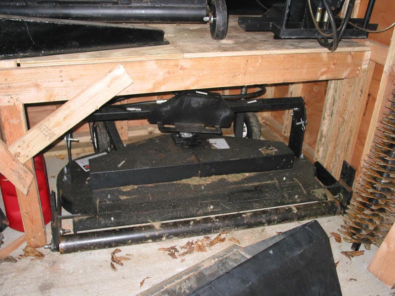

I don't like the rear wheels on the mower deck either. They will push the grass on tight turns instead of rolling over it. If I slow down in a tight turn, they will slide over the grass. But, I wonder how much it would cost to use something else. Maybe some wider solid rubber tires would be better. Of maybe they would gouge the grass even more? Casters would be nice, but they would make it hard to get near things if they were mounted to the side and they might not fit between the deck and the tractor if they were rear mounted. We'd have to take some measurements. Also, rear casters and height adjusters would add to the cost of the deck. I never change my cutting height on my lawn, so the lack of easy adjustment on the rear wheels is not a big deal to me.
Maybe some large rollers with rounded ends all the way across the rear of the deck would do the trick and make for nice striping as well. Then you could put three adjusters, one on each end and one in the middle all tied together to one lever for easy rear height setting. Just wonder if the clippings would shoot out over the rollers or get clogged up in there.

I will pay homage to our buddy Ed Ambrose here. Here's a picture of a cool job he did on his 60" deck to solve the problem of those nasty gauge wheels and get a stripe out of the unit at the same time! Good job, Ed
-Rob

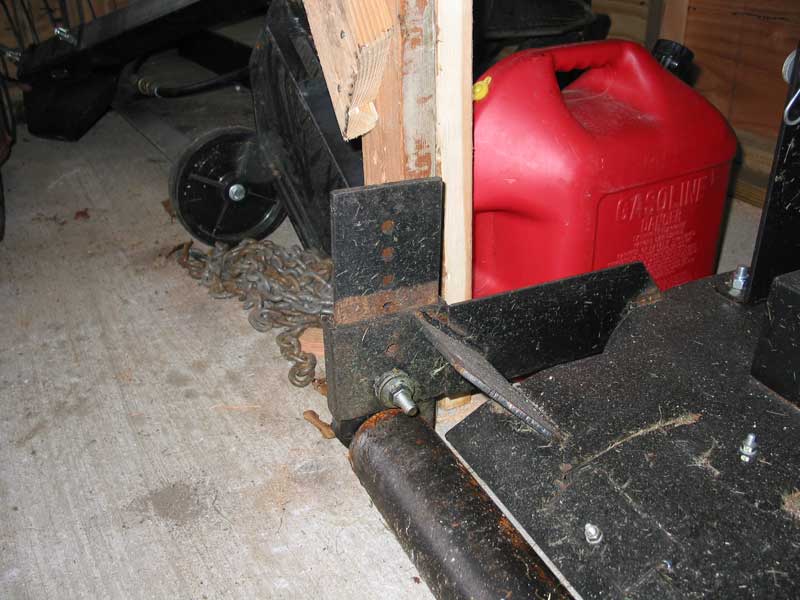

Here's another pic of Ed's Mod.
