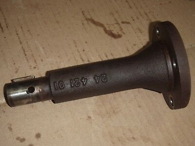

On my 2001 model year PT425, Kohler Command CH25, I have the two gear pumps mounted to the engine shaft.
On the other side of the engine, the screen has been removed and an auxiliary stub shaft is mounted the flywheel. That drives the variable volume pump.
So I'd need a replacement engine to be able to do that.
Looks like this:
Moss, I think a lot (most?) small engines have that option as a native part of their design. I'm pretty sure this isn't a special option unless you want a screen with an appropriate cutout.
But why go with another brand? Until relatively recently, EVERY larger commercial piece of equipment came with a Kohler engine. For B&S to even get into the game, they had to buy some lawn mower companies...Simplicity, Snapper, Ferris, etc.... Initially, their larger displacement engines were made in Japan if I remember correctly. However, as we've seen with the Subaru, this isn't a guarantee it will work well in any application. The commercial mowing guys were regularly getting 4000 hours out of your generation Kohler. That's fantastic for an air cooled engine (although I'll admit the canister air filters with precleaners probably helped a lot).
I haven't heard much about the newer Kohlers. Maybe the B&S is better now (it wouldn't surprise me if Accountants or Marketing people are in charge) but, I can tell you from personal experience, it isn't real easy to put in a different engine. I needed a lathe to make the adapter, and mill to drill the proper bolt circle and a LOT of trial and error to get everything else to fit. It's fun work but if you need your tractor every week, it seems like an unnecessary risk/aggravation.
