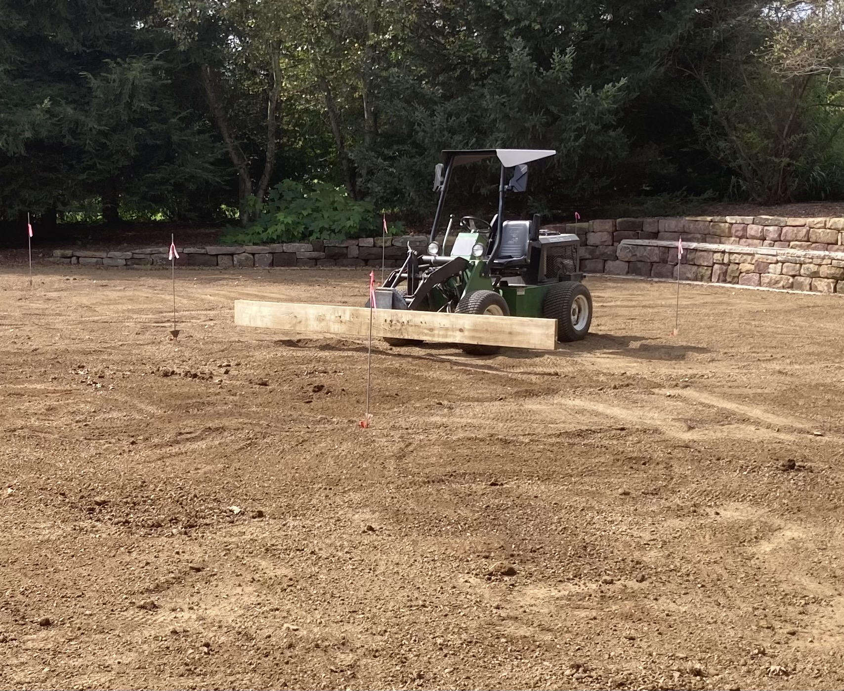

Built a new croquet court using the PT to level the green before seeding.

We also have no flat land - so I made some with the PT.
   / Repower or Sell PT-425...? #26
Perhaps, not, but those are gorgeous retaining walls.
Nice job! When I leveled my arena, I did it by backdragging the 4n1 bucket and a laser level. After awhile, I could see what was high just by eyeballing it. Nowhere near as last as a hydraulic laser level on a land plane...
