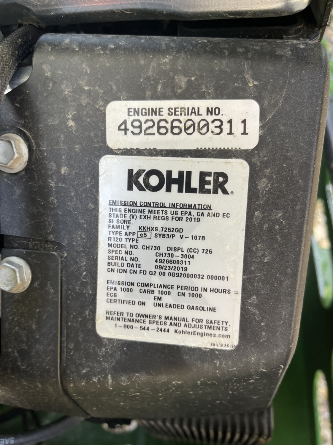

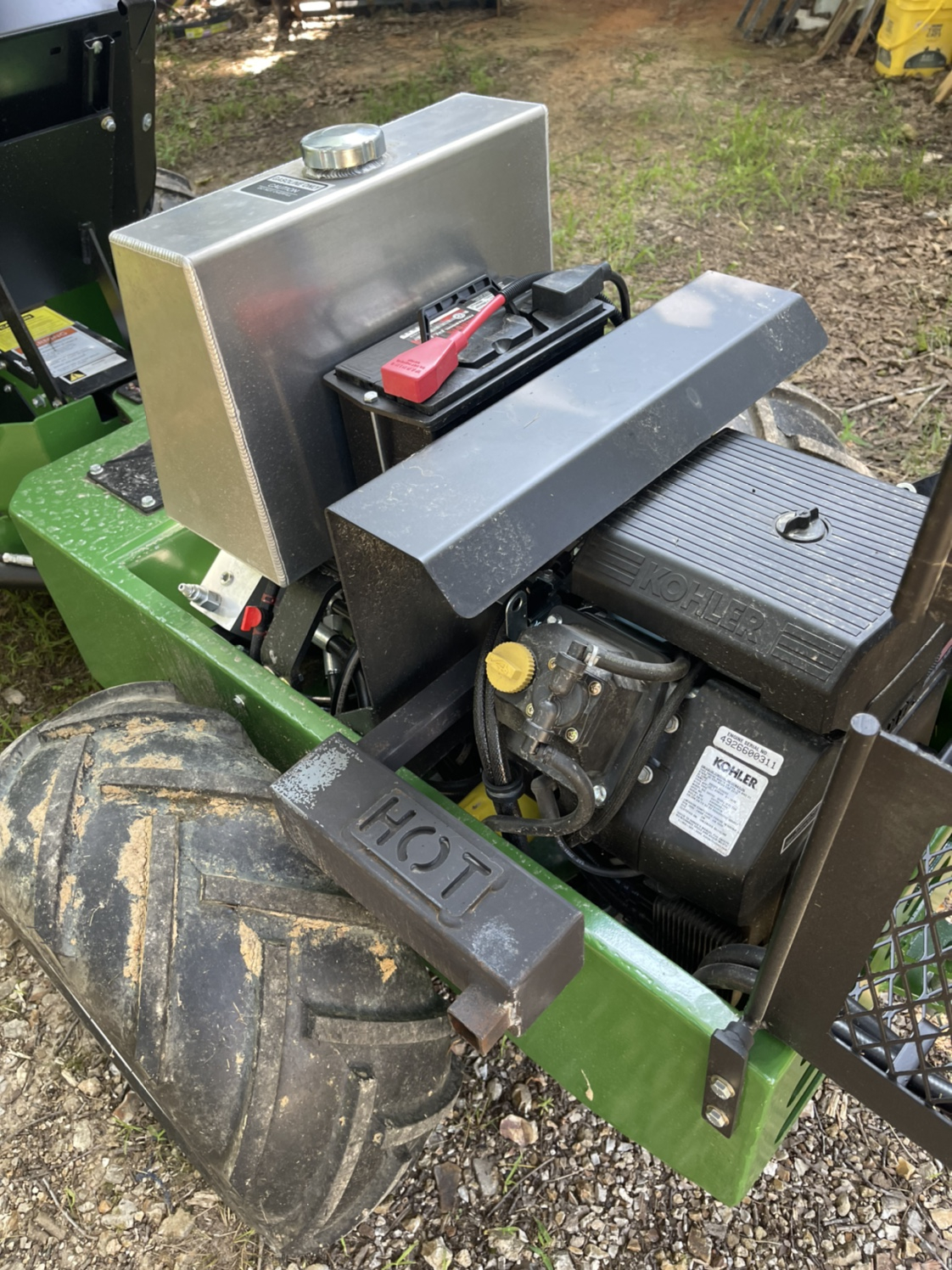

Pics of current engine model number,
Looks to be 730 model number
and layout.
I haven’t mowed enough to know the gallons per hour, but have heard others say gallon per hour, and that seems reasonable to me
I do know, at 1/2- 3/4 throttle just using the grapple moving brush, using the forks to move stuff around, etc. it sips fuel.
and layout.

Thanks for the great pictures. Nice to see the plastic fuel tank that Moss spoke of has ben replaced with what looks like and aluminum fabricated tank with a nice cap.
