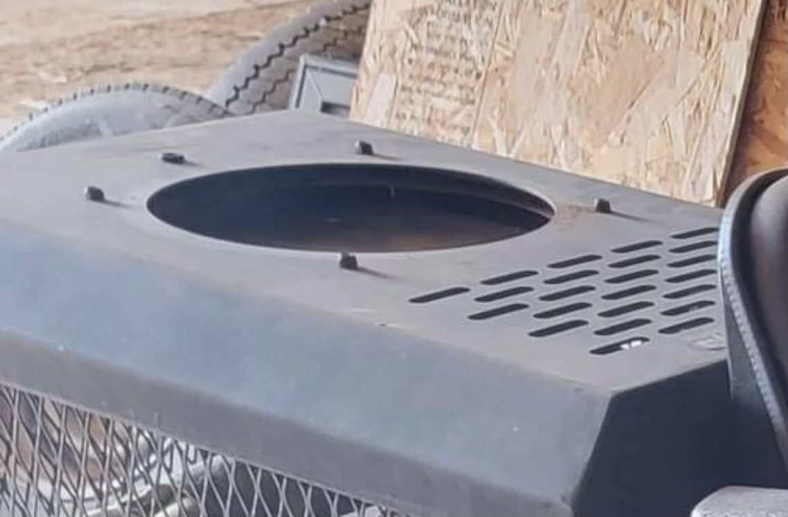

If it is a machine I seen for sale, the hydraulic oil cooler was removed? Why? How long was it run without a cooler? Was it overheated (and potentially problematic from here on in with hardened seals and worn pumps/motors).
I wouldn't turn up the pressures, they can already lift enough to tip forward (and at that point the weight of the machine and load is all on 2 wheel motor shafts), but it will be yours. Also keep in mind on an articulated machine, when turned, the overall length gets smaller and you loose leverage from your counterweight (engine).
/ 425 - model year changes and price check
That’s the same one, and you just made me realize the hydraulic cooler is missing, I would not have noticed that. Am I correct in that the cooler is simply a fan, it’s not an actual cooler with a radiator and fan?
But yes, the fact that the cooler is missing is very suspect, very glad you brought this up.
/ 425 - model year changes and price check #4
There should be a radiator under the fan hole. Yes - it is important to keep the hydraulic oil at a good operating temperature. there is a temperature sensor that controls the fan. Yes - it is important.

By looking at the pics in the ad, can either of you tell if only the fan is missing, or if the rad is also gone? If it’s only the fan, I feel like someone broke it and was too lazy or cheap to replace it. If the rad is gone as well, then that’s a whole other potential story.
This is a bummer no matter what, as I agree an overheated hydraulic system will only lead to issues down the road.

Looking at the photo it could be the radiator but I am not sure.

That photo looks like the radiator is there, but these machines need the cooling that the fan provides. Hopefully, it wasn't run without it. If you do go visit, look carefully at the rubber on the hoses close to the engine, and on the connections to the cooler.
I would also check the oil in the hydraulic tank (smell, color) as a quick and dirty check on overheating. Of course, if it is golden colored the seller may have changed the oil... I would also check the engine oil for color/smell.

He is telling me he is the second owner and it came with the fan missing. Seemingly, he didn’t even realize one should be there, unless he’s full of it.
So, it has definitely been used without the hydro cooling fan, but no way of telling if it has been used hard. I suppose if it was not used hard without the fan, it could be a non issue. Good points on checking the hoses near the cooler / engine and the smell and color of the hydro oil.
