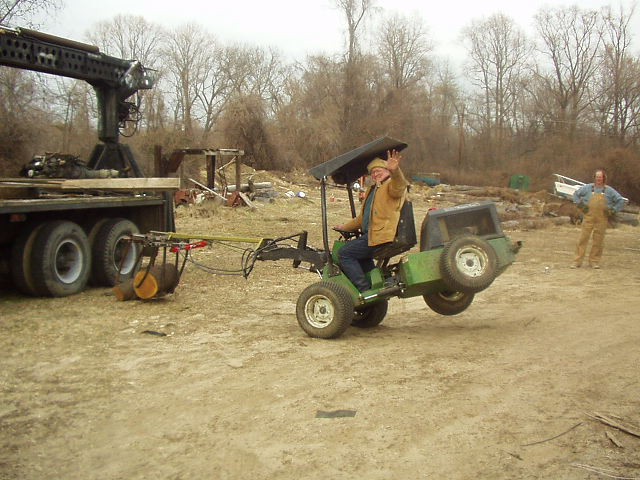

Here's the small bucket curled all the way back at full lift height. Note the position of the pivot pin is still almost completely behind the back of the bucket.
There is just no way to get 1000 pounds over that pin with any of the attachments that PT sells.
I'd really be shocked if my machine could lift 800# in the bucket or on the forks without the rear wheels coming off the ground.
(note the happy operator :) )
