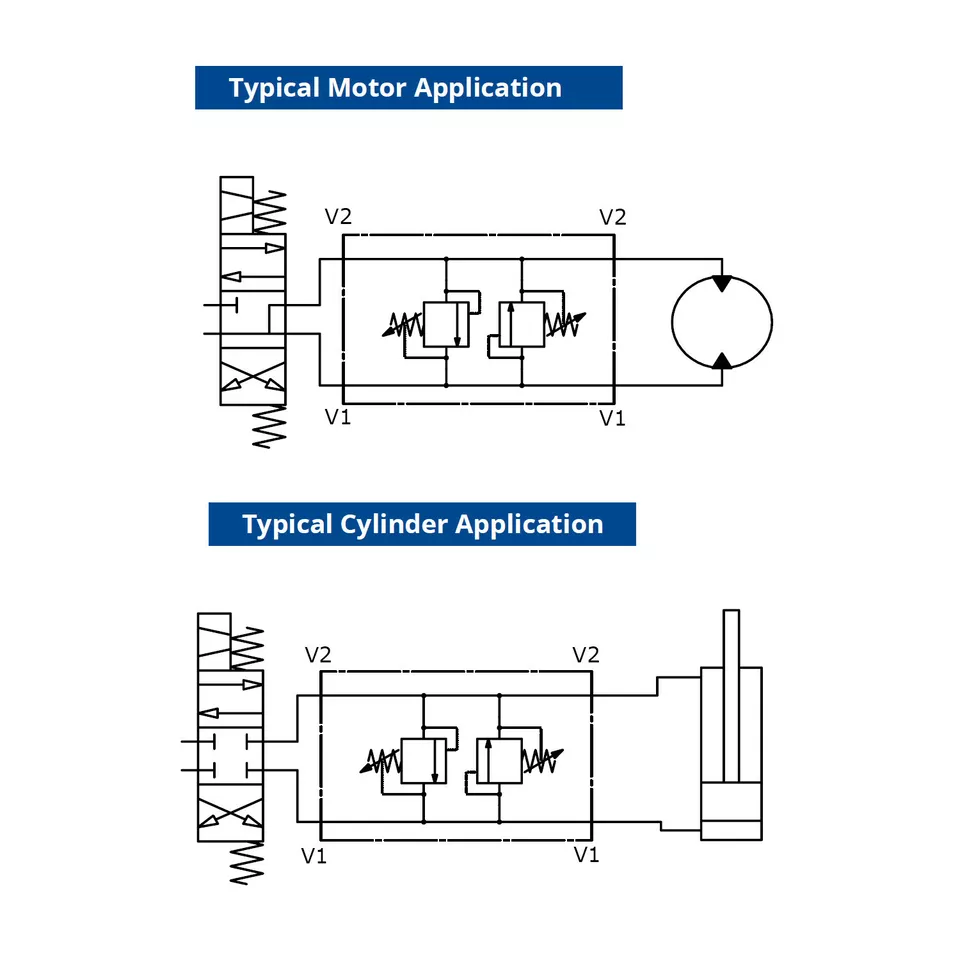

I see the real problem is with the thumb allowing pic and carry work. The weight will easily be max for the machine and since you are moving about the dynamic forces can spike to extremes.
Other backhoe manufactures (and many other types of machines) have dealt with this for years by adding circuit reliefs. The closed loop with the spike loads now has an escape hatch - exit.
By memory from years ago, for example the system relief would have a relief setting of 2100 psi. The circuit relief was 3000 psi.
The valve themselves are currently $100 or so and you would only need 2 short -4 hoses and 4 fittings (for each circuit you want to protect). Cheap insurance. I intend to do it, maybe this winter. Here is an example Pardon Our Interruption...
Disregard the motor application, The cylinder diagram shown is what is needed.

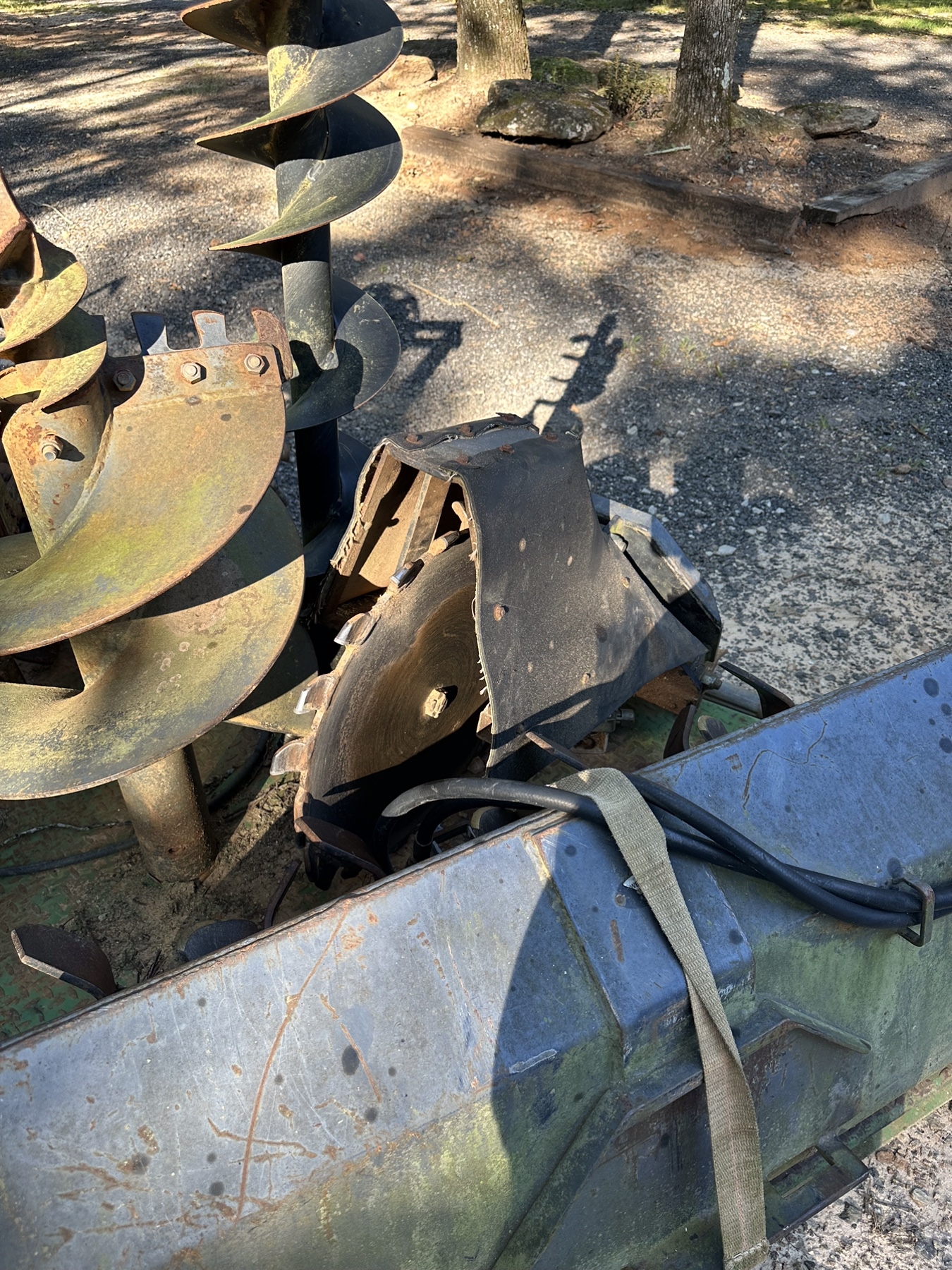

Just a note about the stump grinder. Very useful to grind stumps to ground level or lower. Can also dig holes. Quite messy, however, and it fills the front of the 422 with debris. I wear a full clear face mask as you can hurl stones inward. I've also hung a piece of an old tarp from hooks band clamped to the ROPS for more protection.
this is what I did to my stump grinder some old conveyer belt did the trick

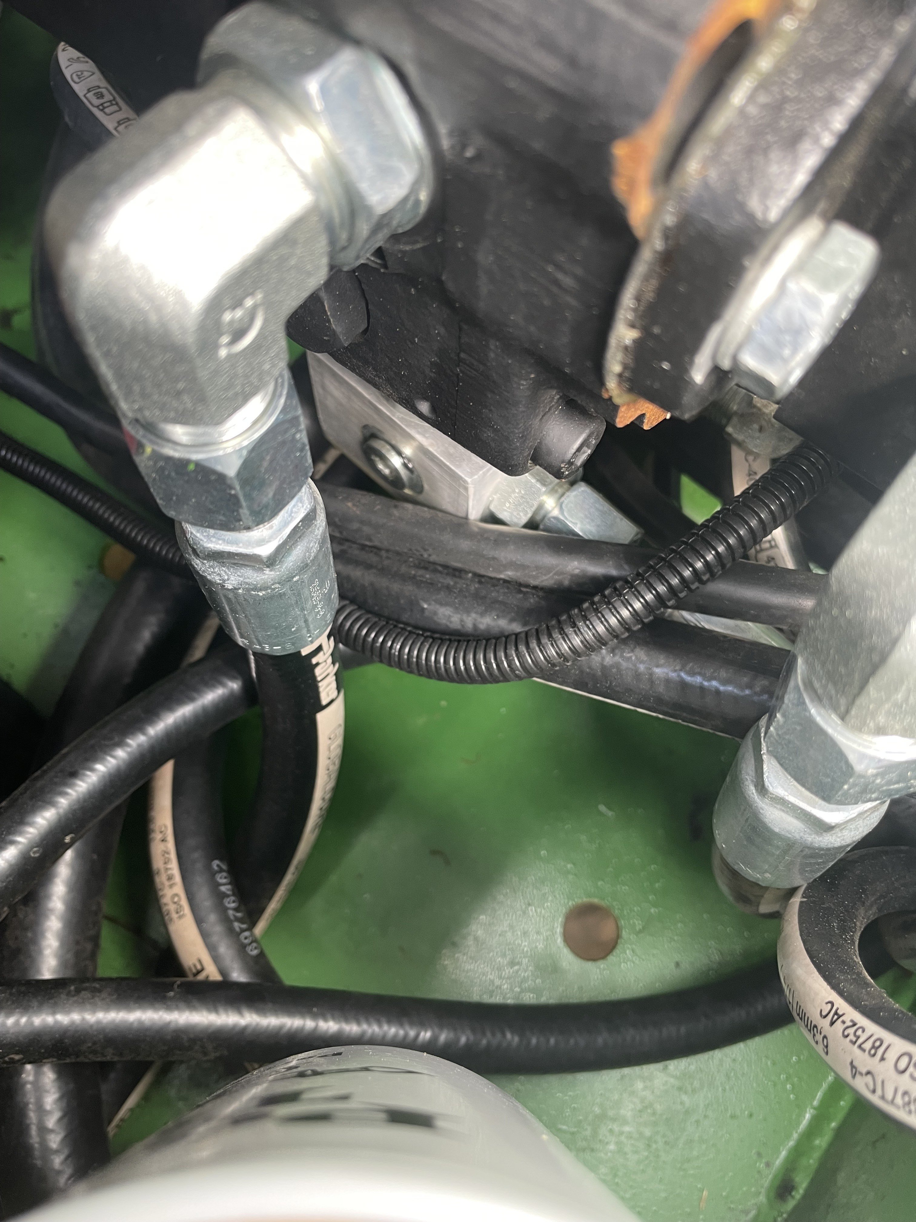

All tractors, and all machines of any kind, will eventually break something. This is my personal experience. As my pt422 is my first experience with power-trac, some problems I've recently had were hydraulic leaks from 2 loose ports underneath the variable volume pump. Both just needed to be tightened with an Allen wrench, with some Permatex Green applied after tightening. But the secondary problem was the amount of fluid that leaked everywhere. Can't be good environmentally. I now park the machine on pieces of cardboard that will soak up any leaked oil, or put pieces of cardboard next to the rear wheels where remaining oil from the body flows out.
Other than that, I love that the machine has a low center of gravity, making it somewhat safer on hills. I do use the seatbelt, and you do need to take extra care always when you're sitting on any powerful machine.
