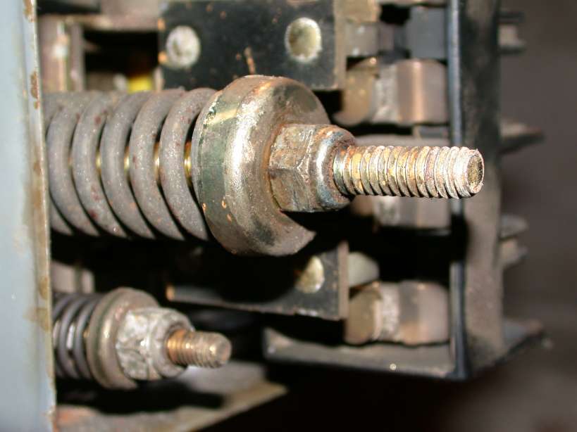

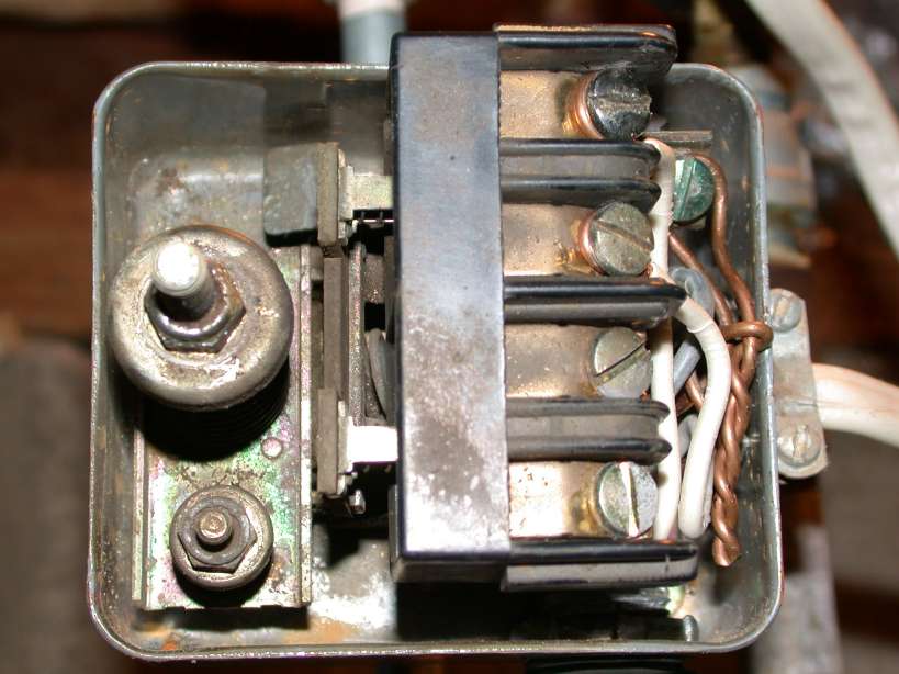

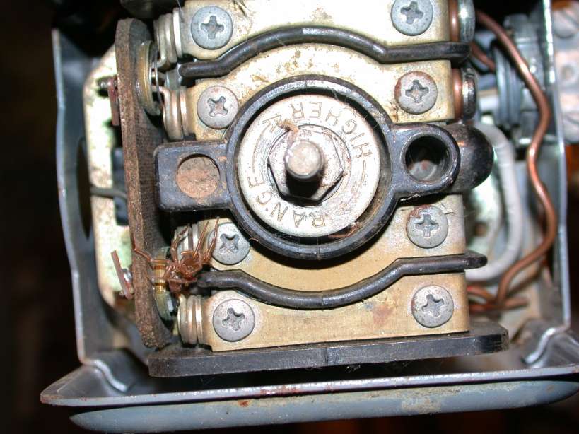

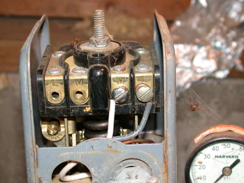

The first pressure switch is wired to the second one. If you only have one pump in the bottom of the well I can't understand what the second switch is for?
Try disconnecting the top pressure switch all together and run the water system and see if it's even doing anything.
In the house do you have another blue tank like the one you you say might be for the water hammer issue? That looks like your bladder tank which regulates your system. With an 80 gallon retention tank in the house I'd be surprised if you need another bladder tank in the house.
Sounds like you lowered the pressure and for the moment I know that was the objective but when time allows sir I'd get a working pressure valve in there to see what your system is actually doing vs guessing. That way you can set the pressures correctly without educated guessing.
/ Pressure switch on well PLEASE HELP! #22
Looking at your switches I would say he is using one for a cut-in and the other for a cut-out. Otherwise there would be four leads on each switch. You only have two leads per switch. Why? God only knows. My sister had a bozo wire in two switches on her pump. Not only were both hooked up. But he had them both setup the same way. The pump would sometimes come on and sometimes it wouldn't if one switch was open. You need to use only one switch. Rewire them to make it right and remove the other switch. You should have the power (black) and neutral wire (white) and two wires for the pump (black and white) in one switch box. On my switch the black wire is on the left side left screw and the white wire on the right side left screw of the switch. The same color wires from the pump connect to the other two terminals. Black to black, white to white. The small nut is or the cut-in pressure. The large nut is the cut-out one.

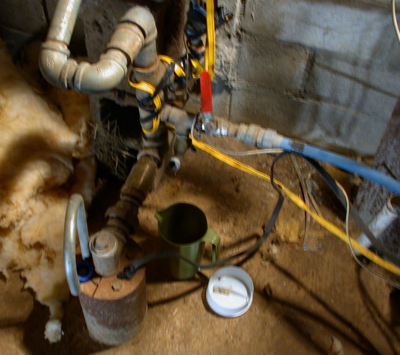

Very good plan! The problem you will still be left with is having the pressure switch gauge at the well and the tank/house at a different location. Makes getting the pressure dialed in a bit more complicated. You should aim for a 40/60 setting -at the house-. You will need to compute how much additional pressure you need to set at the well to allow for the elevation distance. .43 psi per foot rise. Over the distance you are running with 1 1/4" pipe the pipe restriction (unless you have a -lot- of elbows) shouldn't be enough to matter.
You will still need two gauges, one at the well (I see there is one there already but apparently not working) and one at the house to verify your settings.
Be sure you have a PRV valve on the water heater. I have seen the results of one of those tanks blowing and it ain't pretty. From you discription of the rest of the system I suspect there isn't one.

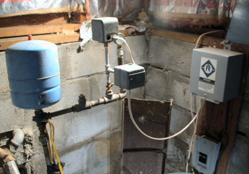

Ooops, I should have mentioned that I have a relay in between the pressure switch and the pump. I forgot all about that box. It should be mounted near the pressure switch on the wall. Need pictures of either? I'll take them for you.

Guy who installed my system had about 35-40 psi in the bladder tank. This is the optimum range for the bladder and it should be also for his system.
What I'm wondering is does he have the bladder tank in the house? Or is it in the pictures mounted there. Looks like a 10 gallon tank. Don't need much more with the 80 gallon in the basement.
I'd leave the set up alone and leave the switches in the pump house. It's not worth the aggravation to move it all. His set up will work fine

You have a few different problems but one that has not been addressed as of yet. The location of your well expansion tank should be within 10 feet of your pressure switch. With the location of your expansion tank up at your house you can get a short cycle problem causing premature pump burnout. You can also get a high\\low pressure problem.
The little x trol tank located on top of the tee is all but useless for a pump of that size. More than likely put in to try to cure the existing water hammer and pressure problem that you have.
The other items have been addressed on the switch and the tank no load pressure setting. I have always taught 3 psi before pump cut in.
For now I would start with a new pump switch and go from there. Your still going to have to crank on the new switch to get any pressure at your house. Reason being--the 100ft elevation difference. For every foot you raise water you loose .433 in pressure. So don't think your going to put a new switch and all will be well at the well.

But it would be in your best interest to move your pressure switch up to your house. Yes that would involve alot of work but that is the correct fix to your problem. /forums/images/graemlins/mad.gif
