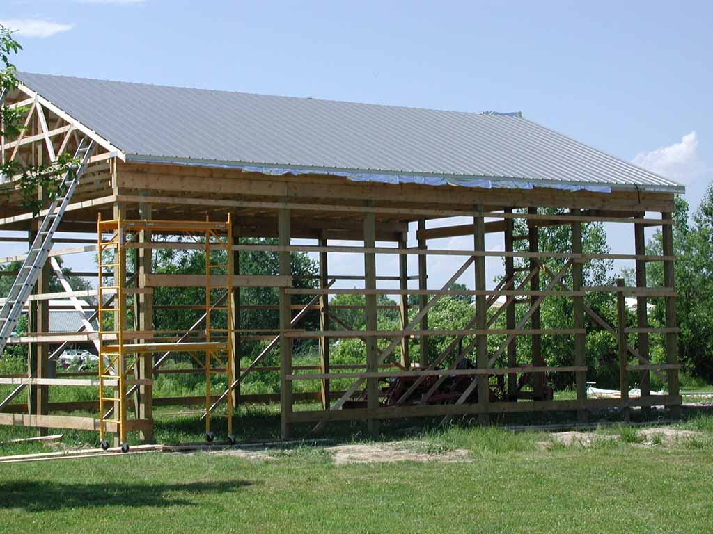

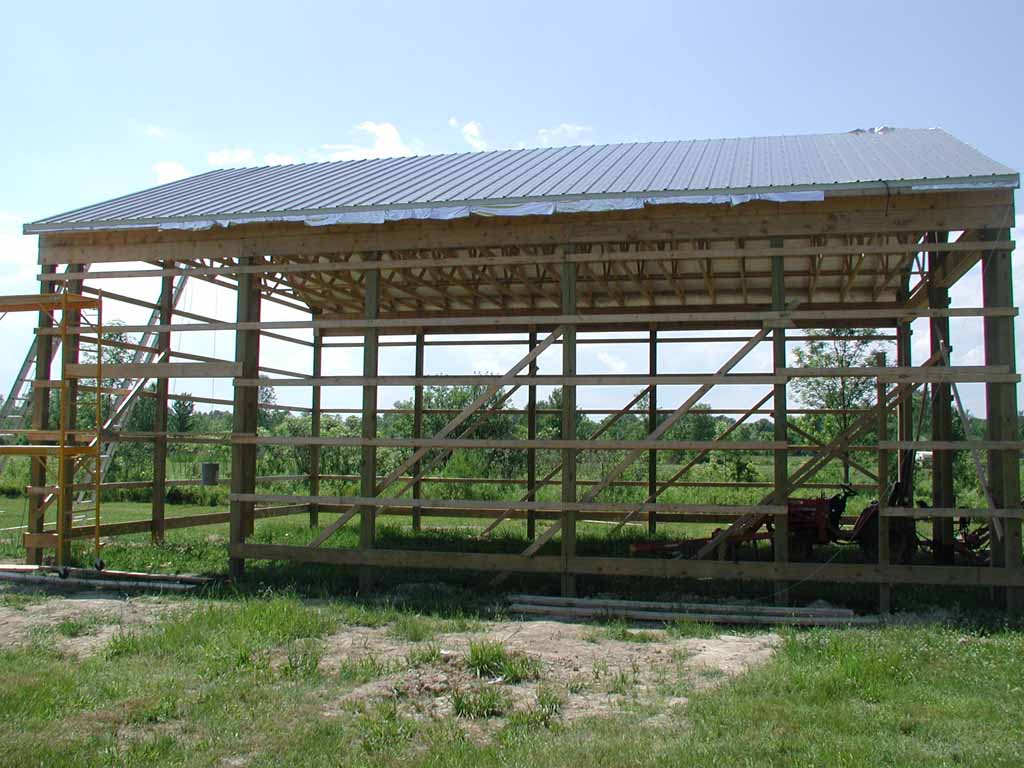

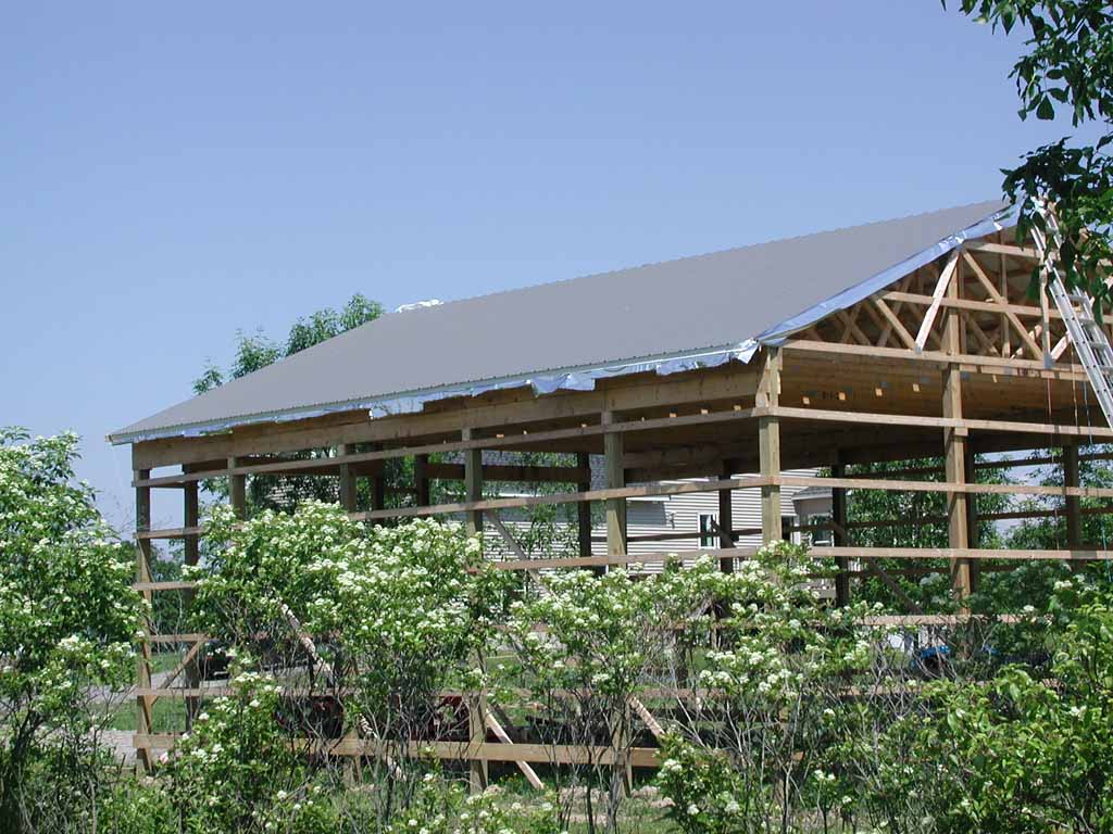

Finished the Roof sheeting yesterday and this morning. Had my brother and a friend over to help and we had a few missed screws on the roof. If they start to leak I will fix them a later time. On to the pictures! Her are a few shoots of the roof set. Hopefully the wind will not be an issue with the roof becasue it is going to be a few weeks for the sides get done!
Still need to put a few screws in on the first 2 sheets and the foam stuff under the sheets as I put them up the other day and did not get to them but should only take a 20 minutes to finish it up.
Enjoy!

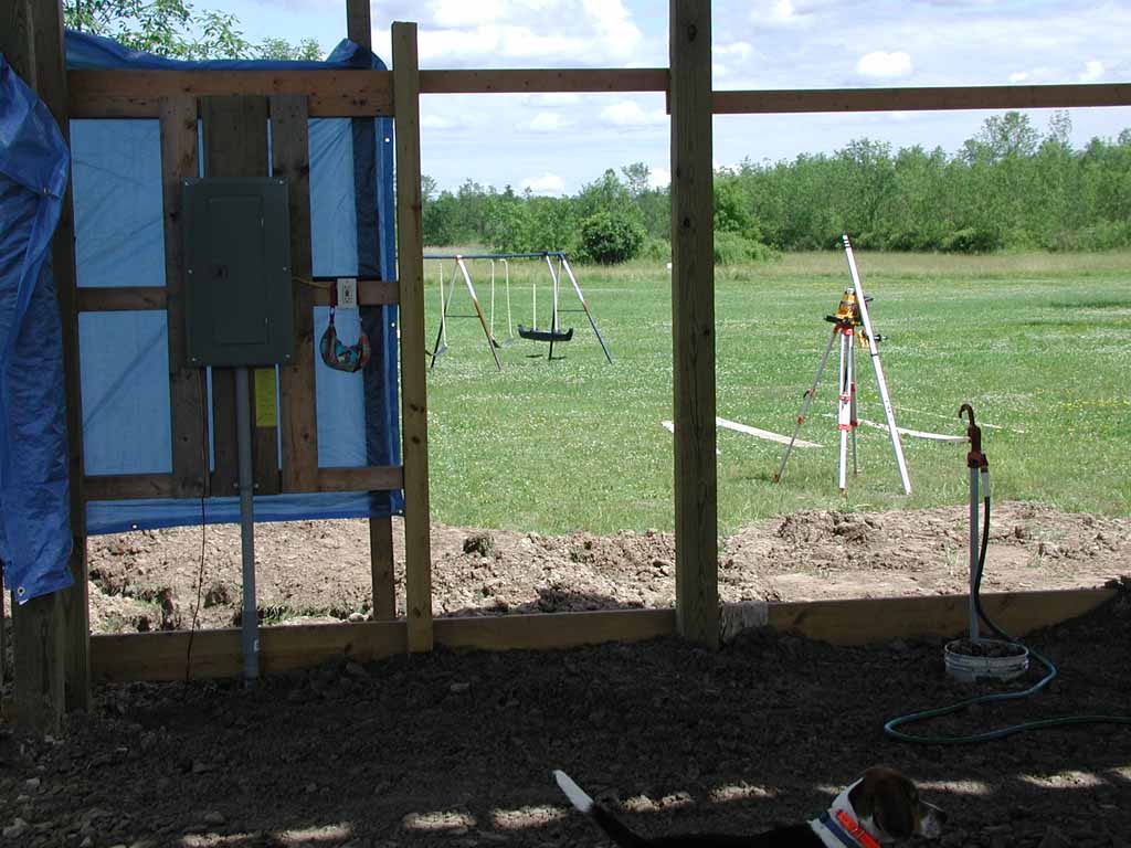

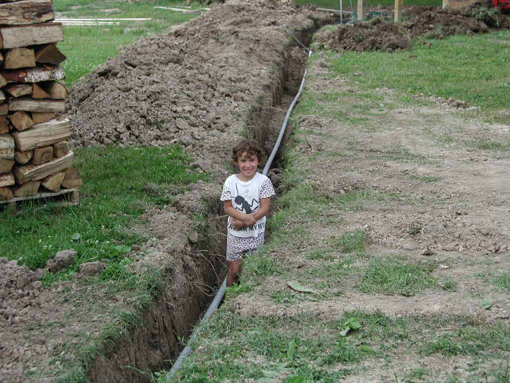

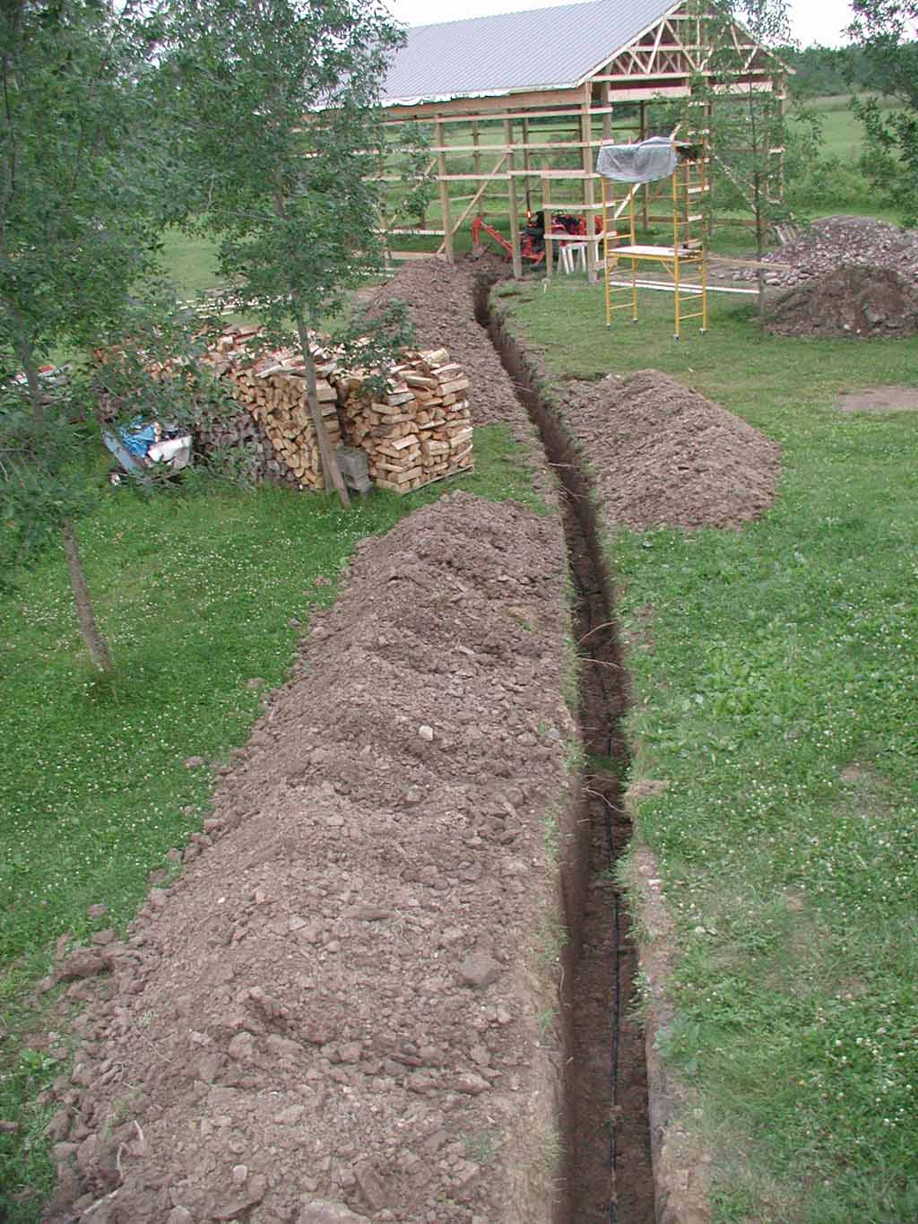

This weekend was dig water line and layout the electric. I have tomorrow and Tuesday off so I will run my cable TV, telephone, and internet line. Hopefully I can get the electrical inspector out tomorrow to look at the trench so I can back fill it. Enjoy the pictures and will post more shortly.

When I built my shop I had to meter it and I had to place my electric 4 ft deep from the transformer to the shop ... about 110 ft. Nice looking shop you are building! I like it!

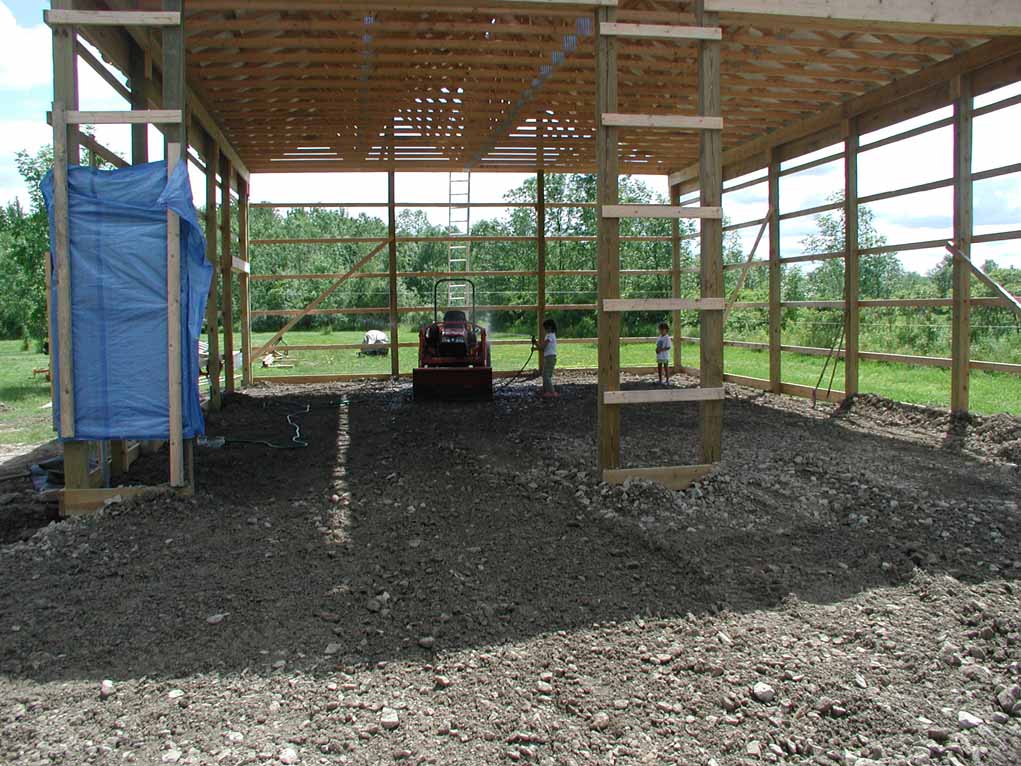

em14, Running electric off a meter has different requirments. I think in NY state you need to bury the main feed 24" as I recall when I built my house 4 years ago.

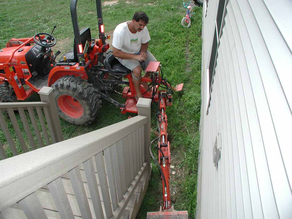

All, After 3 1/2 half days of continus work I have water and electric in the barn but no cable, telephone or internet. To much work and not enough time to get things done. I also moved 6 truck loads of bank run and 2 loads of #4 stone. As you can see in one of the pics I still have 3/4 of a load to move but now that the mad rush is over I am going to take a break. Electrical inspector stoped out today and passed the inspection! Only issue is I need to put white tape on the neutral as the wire does not have a white stripe on it. He said he will very when he comes back once I have the place all wired up. He did say he liked my nice neat wiring job!!!
You can see the kids cleaning the tractor in one of the pictures. I have to say that my Kubota B7510 can move some material for it size! I have clocked 15 hours the machine since Sunday and my BUTT hurts!
Here are some updated pictures.

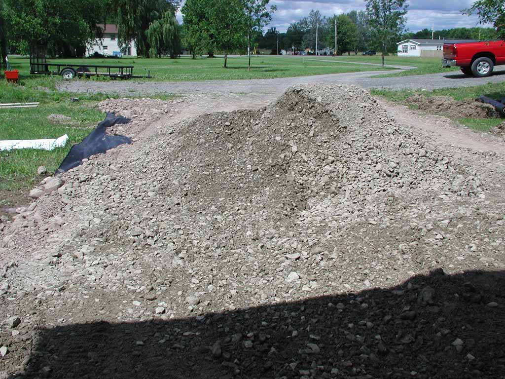

pemad, just curious how much that bank run costs?(per truck load).
when you did your driveway did you put something down 1st? Or is it just bank run all the way?

streamin - Here are the steps I took for the barn/driveway.
1) removed top soil.
2) laid out Mirafi under layment.
3) spread the bank run. - killer as it contains football size stones and sand!
4) Topped off with #4 crushed stone.
When the ground has settled in a couple of months I will have the guy deliver 2 load of run-a-crush to put over the top of the driveway and barn floor.
Bank run was $160.00 per load. The killer part is the guy charged me $110.00 per load when I built my house 4 years ago. I guess with the fuel prices the cost has gone way up!
Next week I will be getting 6 or 8 loads of fill from a guy down the street for $30.00 a load to box in the barn around the outside and I will put the top soil I removed on top of that material.
Enjoy!

"2) laid out Mirafi under layment."
Do you feel that is a necessary step, and how expensive is it? I will be doing a 200 foot driveway and I don't want problems.

streamin,
Where I live it is all clay and the ground gets real soft in the spring and fall. Mirafi helps stiffen the driveway and will not let the stone sink into the clay. So for my area I would say yes but I am not sure what the soil and weather is like in your area. A 500' roll 12' wide cost me $369.00. For my area I consider it cheap insurance!

I also have used a lot of that geotextile under driveway and other areas (behind walls, under stone patios). I know some think it is a waste...I do not. It really is cheap per sqare foot and saves a lot of heaving, holes, weeds, and instability later. It is amazingly tough stuff.
