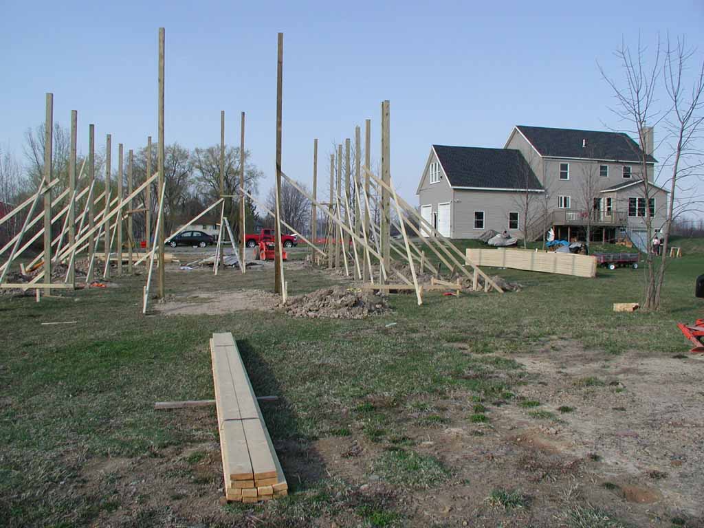

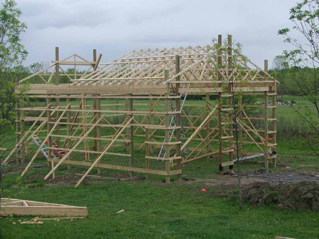

Tried to get a few trusses up this weekend in between the rain. Gets real slipery when water is on the boards so I am calling it a day! Here is a updated picture. Maybe next weekend I will have all the trusses set! All depends on the weather.

/ Pole Barn Started #44
Pemad,
I was just wondering if you would mind letting me know the cost of your barn, I have been pricing 4 different companies and seems DIY is the cheapest.You can PM me if you like.
They say that they are going to have a 20% increase the 1st part of june so I need to pull the trigger if I want to save the money, of course mine is larger but gets me close.
How have they been to deal with, do they offer any help or "here are your materials" type.
Also, they say that the 4/12 roof is enough in cat county(snow belts) but I see you went more.Did you have to get a permit approval?
/ Pole Barn Started
#45
streamin said:
Pemad,
Cost was around $8,900 for the material minus the garage doors. I did a bunch of upgrades from the standard pacakge. 3 garage doors openings instead of 1 slider. 14' tall walls unlike the standard 10 or 12' packages they sell. Added the reflective material for the roofing. Went with a 5/12 pitch roof with 1' overhangs and spaced them 2' on center.
4/12 pitch is fine as the manufactured trusses should comply to your local codes. I went with 5/12 to get more snow to shed off the roof faster. Less build up.
I did have to get a permit, town needs it's tax money :)!
As for DIY, Mike and Brad are super to work with. All my material was delivered as expected. Nothing was missing. I have called them a couple of times with questions and they always taken time to help me out. I would recommend them as they have come through with all there promises.
I did get other quotes and they were the cheapest.
1 thing I would recommend is that you ask them to upgrade the truss supprts to #1 grade(not sure if this is correct) as the #2 grade 2x10's that I recieved were not that greatest and I had send some of the boards back for better ones. I am sure it would not cost much to upgrade.

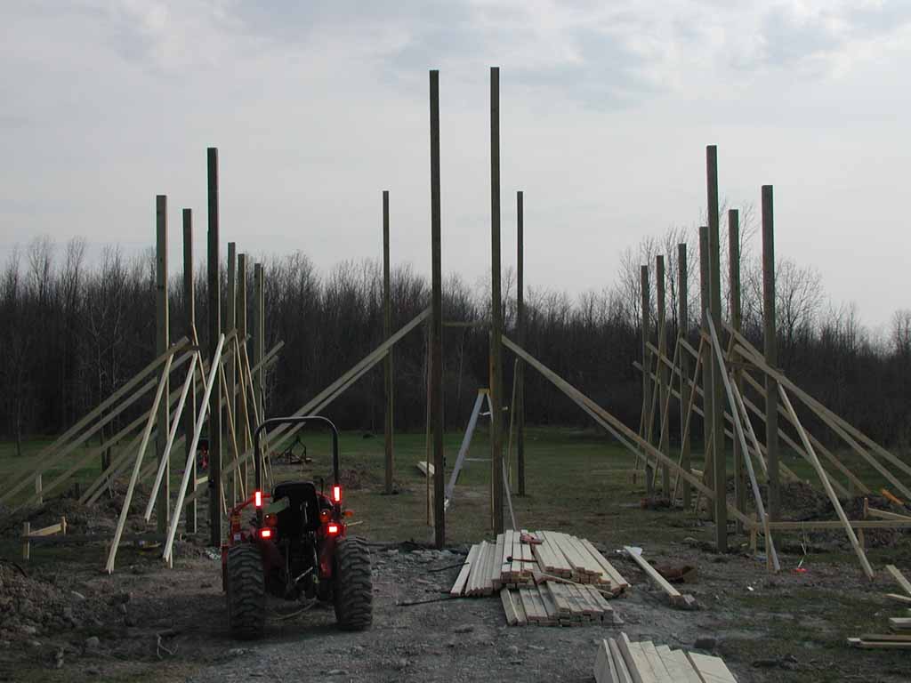

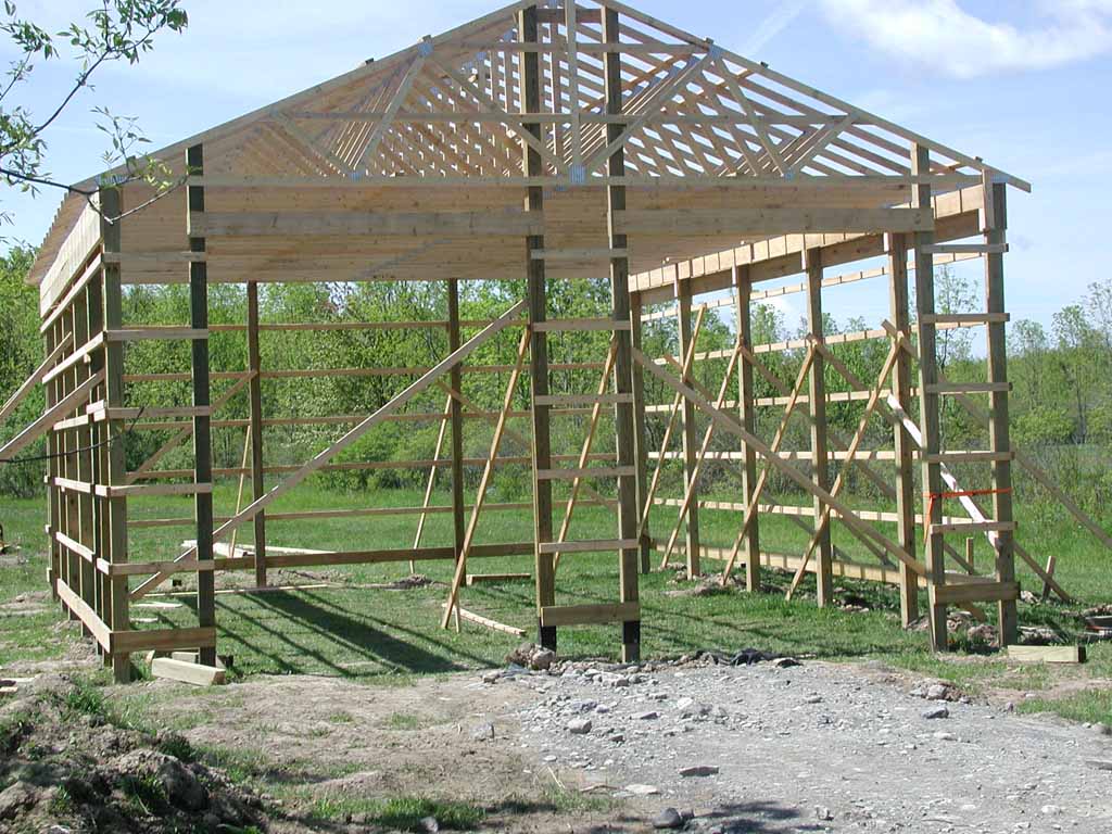

More pics on progress. Heading to camp so I am not sure if I will make too much progress over the weekend!
/ Pole Barn Started #47
When they quoted me on a building(DIY), they did the trusses 4 ft on center.I see yours are a lot closer. Is that what the inspector recommends or is it overkill?

#49
I went with 2' on center becasue of 2 reasons.
1) In case I wanted insulate an sheet rock the inside I would not have to put furing strips up.
2) I noticed a lot of pole barns that have trusses 4' on center have sags in the roof. I assume the 2x4 purlings become weak after a while with all the snow we get up here in NY. So I am hoping this will not happen to my building.
4' on center is fine as most of them are built this way and the inspector did not care one way or the other.

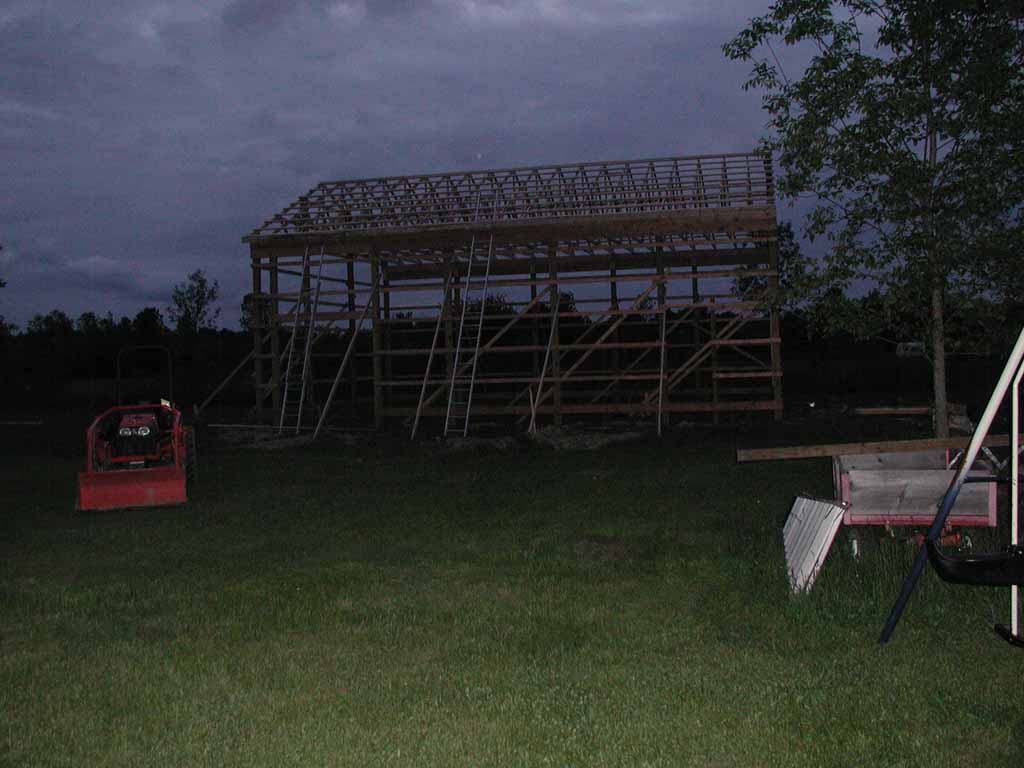

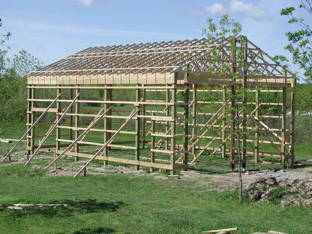

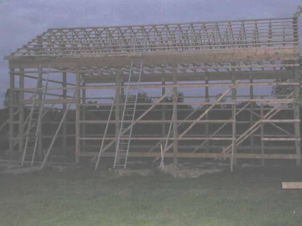

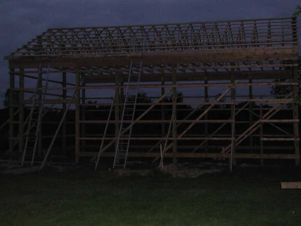

Worked on the pole barn a little today. Did not get a lot done but finished setting the purlings on 1 side along with fascia board. Took a few pictures but it was late so they did not come out the well. Posting then anyway.
/ Pole Barn Started #52
Here you go PEMAD, I just used a brighter flash on your pics so we can all see your hard work.
No charge.:rolleyes:

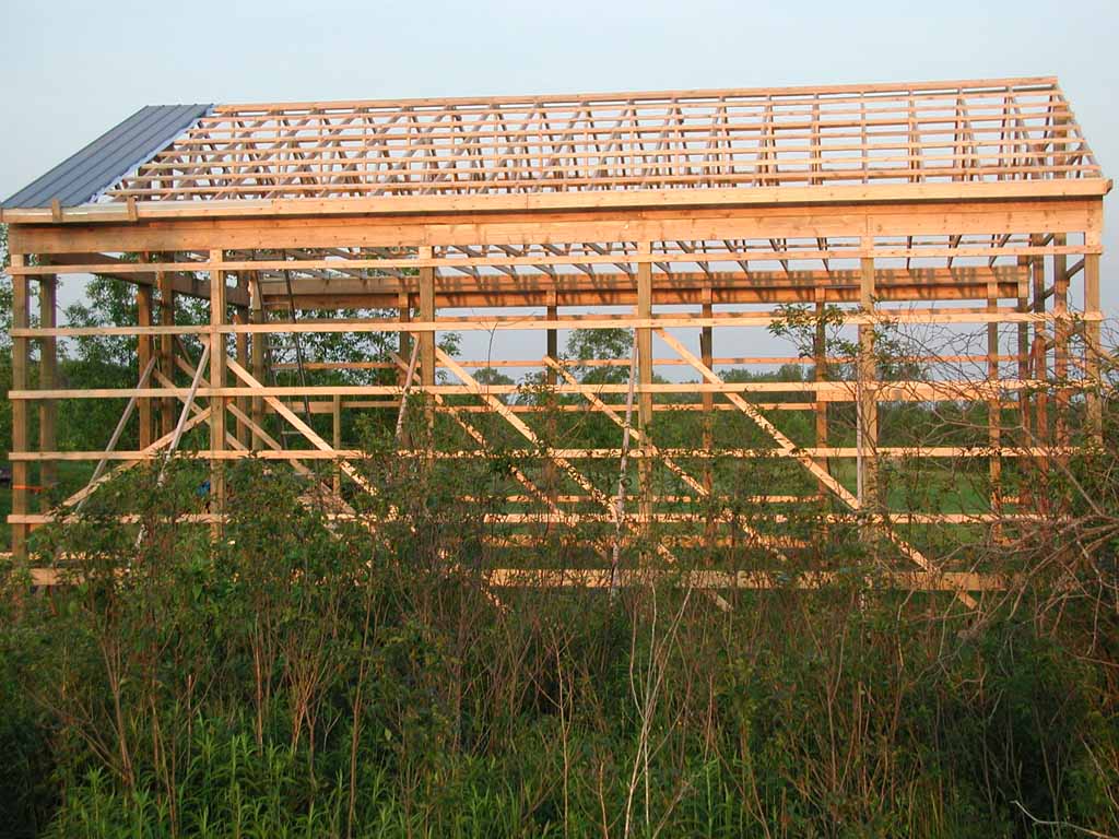

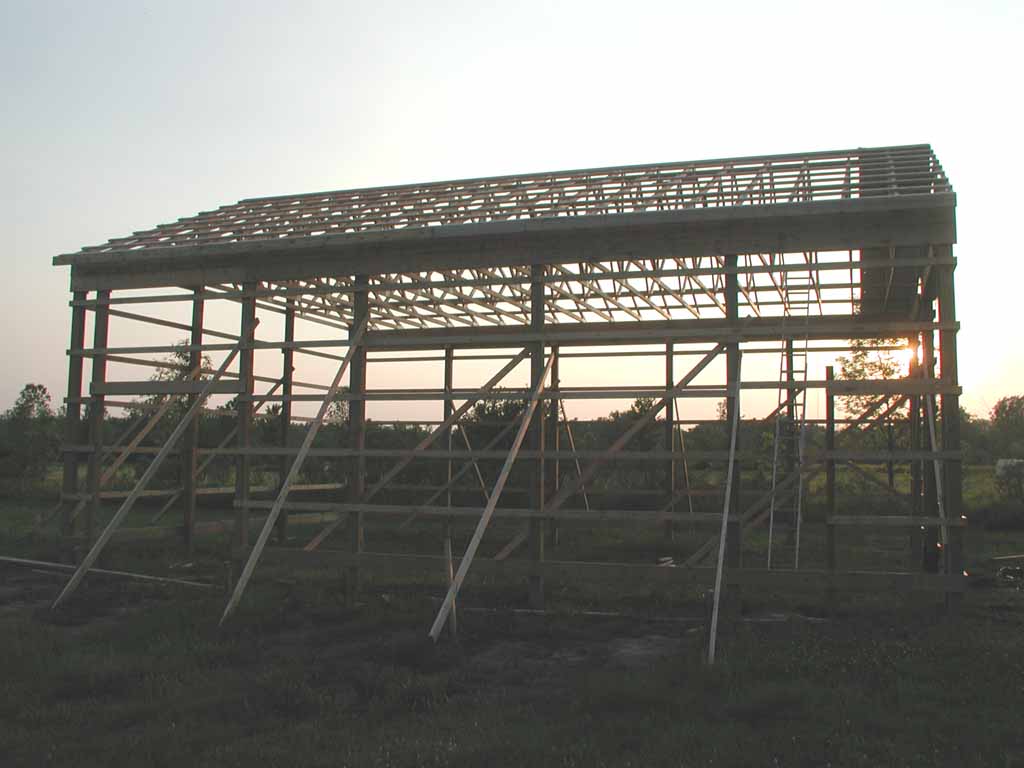

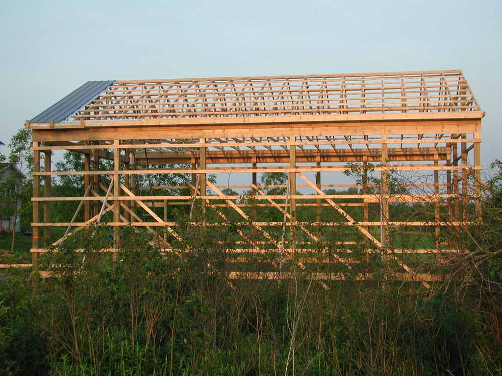

Made some progress this weekend. We had 90 degree + days Saturday and Sunday and T-storms on and half. I did get a little done. Finished the purlings and put the first sheet of metal roof up :) !
The sheets are 17' 3" long and it was interesting getting that first sheet up on the roof by myself. I figured out that I have to walk it up the ladder and flip it up on the roof. Not an easy task! Anyone else has suggestions on how to get monsters up on the roof fell free to speak up.
The other thing that took a few hours was squaring the sheet on the roof. I ran a string line on the top ride and worked off that. The issue I had was the roof peak on the outside was leaning in and I could not get that sheet to run stright down the gable end! Anyway I pulled the roof a little and bingo the sheet fell right in to place. I have no idea how it started to lean but the trusses are level now :).
The other thing that is fun is laying the pastic on the roof before putting the metal down. I figured out that if I staple it at the bottom and just tack it on the ridge then lay the shet over the plastic and before I put the first screw in the sheet metal I pull up on the sheet it will just slide into place.
So here are some pictures.
Enjoy!

/ Pole Barn Started #56
I know what you mean about getting that roofing up there. I built mine myself, I ended up grabbing the edge of the sheet in the middle and carrying it up the ladder with one hand, then grab with both hands and flipped it up on the purlins, then slid it over. I put a temporary stop at the bottom to keep it from sliding off before it got screwed down. Couldn't take pictures, my hands were full trying to not fall off the ladder :)

Yeah getting them up on the roof stinks and if they slide and your are in the way you are in trouble. They will cut you in half. You can see in the pictures I posted I put a bracomg on the eve to hold the sheet in place so I can adjust them.
I had a bright idea tonight after work and figured I would throw up another sheet on the opposite side of the building so both sides are squared up and ready to go. And it was only 92 and humid outside! Well I headed up the ladder with the sheet and I kept saying to myself, dam this sheet is much heavier that the other sheet I placed on the roof! After I got the sheet on the roof and in place I noticed I had 2 sheets stuck together. That was a dumb move on my behalf. 2 sheets are way too heavy for me to handle and put on the roof! It could have been real ugly if they let loose while I flipped them on the roof. Lesson learned: ALWAYS check and make sure you picked up only 1 sheet!!

to keep the roofing from sliding off before screwing it down, I nailed another 2x4 on the outside of the facia, and then nailed some short stop pieces onto this 2x4 that held the roofing in place with about a 1" overhang. this kept my roofing lined up. The key is getting the first piece of metal square, which when working alone is not easy.
I ordered my "kit" from APM near gettysburg PA, I priced all the pieces myself and I could not get it any cheaper. They also included delivery. They were great to work with, will configure it any way you want it. One thing they did not include is extra 2x4s for bracing, but I considered that when comparing prices.
It's looking nice, you are making good progress in this crazy weather we have been having.
