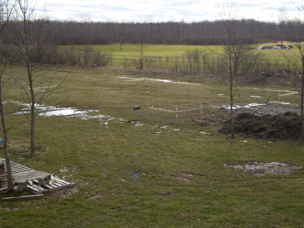

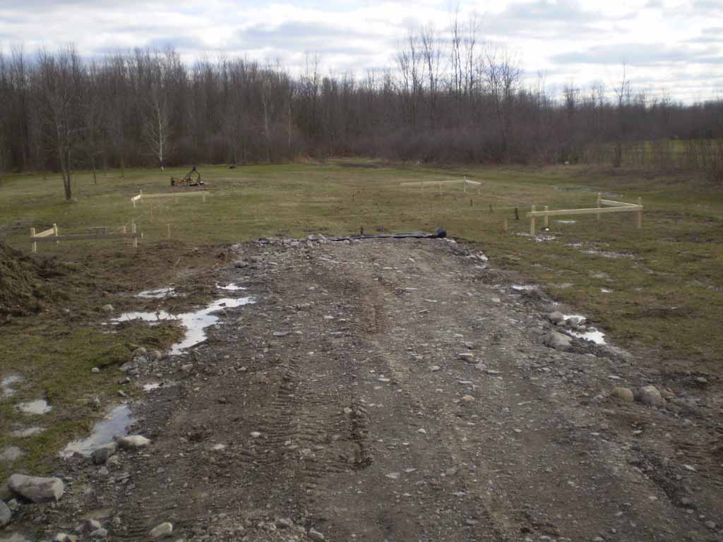

I decided to build a pole barn this year for my tractor :). I staked out and squared up the barn today. That was a pain in the butt doing it by myself! Between my laser, tape measures I got it all squared up :)!
Here is what I am building.
30x40x14 Pole Barn
Roof Pitch 5/12 with 1' over hang on the eve sides.
2 10x12 garage doors in the front
1 8x7 garage door in the back corner
1 enterance door.
Hoping to run water and electricity to the barn and pour a concrete floor. It is going to be a long summer putting this thing together. Lumber will be delivered Wednesday and I am hoping to punch the holes in the ground and set all the poles by the end of next week as long as the forcast does not call for rain.
Here are some pictures of the started project.

Pemad.....Just getting started is one of the major hurdles. Congrats on getting it laid out.
I am going to build a 30 X 50 this summer....well have it done. I built a 24 X 27 three years ago and it about killed me. Not as young as I used to be and getting help is always a chore. Think I'm going to let the professionals do it this time.
One question.....why a 5/12 roof? Storage in the rafters? The one I built is 3/12....not too conducive to overhead storage.

pemad,
Congrats on your project. Barns are always the most fun to follow along with on the building, as there is so much variety in how they are built all over the country.
I'm curious about the one foot overhang. Is that to match the house?
How will you be siding it?
With 14 foot walls, how long are are your poles? 16ft is standard length here, so anything longer will be a premium. For 12ft walls, that works out great. I've never gone taller, so you're in new territory for me.
The reason I ask about the overhangs and wall height is because it's just a matter of time until you want more room. Adding a lean-to onto the side of a barn is a very simple, affordable way to create extra space. If you don't think you will need it today, it's still a good idea to have that option in the future.
Thanks for the pictures, it's a good looking location for the barn Very nice indeed!!!!

Eddie,
Thanks for the congrats as it will be an interesting and long adventure :)!
I went with the 1 foot over hangs becasue of 2 reasons. First reason was to shed the snow and rain away from the building and the second reason as you mentioned, it will match my house to a T!
Poles vary for the barn. I am getting 20' poles for the sides and 26' poles for the gable ends. The cost was roughly $60.00 for the 20' poles and I think the 26' poles were around $80.00. As you can see from the picture I have not graded the land as I will do the grading after the poles are set. I am going in the ground 4' at the highest point of grade and will bring in 1 foot of material. So the poles should end up being 5' in the ground and no wories about frost :)! I will be placing Mariafi 500x (not sure of spelling) under the gravel.
I thought about expanding in the future and I decide on 2 options if I want too. 1) I can just pull the back of the building apart and extend it x feet so all I will need is side and roof steel and a few trusses or 2) add a lean too on the back as you mentioned. Really did not think about adding to the sides but I could just tie into the eves and run the same pitch out.

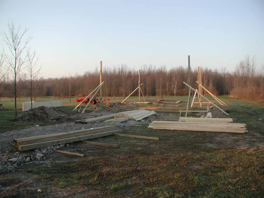

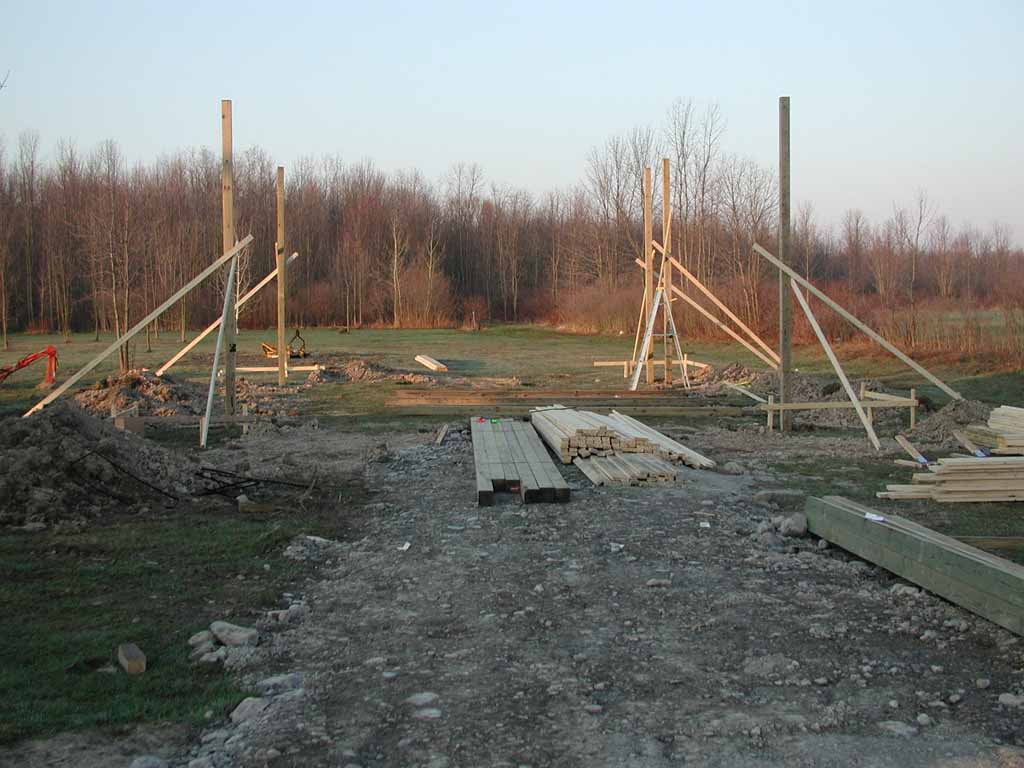

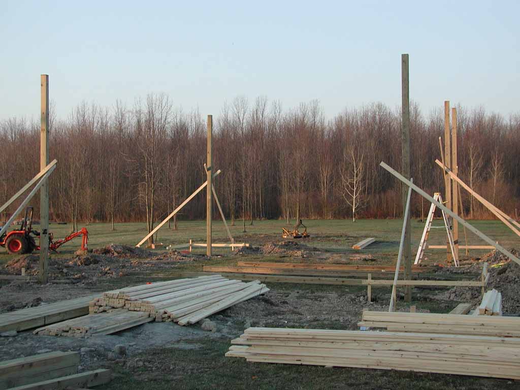

Update on the pole barn progress.
Dug all the holes yesterday with the 3pt back hole which took way too long! It took me rougly 5 hours to dig all the holes. That was a lot of seat time. I filled each hole with 3 bags of 60lb concrete mix which took me another 2 hours. Pre-mixed the concrete depending on how much water was in the hole.
So today I had the holes inspected by the town and this evening I decided to place the first pole when my wife got home giving the concrete 24 hours to cure. I have to say Placing a 20' pole in a hole with a B7510 tracktor was and adventure. Scared the heck out of me at first as my tractor reach is only 7' but once the pole slid in the hole I was over half way up and it balanced it self. Tomorrow I am hoping to get the other 3 corner poles in so I can make sure I am square. Brother-in-law is coming over to help for a few hours. Hopefully we can get the 3 other poles in and square up the building. I will try to shoot some pictures tomorrow.
What is weird is that the 6x6 poles that were delivered were CCA and not the new ACQ. Must be they still sell CCA for ground contact 6x6 long poles as these poles were recently treated becasue they are WET and heavy!
/ Pole Barn Started
#18
Yesterday was HOT and I did not get a lot of time to spend on the pole barn. My brother-in-law stoped in for 3 hours and we put up a few poles. I have figured out the trick to installing these poles. Not too bad with the tractor. Brother came in last night and we are going to try to get most of the poles set today. Here are some pictures of the poles set yesterday.
