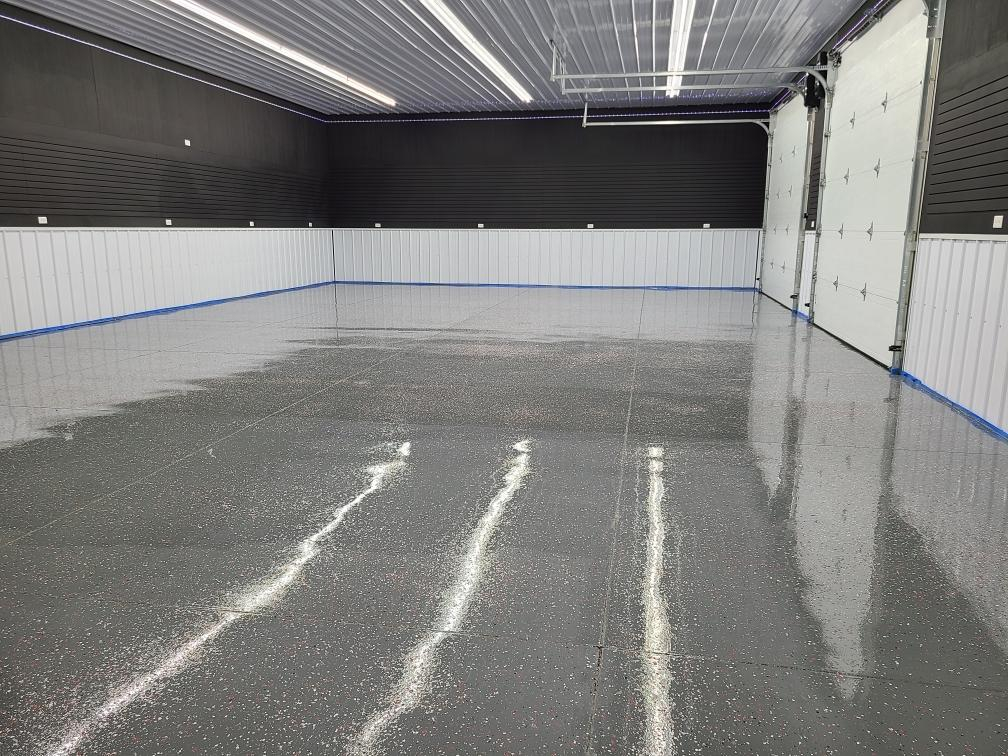

I used Hyperlight, lighting. Very impressed with the output. These are rated for wet conditions too, though the barn is bone dry. I will have to wait on any longevity claims.

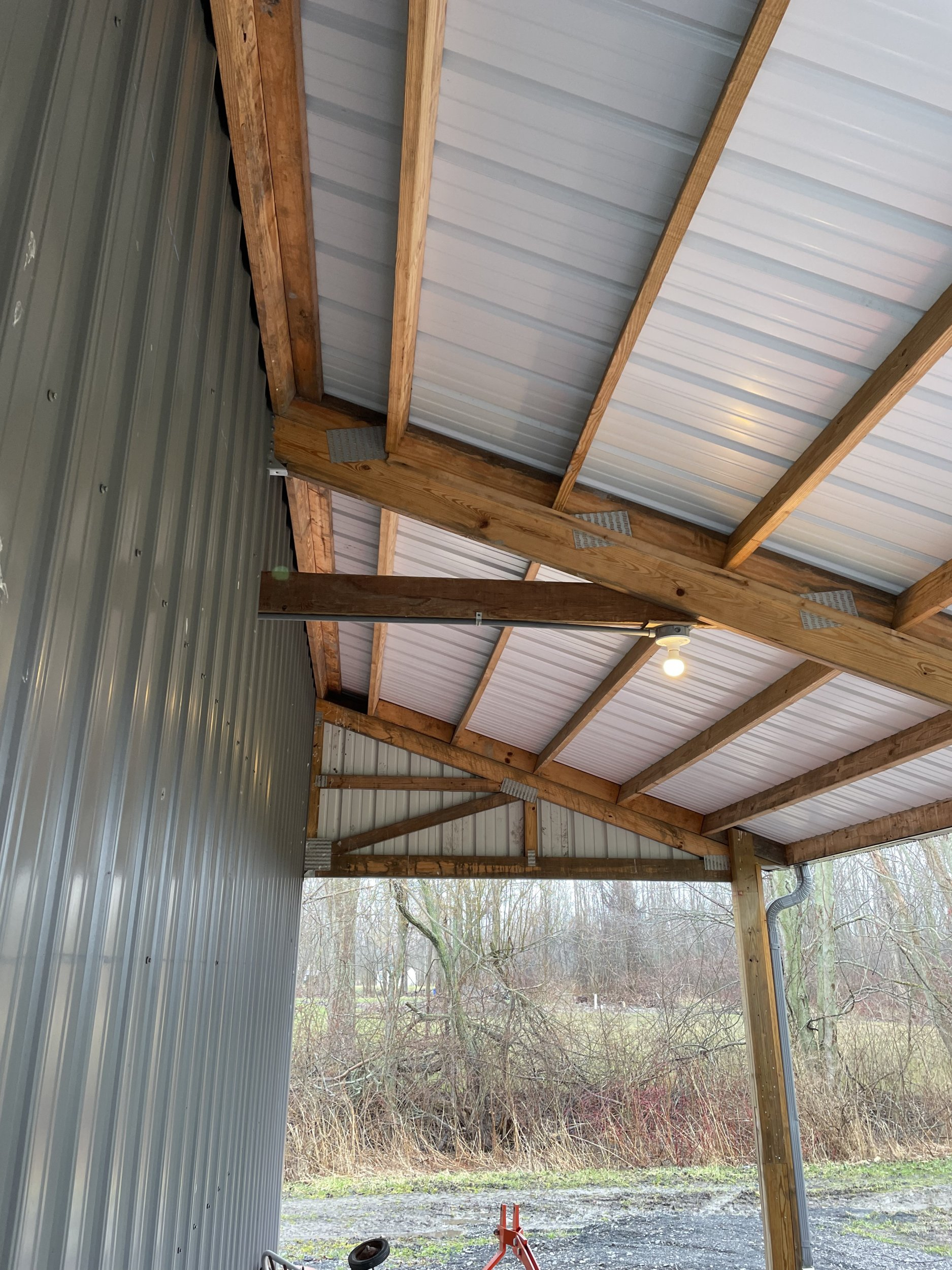

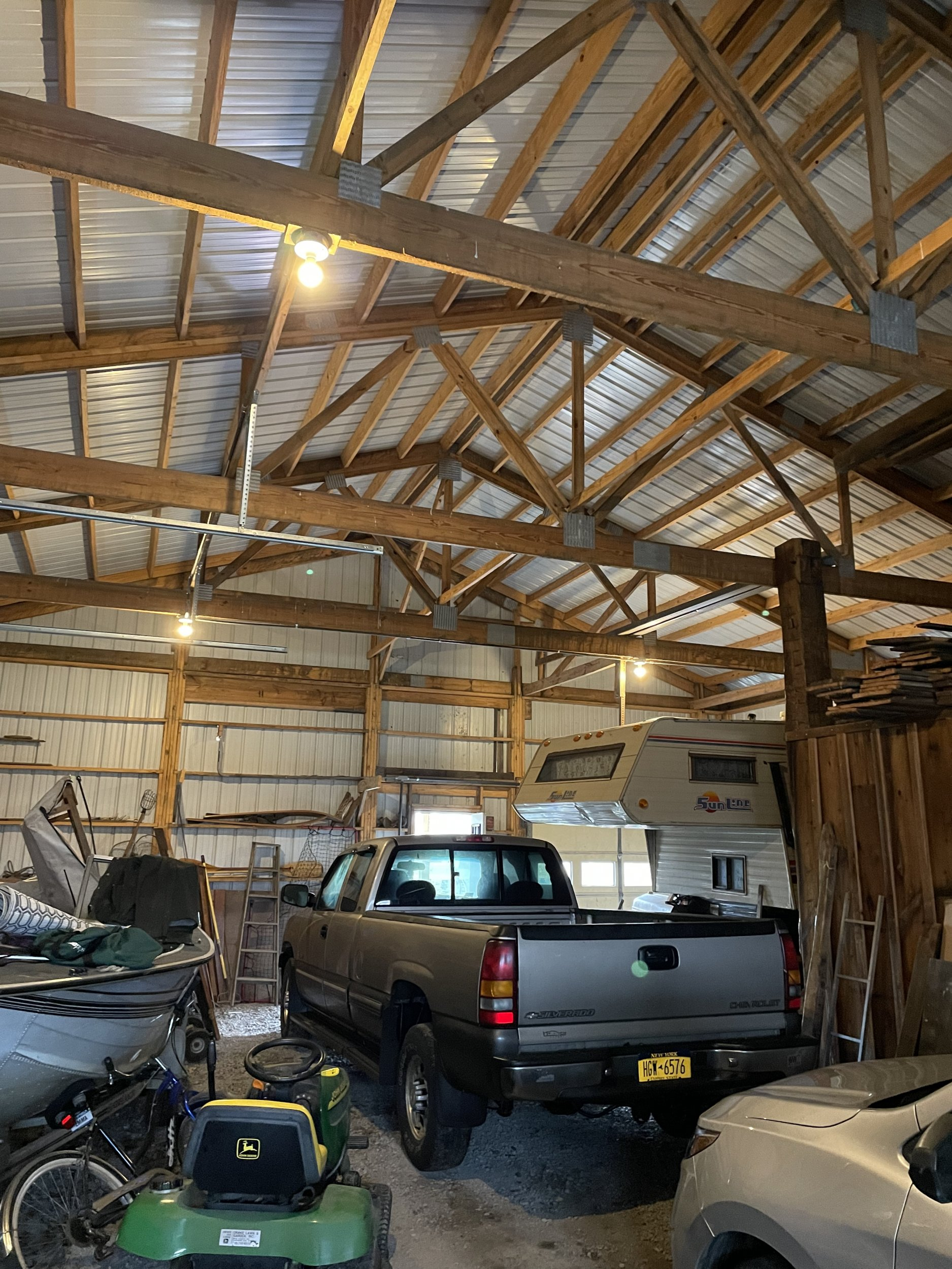

I wired my 36 x 50 x 12 pole barn this spring. I certainly didn’t overdo it with the lighting, but what I installed works very well. The main space has (3) overhead ceramic fixtures, in which I installed 60 watt eq LED bulbs (Walmart had those on sale for $ 3 for a 4-pack). The main space also has a 100 watt eq LED on a garage door opener up top.

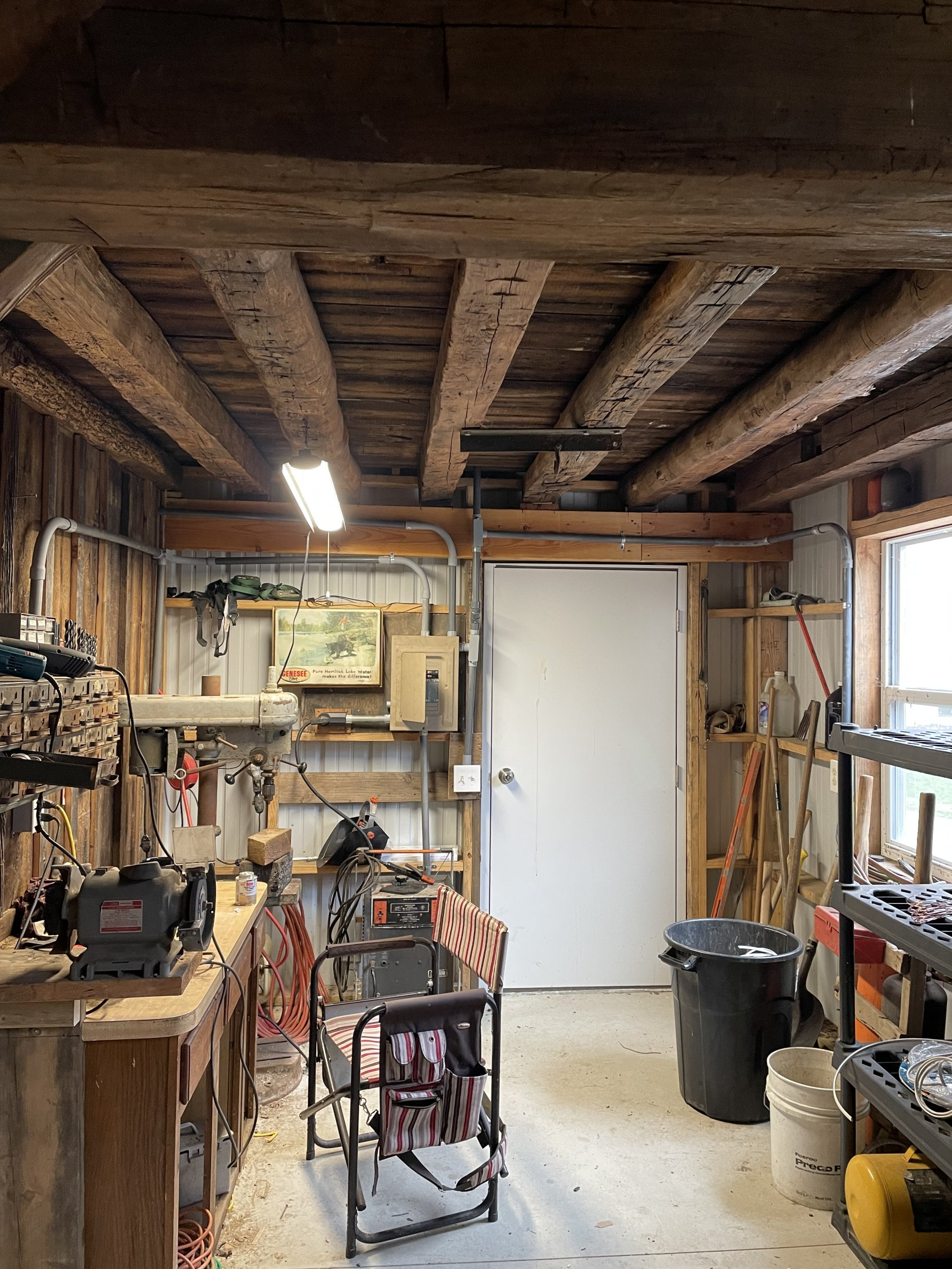

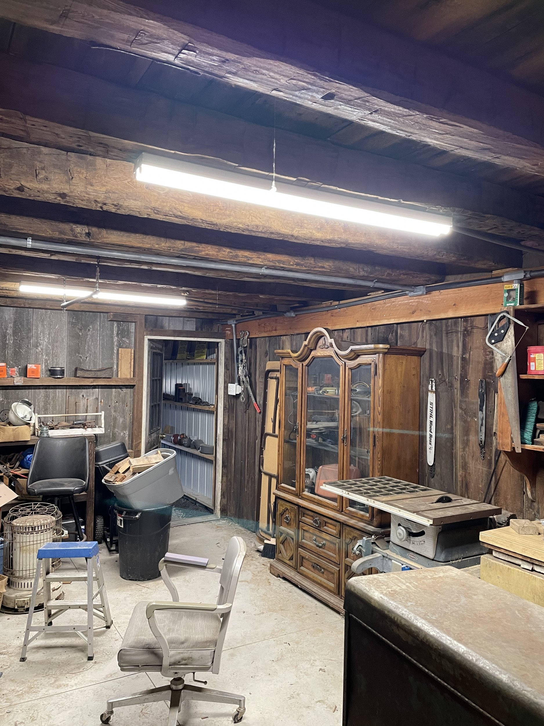

I installed (2) 4 ft LED’s in the 12 x 20 x 7.5 woodshop and (1) in the 12 x 10 x 7.5 metal shop that I built under the post and beam loft that I built inside the pole barn. Those little LED’s light up those shops extremely well.
I only have 45 amps running to the barn (including a 30 amp main from the house box to a sub panel in the barn and another 15 amps to an outside outlet under the barn porch), so I went light on the lighting. That left plenty of power for a small welder and some other power tools. I can even run the AC on my camper, that I keep in there, plugged into a 20 amp outlet, with all those lights on. That came in handy, during a few heat waves this summer.
The LED’s are amazing compared to the fluorescent fixtures I had in my old shop. Way more light, less power, and instant light even when the start up temperature is below zero.
