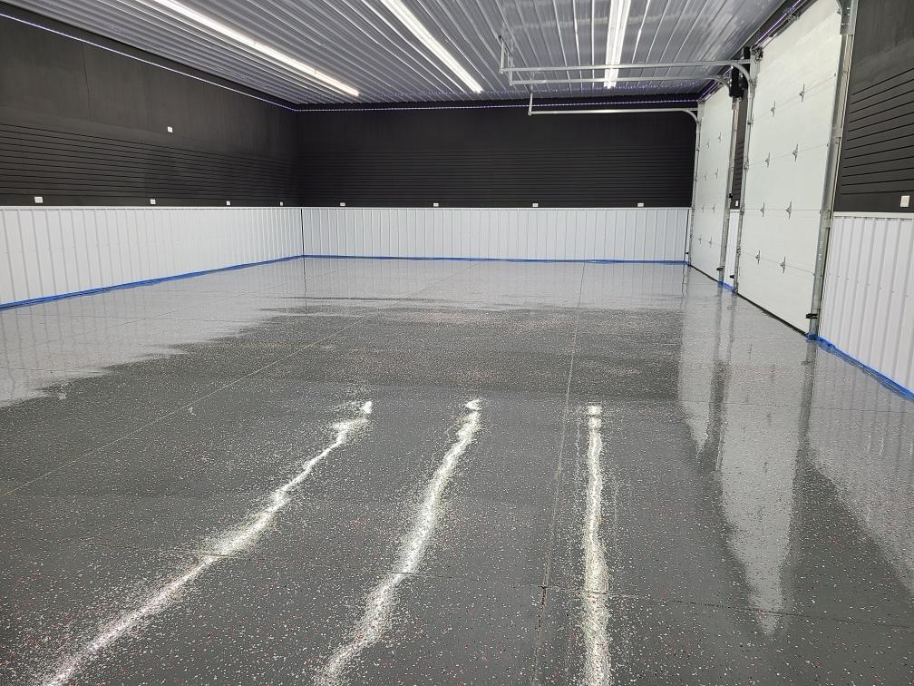

Well, I went with (8) 27000 lumen UFO lights. I’d say that is sufficient
/ Pole Barn Lighting Options
#33
I used Hyperlight, lighting. Very impressed with the output. These are rated for wet conditions too, though the barn is bone dry. I will have to wait on any longevity claims.

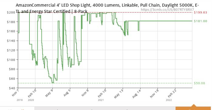

He went with the 8' led lights kids. Like $180 or so on Amazon for a 12 pack. I think they were 10-12k lumens each.
His shop was 30x56....and we did 3 runs the length of the building.....6 in a ach run for a total of 18.
And I can say it's one of the brightest shops I have been in. And only about $270 in lighting. Yes leds have came along way
