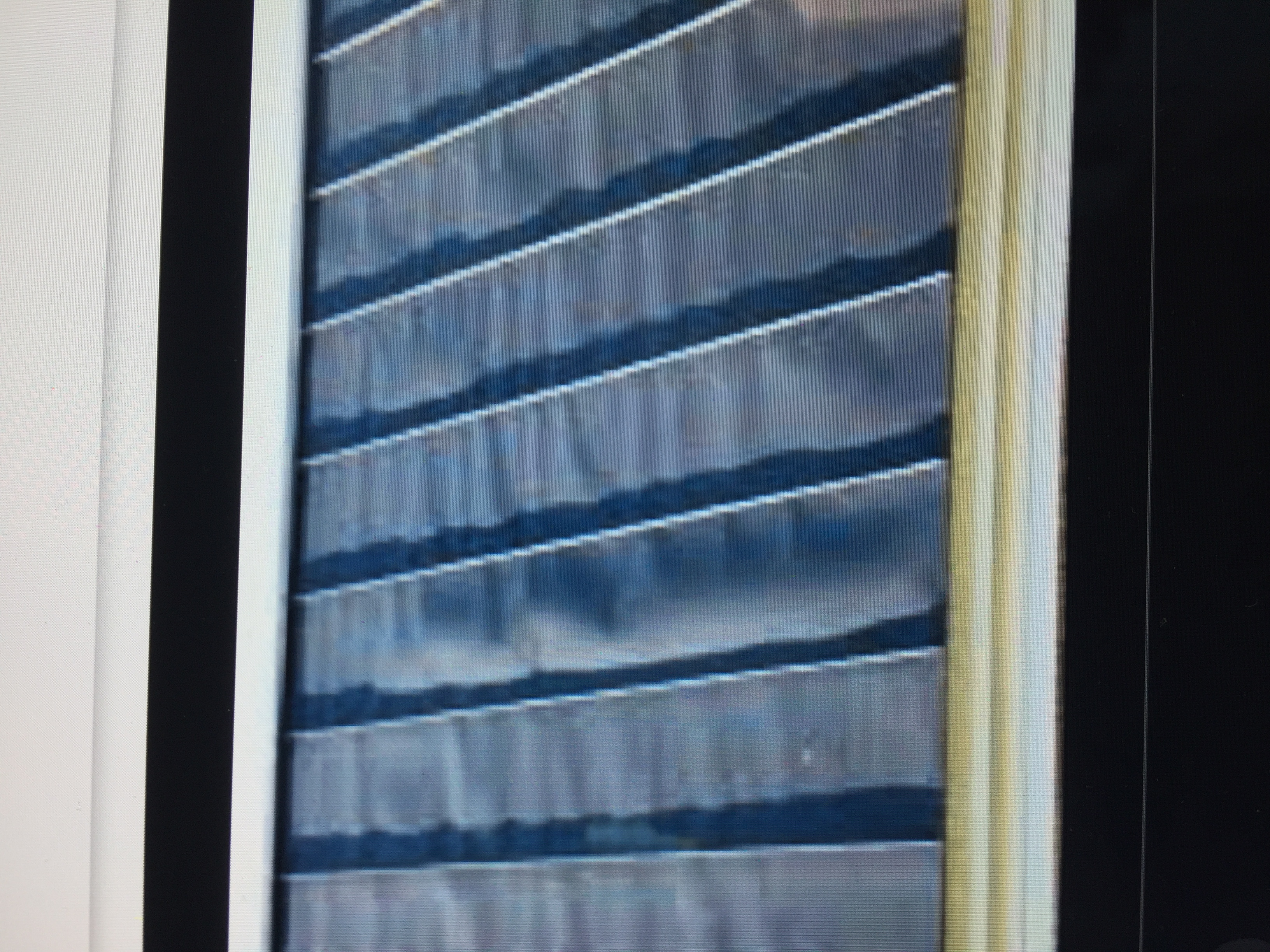

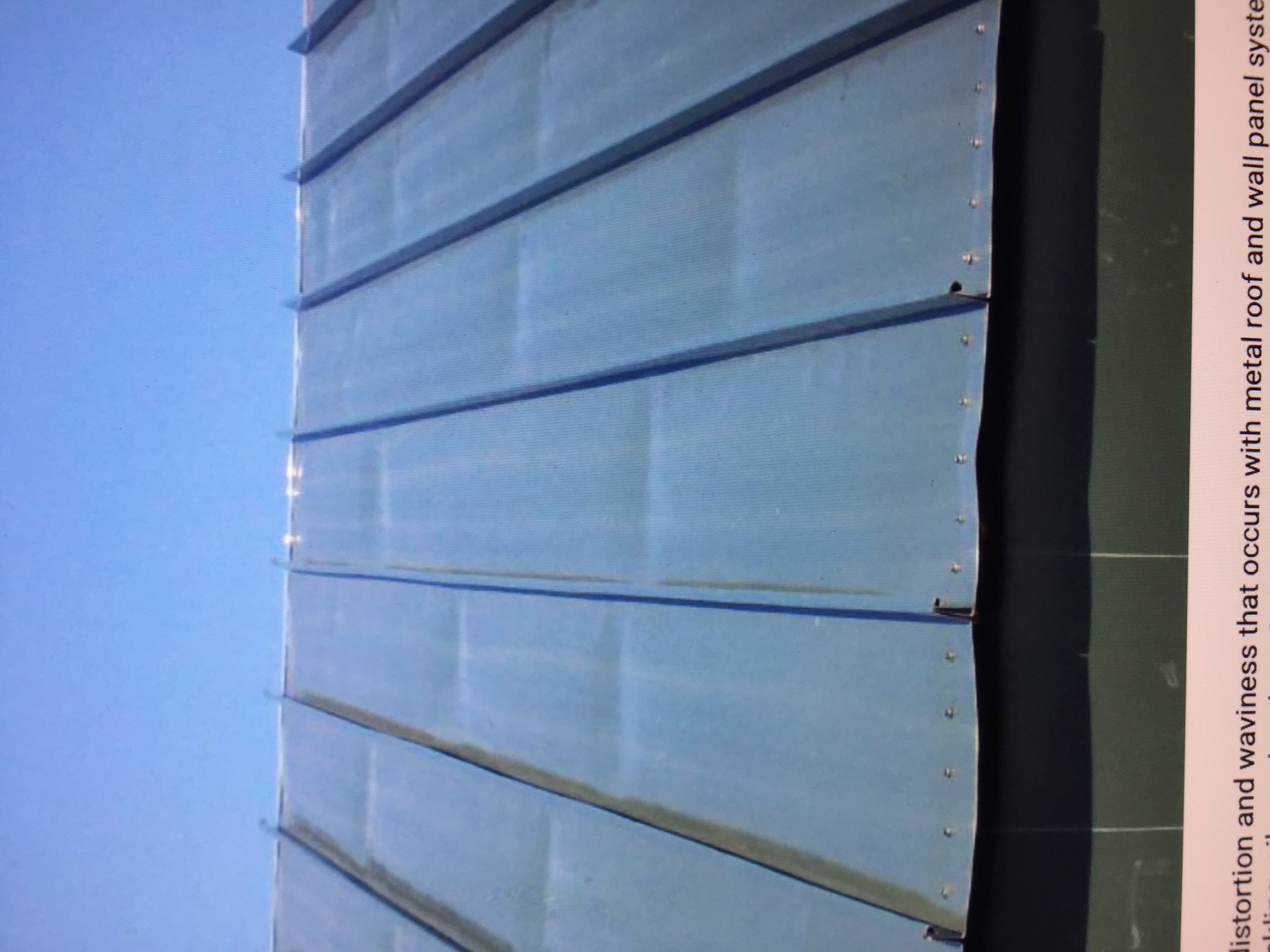

7AAA2C0F-9934-4346-8447-39A7D8B7FEFB.jpeg55F7197F-E163-4E4F-AF22-C78B1B4A19D4.jpegSlim, When I did the insulation on my Morton building I purchased rolled insulation from them. It was (I believe) 6 inches thick and it fit exactly between the posts. It was ONE piece from ceiling to floor and post to post. I then placed a plastic vapor barrier over (ceiling to floor, one big piece) then ran horizontal 2 x 4's before placing OSB on all the walls. Great insulation for the price. One problem for me, I did the insulation by myself and it gets quite heavy. For two people it would be a piece of cake and I did it when I was about 60 years old.
One of the problems from what I've read with regard to spray foam is "oil canning" where the metal roof is deformed by using spray foam directly onto the metal. See attached photos I got off the internet. If you look at the videos below when spray foam is used there is alway some kind of backing on the metal, I'm guessing to eliminate the oil canning. For additional info you can google "oil canning", also rolled insulation to use in a pole barn. Good luck, Stanley
