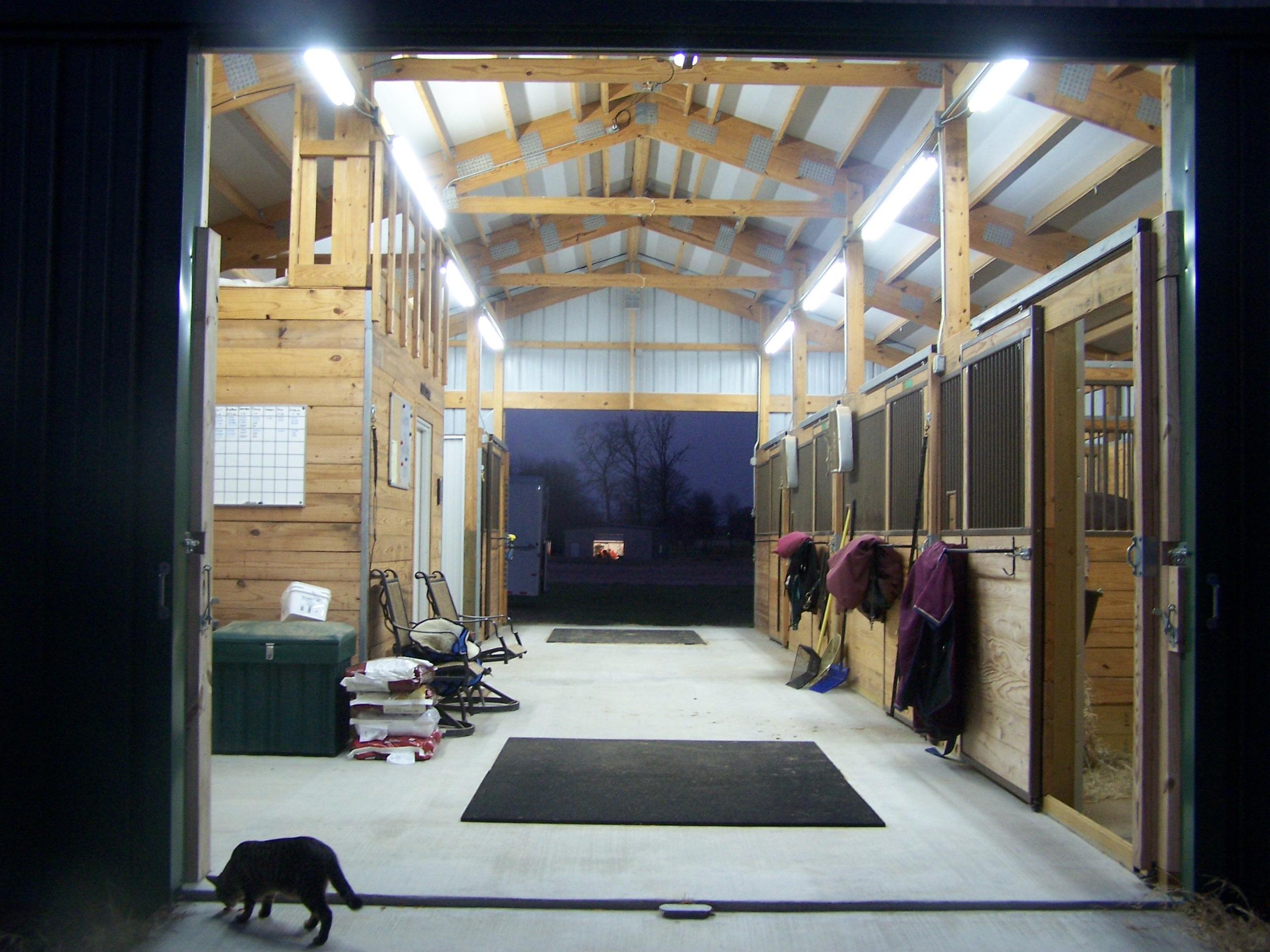

I don't know the specific brand. They are standard commercial grade 8' naked bulb fixtures from the local electrical supply house. Each uses 4 4' T8 bulbs. They are 14' off the ground.
I measured the output tonight while feeding and cleaning stalls. It varies from 85 foot candles at the ends of the aisle to 140 foot candles in the middle. I cannot tell that much difference. I used the same fixtures in the garage on 9' ceilings and got from 65 - 120 foot candles.

Depending on what you plan on doing it in the garage. If it is just parking and storage you might get by with those lights, each one would be covering a 20'X20' area. If you plan on doing any work I think you might be disappointed. I have 8 8' fluorescent fixtures in my 36'X48' stables. Each fixture has 4 T8 bulbs and covers an 12'X18' area.
That looks great Randy. Kind of looks empty too. Do you need more horses? I have too many!!!
Thanks for the kind remarks, no thanks to another horse. We have too many as well.
