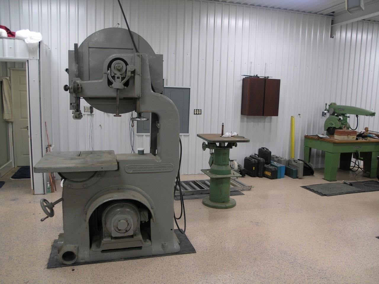

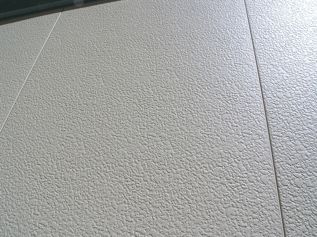

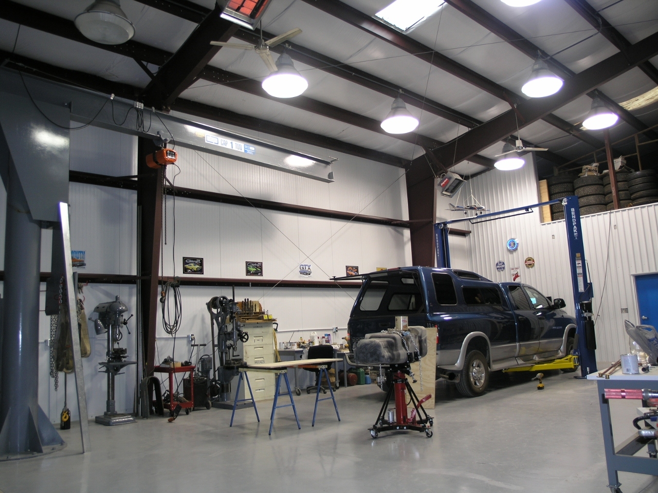

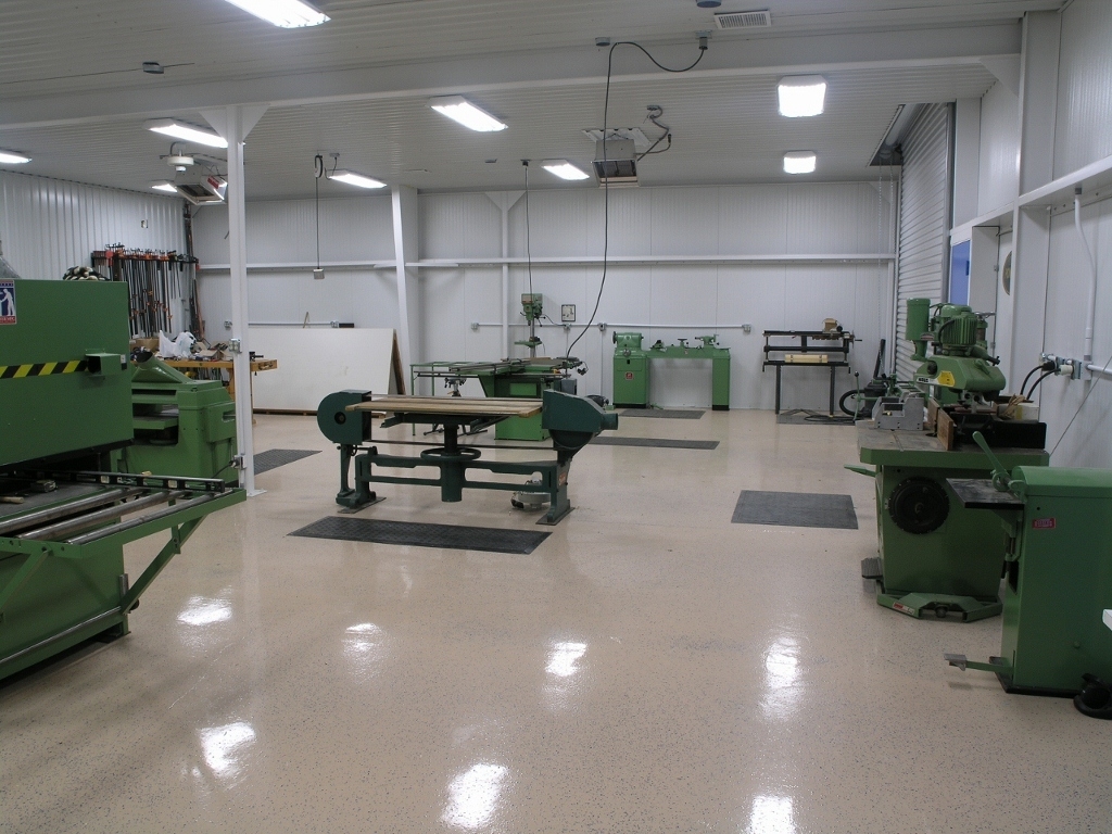

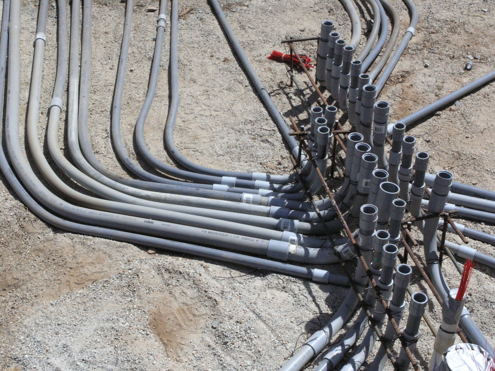

Here are some insulated panels (2.5”thick r21 foam) that can help keep you cool or warm. This is an all steel building. Six inch slab over compacted road base and drain rock. 18” thick square perimeter footing with six #4 bars and # 3 bars on 16” center in the slab. Lots of conduits with 4 three phase panels.
Almost forgot 50x128x23h.
