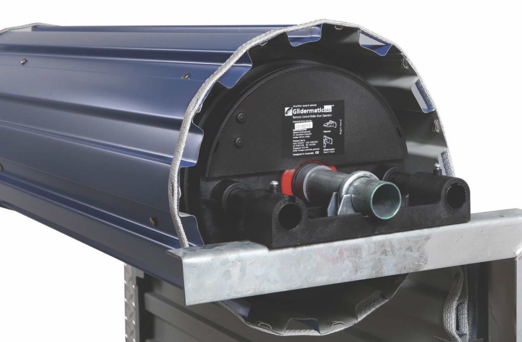

Reading this thread with interest, it got me to thinking about installing a door opener on my shop I have not had the door on there but a few months and am already thinking about putting an opener on it. But it is a 12x12 rollup door and the abundance of options are confusing. Never had a powered rollup door before.
My shops roll up door has a Gliderol roll up mechanism installed inside the drum of the door. Works smooth and fast for over 12 years now. Easy install.
